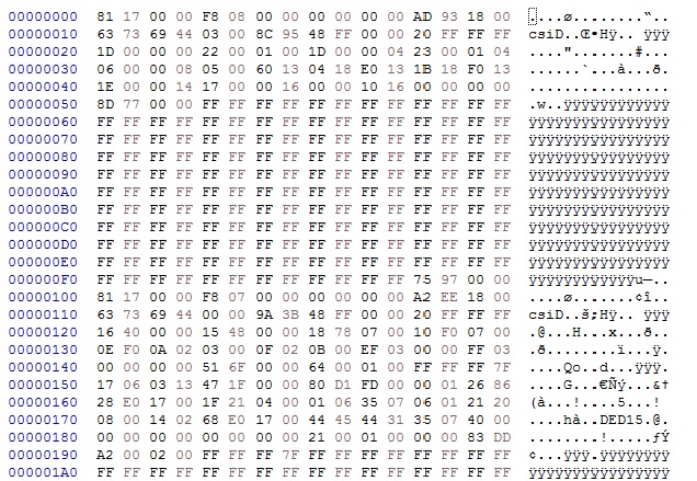

After writing the ROM i get the following error in terminal
Flash boot code Digital Signature Verification failure!
0x00000001
0x00000001
0x00000001
0x00000001
0x00000001
0x00000001
0x00000001
0x00000001
0x00000001
0x00000001
SEA5 Boot ROM 1.0 (06/01/2017)
Copyright Seagate 2017-VM000
and the drive doesnt spin.
Some more ideas please?

Did you write both patched ROMs to the correct donor PCB?

This PCB supplier states that a ROM swap should work for ...
    Model : ST2000DM008
    Board Number: 100815595
    P/N : 2FR102-020
    F/W : 0001
https://www.hdd-parts.com/21112805.html
Assuming they are correct, this would suggest that the early version of this PCB may not have a keyed MCU. Perhaps one could transfer the patient ROM to this early PCB?
HDD Surgery shows two families for the ST2000DM008-2FR102, both with F/W 0001:
https://firmware.hddsurgery.com/index.php?manufacturer=Seagate&family=Pharaoh_Oasis
https://firmware.hddsurgery.com/index.php?manufacturer=Seagate&family=V9
I wonder if one family is without a digital signature? It would be interesting to compare a V9 ROM dump against a Pharaoh_Oasis.

See this thread:
https://forum.hddguru.com/viewtopic.php?f=1&t=43332
ISTR that someone said that this PCB came with a keyed MCU and a non-keyed MCU, and it is impossible to distinguish between them visually.

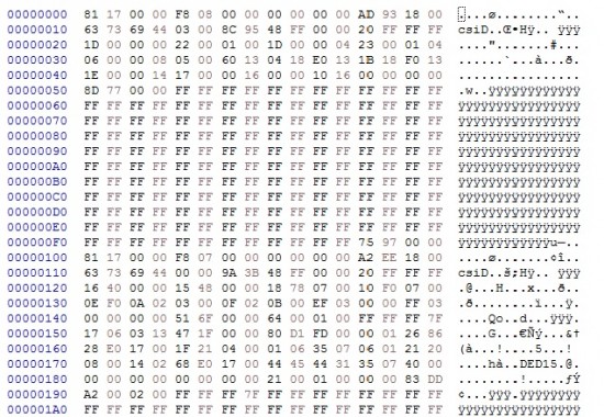

i will search donor PCB with below ROM code match
and transfer if digital signature is in Patient ROM to Donor ROM as well as SAP RAP CAP
then it will surely work.
here donor and patient PCB ROM are not match
Note; fzabkar sir if u PM your email i will send how that 4TB case solved with Patient rom, donor rom and modified rom
