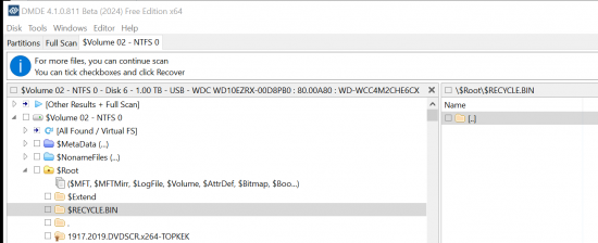

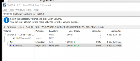

 Post subject: Re: Trying to recover new data apparently now in bad cluster
PostPosted: July 21st, 2024, 22:47
Joined: July 2nd, 2024, 21:51
Posts: 17
Location: SE USA
Aussie Don Quixote :-) @fzabkar
Correct. As a relative neophyte in this arena, I'm sure that I've confused readers and the issue several times over.
Short recap. Did not back up old desktop HDD for about 45 days. But, HDD worked fine, and so I added it as a 2nd HDD inside with the cables internal to the desktop. When it booted an alert that the drive was there popped up. I believe I answered should it be initialized (thinking WIN10 needed to add it to "This PC" file directory. That apparently made my active directories/files NON-deleted i.e they "disappeared".
Have followed instructions provided here and from others. And the first issue/app fixed the partition but the HDD is shown as a clean new drive (shown as I: in snips provided). When I used all of the RECOVERY recommended apps, all I get is the 500 or 600 GB of deleted formatted files that were on the computer when the computer was "cleaned" and given to me. None of the NONdeleted files show up. Have rund the DMDE free program and did not see these files.
I ran DMDE per this post on reddit. There was not a "lost" partition. i.e. no partition -- it just vanished which is cautioned in this article not to proceed. I think the initialized and then my attempt using other recovery software has made this NOT easy or straight forward. :-(
snip of dmde below
So, I just tried another EASEUS data recovery and went thru all file folders recovered and NONE were the NONdeleted.

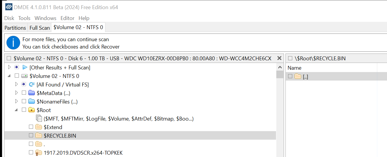

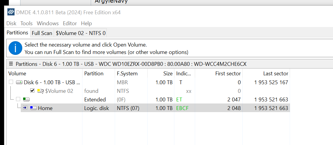

PostPosted: July 21st, 2024, 22:51
Posts: 17
Location: SE USA
Snip of DMDE
PostPosted: July 22nd, 2024, 3:45
Posts: 17228
When Windows prompts you to initialise a drive, it means that it cannot find valid partition metadata. Moreover, your data recovery tools have been unable to find any trace of your files. One common explanation is that the drive has been moved from an encrypted environment, eg a My Book external enclosure, to an internal, unencrypted desktop environment. However, this simple explanation appears to be inconsistent with the fact that you can still find unencrypted files from your son's previous installation.
