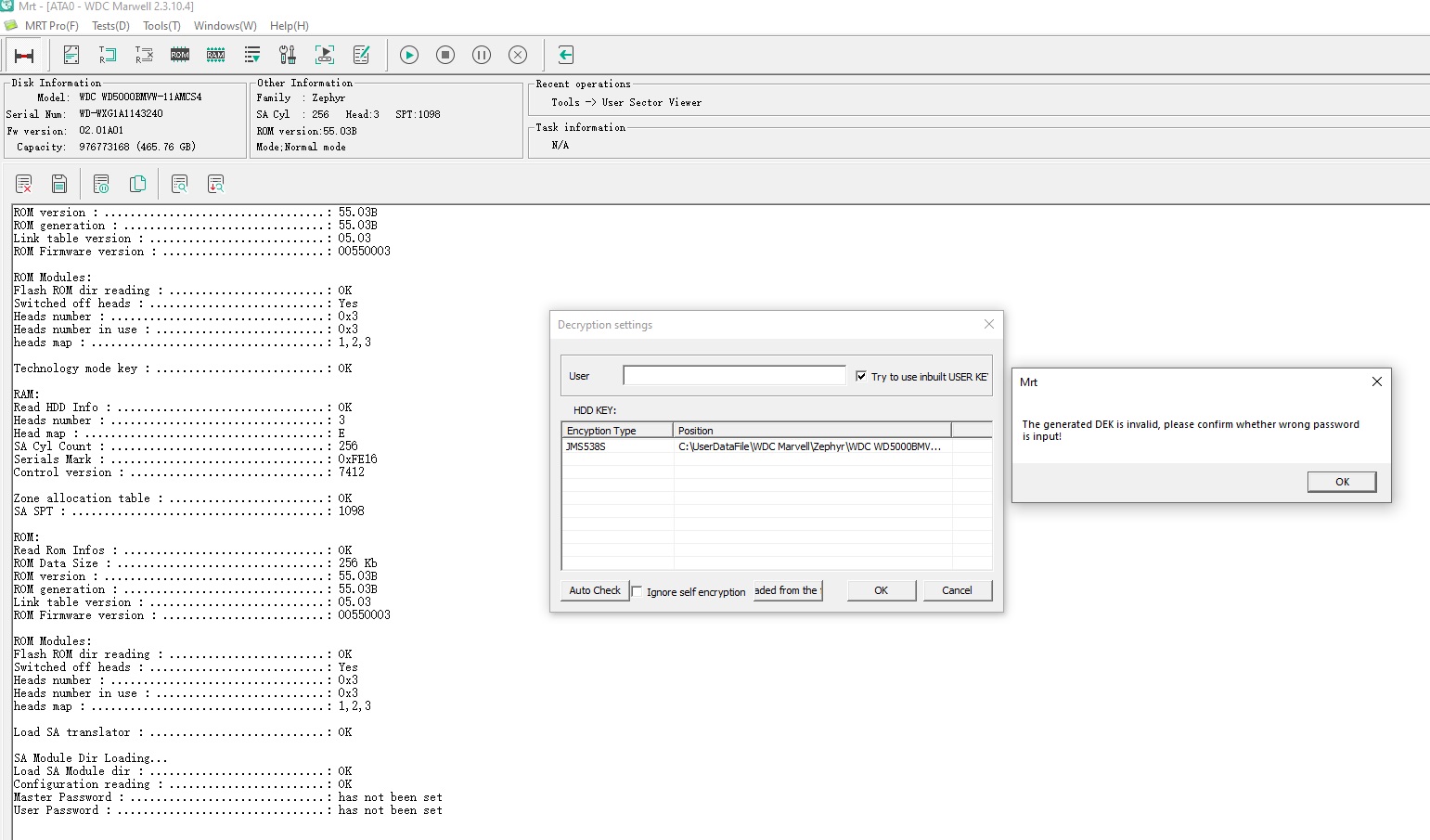

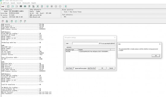

Thanks for your response really appreciated, Unfortunately still getting the same error....

I kept testing and noticed that T2 cannot be accessed, I tried both Obtain by command and From SA, when I try to open T2 editor an error come up: "Get Data Failed"
What's tested so far:
Tried Solve Slow Responding.

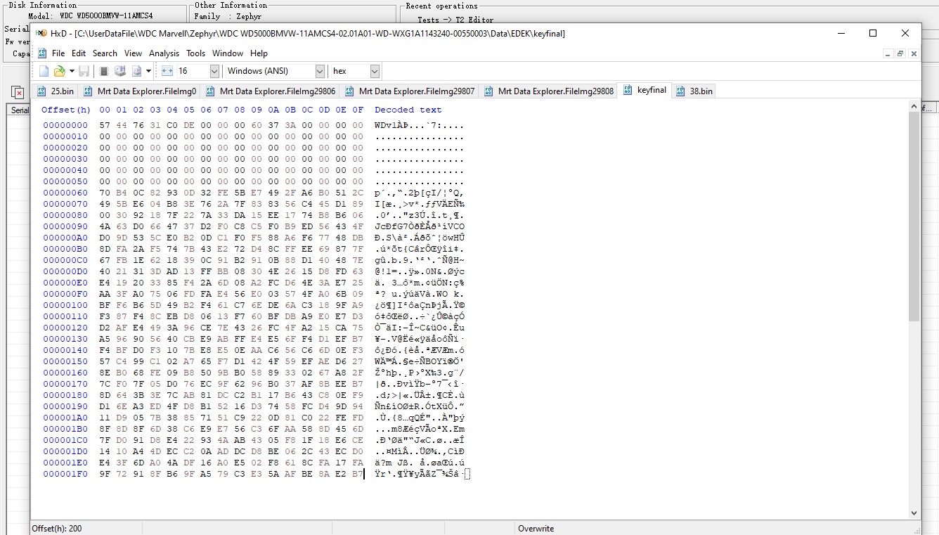

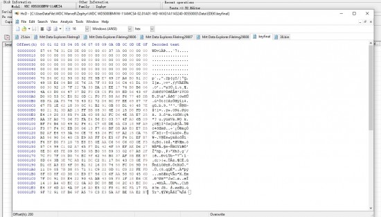

Managed to extract the key from the last 66K sectors (see attached photo).
extracted key from module 25.
tried to swap heads twice still same issue.
Closed SED lock in EDIT HDD ID.

decryption has nothing to do with initing the drive, as it is done it MRT sw if you import the key. So as long as you have LBA access you should be able to decrypt it, except:
- the key is indeed corrupt (I have seen such case, client did not set up pwd and drive started asking pw out of the blue, i think there were discussions about such problem here on this forum like 10 yrs ago at least)
- I haven't met a zephyr with SED turned on OOB but it can be turned on, then the drive uses internal crypt engine with SED key stored in its keystore (D00x, 012x).
however, SED looks differently by looking at the data, so i would exclude this option.
on the first 2 pics in your first post it is clearly visible that the encrypted sector is an MBR, so translation is just fine, and anyway, this encryption is not LBA dependant, being simple ECB.
Pc3k also asks for a pwd when feeding it your JMS key blob, so it is likely the cuprit.
