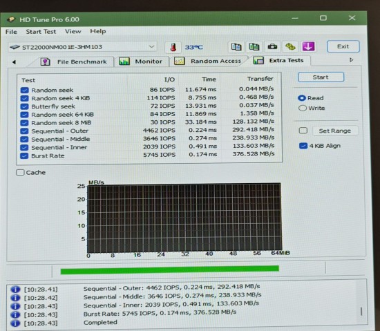

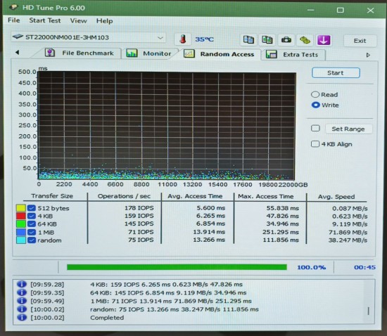

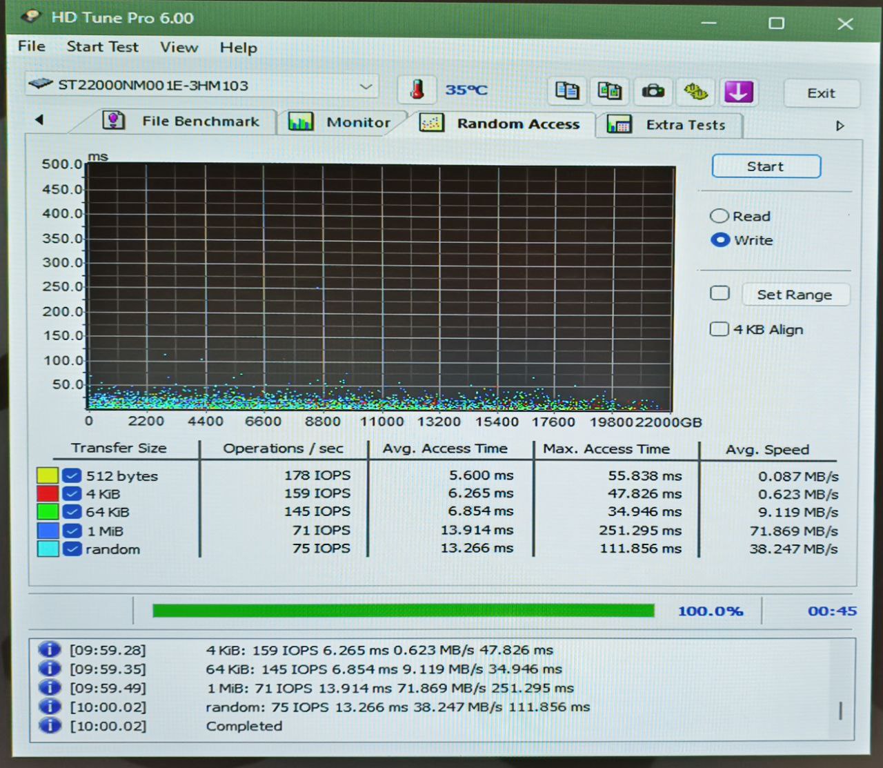

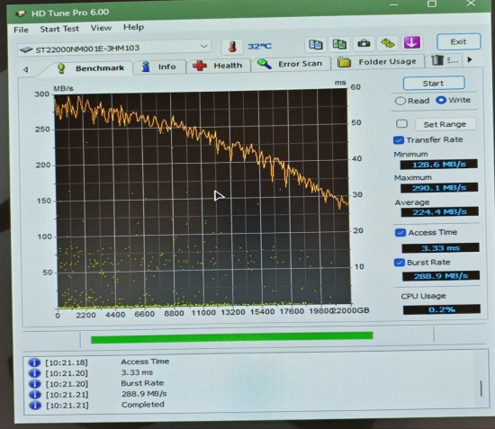

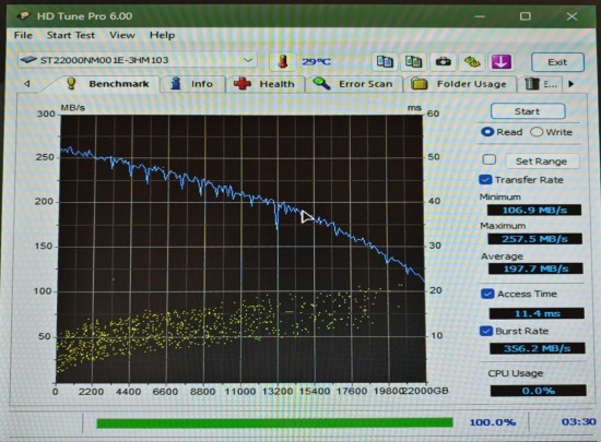

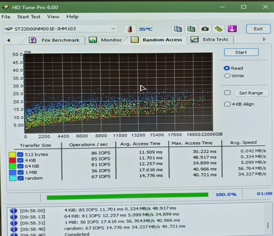

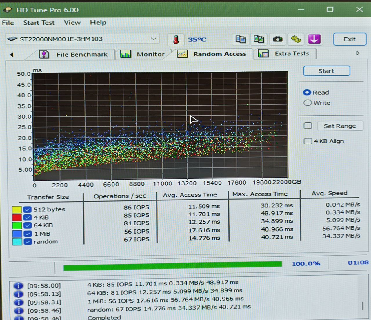

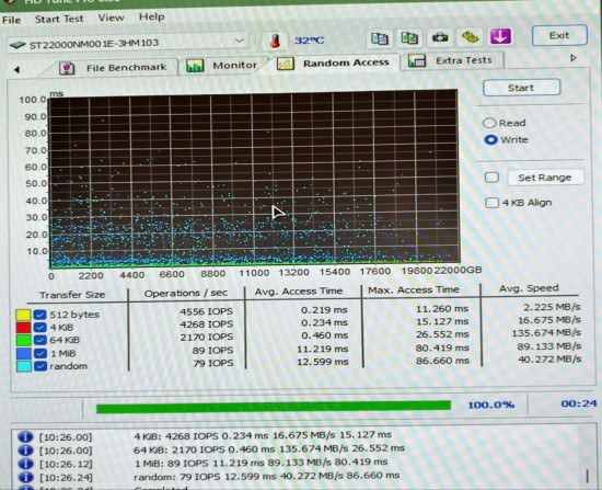

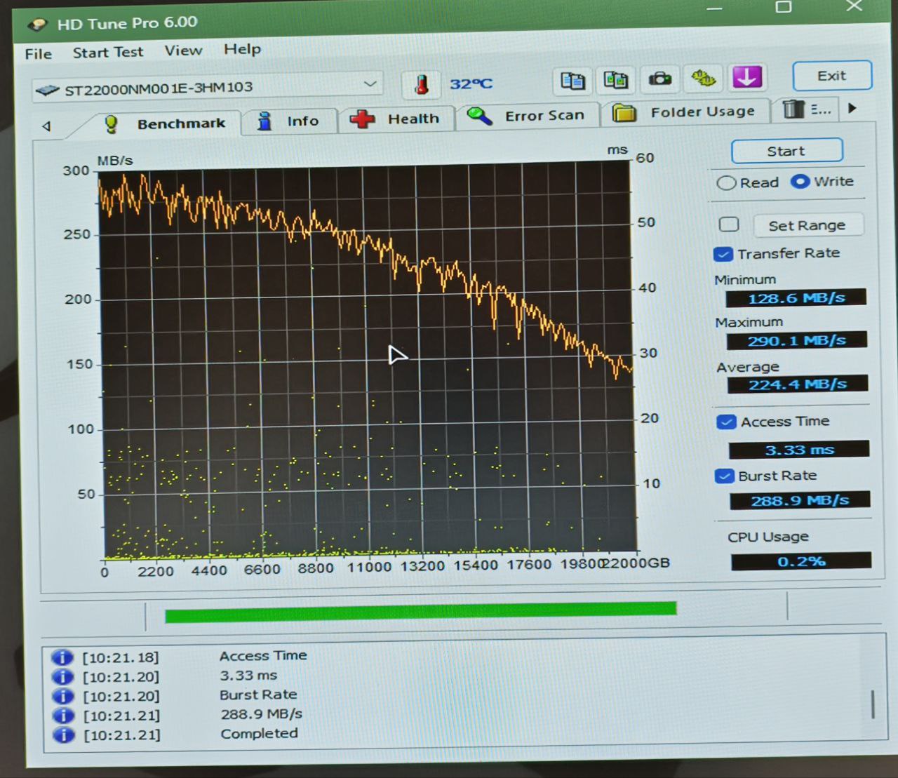

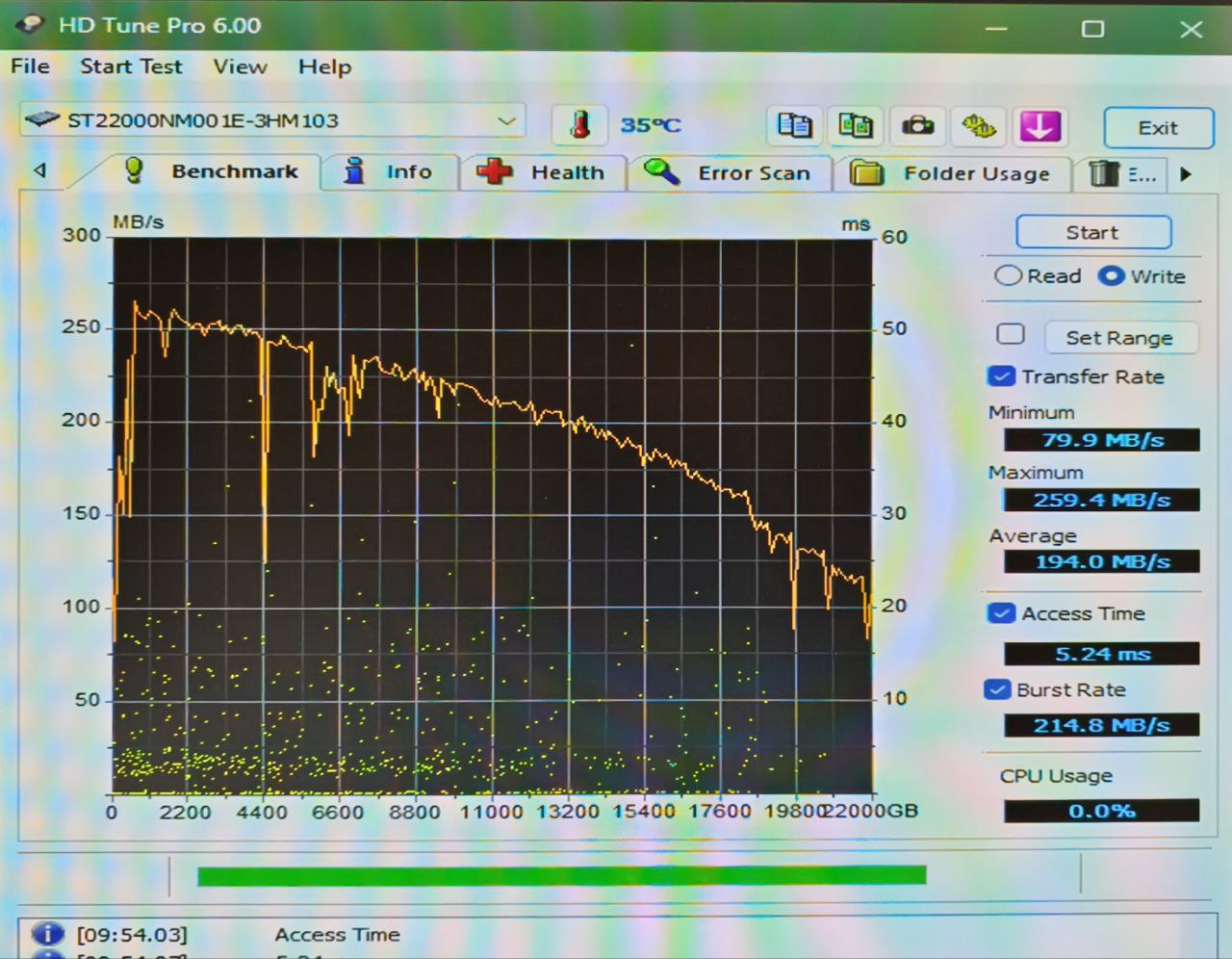

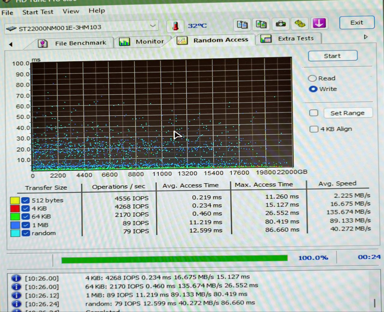

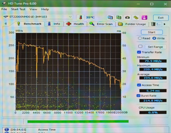

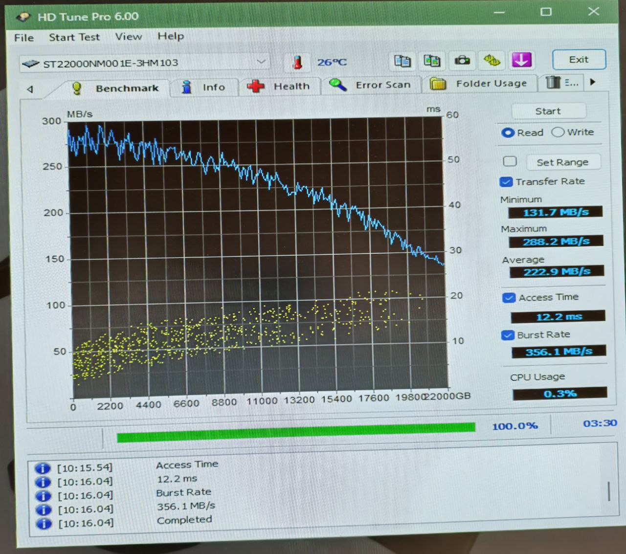

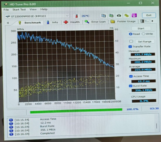

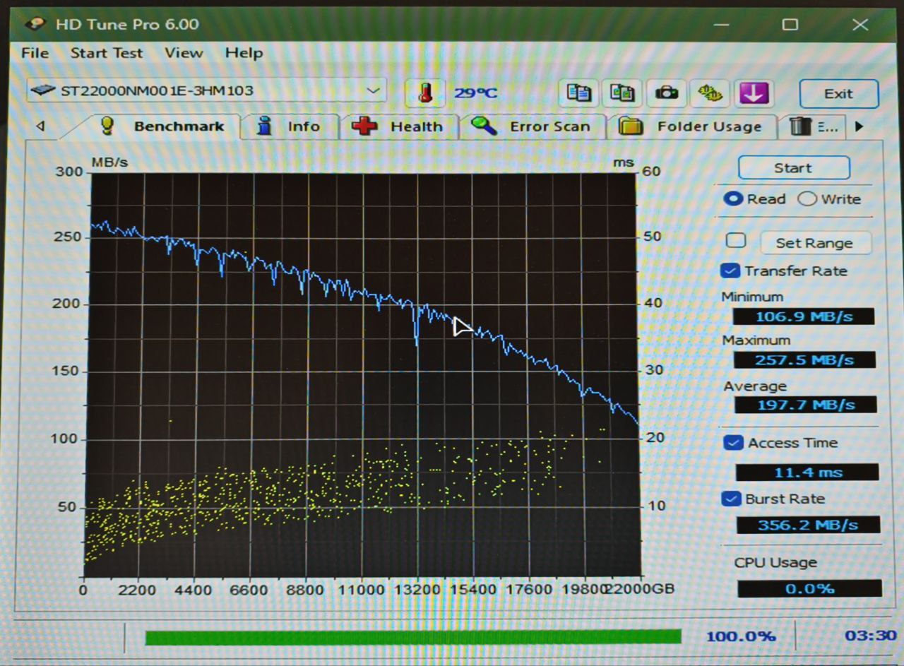

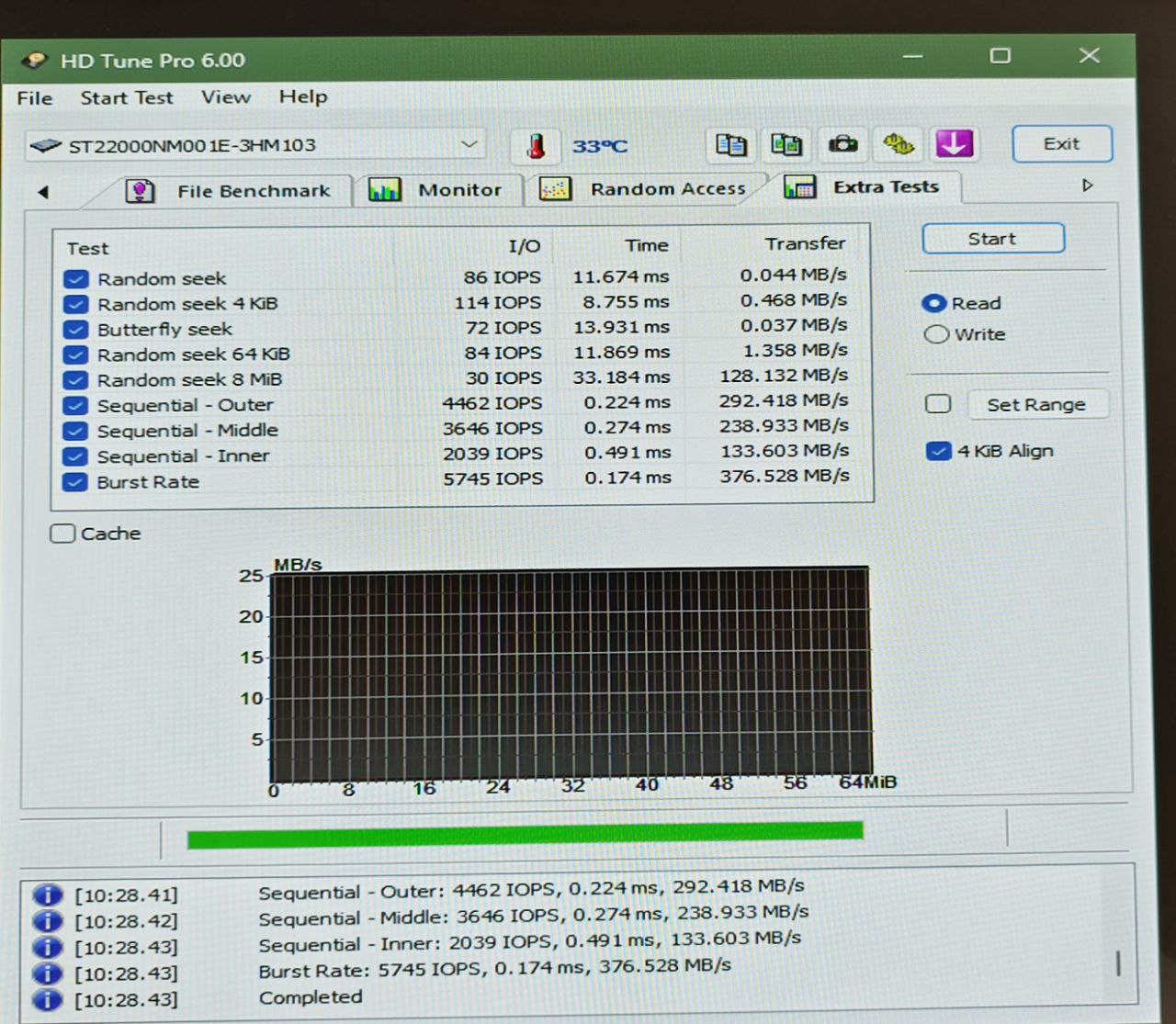

I added some HDD tune Results.
File comment: fake write
File comment: fake read
File comment: orig write
File comment: orig read
 Post subject: Re: Possible Seagate X22 ST22000NM001E Fake Drive
PostPosted: December 10th, 2025, 4:23
Posts: 17342
If you want to see the individual heads, you need to short-stroke the drive. Set the range from 0 to 10GB, say. Adjust this range until you see 40 heads or more in the graph. Use the screenshots at the HDD Oracle as your guide.
