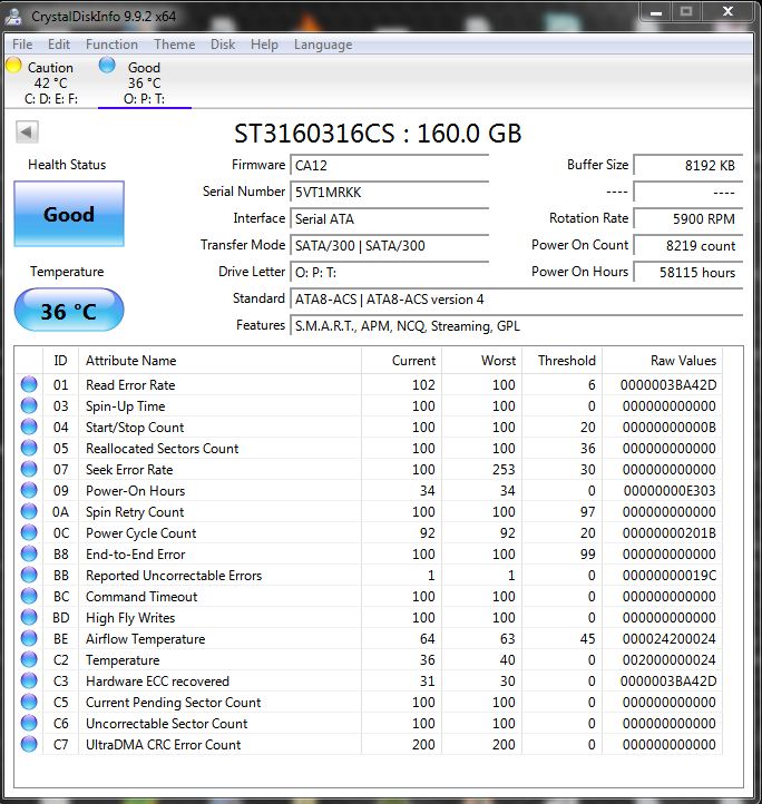

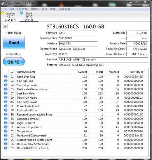

wanted to document this -summary of my journey almost 10 days
CP2102/CH341A to patch the ROM ,f3romexplorer ,python script of fzabkar sir for crc count,shorting pins sata ide usb converter --- PSATA (Safe Mode) back into full HSATA over the USB bridge, the drive came alive with all partitions and data intact smooth as it was before.
checked with 100mb rar file copy cut paste . all fine .
SMART initially flagged 9 pending sectors - used ttl v4 to see those strings , then converted them to lba to read remap erase through victoria - windows 7 64bit ult . if want data intact and dont have much space to save the whole drive ---
but first had to see which files are related to those exact bad sector with 1 block size .
used fsutil cmd prompt in windows , copied only that file to pendrive , shift del from drive , then remapped /erased the sector , then copied back the files to thier original place with data speed upto 18-23MBPS in usb2.0 . remapping erasing permission denied - so have to remove drive letter, swtich off mbr , disbale drive , enable drive again , then try first erase then remap .
bad clus will come if the sector was not occupied by any files . pending sector will be shot down one by one the moment they get remap or erased . and i got good in crystal diskinfo/disgenious yay! :o :shock: :D
forgot this - last step for me would be to desolder those thin transformer wires from rom legs in drive pcb off which was used for attaching to ch431a pro for flashing atleast 7-10 times these days . learnt a lots , right wrong all ..thank you everyone .
