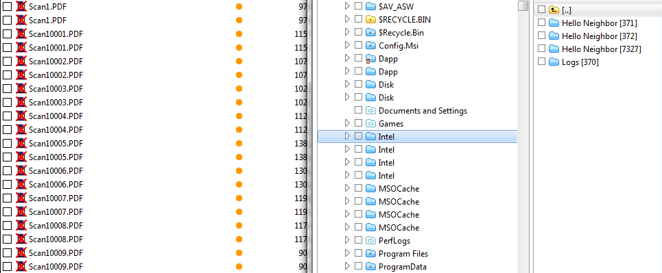

I have now finished the cloning process. Following the advice, I switched from Phase 2 to Phase 3, but the situation was similar—processing the remaining 1.5% of the disk (approx. 10 GB of data) showed a projection of 2 to 3 days. I also monitored the size of the cloned disk image, and even though the processing of the remaining data went from 3% down to 2% and finally to 1.5%, the size of the kopdiska.bin file no longer changed (increased)—see the attached Fig. I assume that this remaining ~10 GB might just be unallocated/empty space on the disk. If necessary, those 10 GB could probably be cloned separately.
So, I then installed the DMDE 4.4.4 free version on my primary Windows PC and connected the USB drive containing the cloned disk. I ran a Full Scan, and the results are shown in the pictures. One of the partitions looks like it should be completely fine, as all the original files are visible as they were. For the other partition, DMDE sorted the files by document type, images, etc. I checked the JPEG and TIFF images, and it looks like I can preview most of them; some don't open, and some open only halfway. Overall, if it stays like this, it will already be very good—I've already found some of the key images.
However, I'm not sure how to best proceed from here. I think there was a 'Recovery' button which I haven't tried yet; what was shown in the pictures was just the result of the Full Scan command. Will the Recovery function try to put things back into their original folder structure? Well, even if the images end up being listed randomly one after another, it won't be a big deal.
By the way, the original damaged drive survived—between Phase 2 and 3 the PC was running at a slightly higher load, but everything went fine. To get those last 10 GB, I probably would have had to push it for another 2 to 3 days, and it's questionable whether it would have had any effect on the data, because as mentioned, the .bin clone file was no longer growing with the processed data amount.
So it looks like it wasn't all in vain—thanks ora for all the guidance!

The NTFS metadata for $NoName 02 are damaged,so DMDE is resorting to file carving.
If you open the .bin image with 7Zip, are you able to extract the good NTFS volume? You may need to change the .bin extension to .img.
No, this is the beginning of the hard drive - there will always be real data here. The only exception is when there was a deliberate attempt to erase the hard drive. The problem that you encountered in DMDE was precisely due to the fact that parts of the file system metadata were not copied, so the damaged partition does not open, and you see only those files that were found by searching for file signatures, but there are no folders and files. Files on the hard drive are not always written continuously, and information about where parts of the files are stored is recorded in the file system data, so in order to successfully copy those images that have been partially opened, you will have to continue copying the hard drive.
You can also try R-studio and scan the damaged partition in the image file. R-Studio usually copes somewhat better in such cases. Do not scan the entire image, this is a waste of time, and in DMDE this is also a source of problems, because this program mixes everything it finds on all partitions into one pile, both folders and all files.
But as soon as you copy the hard drive completely, DMDE will be able to open the partition without a full scan at all, and most files, if not all, can be recovered without errors.

Yes, things are moving in the right direction. I've now done some research on these data recovery programs; DMDE already found the vast majority of things last time—true, the files were randomly named, but hey, the data is here! Then I thought, what the hell, let's try R-Studio as well. Total shock, the code recovers things with proper structure, you wouldn't believe it. At first, I checked everything, and it even started recovering old files from the Recycle Bin from years ago that I had deleted long ago. The estimated recovery time for everything, including Program Files, Windows, Temps, etc., was around 5 days. Then I stopped it and, obviously, selected only experimental and personal data (the rest is system data), and now the process is running (see attached images).
So, fantastic applications: OpenSuperClone (an additional setting: Skip Threshold set to 12000ms helped a lot in my case), DMDE is also super code, and R-Studio looks like it will provide the finishing touch.
I also tried 7-Zip as advised, and it really does separate the partitions (attached image), but R-Studio is a truly powerful tool—you just run a full disk scan and select what you want it to recover (DMDE probably has something similar).
DMDE can do this too, it's just that it's a very specific program with a focus on professional data recovery and it has a unique, confusing interface, not like regular file recovery programs.
To see the folders and files in it, there are two ways: open the partition in the "partitions" tab, and run a full scan of the partition if the necessary files and folders are not found. Or scan the entire image, after which the "full scan" tab will appear and in it you need to open "NTFS 2", which was offered in the main results. In any of the methods, after completing the process, a "more/less results" button will appear in the tab with the open partition at the bottom left. You click on it, click on the "++" button next to the green stripe once and click OK, after which a miracle will also happen. R-Studio does not have such settings, and after scanning it will immediately show everything it found.
You fell into the first trap. The program will actually show "files" that were deleted many years ago, but these files are no longer there. These were some fragments of old file records, and the place to which the file record points, and where the deleted file once was, has already been overwritten a hundred times with new data. Try to restore several of these files, none of them will open.
And there’s also a second trap waiting for you, which you also fell into when the program reported that the files had the same names and asked what to do. Whether in DMDE or R-Studio, look at what is in the folders and an interesting surprise awaits you - the files are repeated several times. Although this supposedly cannot be true - you cannot save a file with the same name several times in the same folder, this is absurd. However, for some reason this happened. And this happens because the computer in the background is engaged in various optimizations of the file system and data on the disk (organizing, defragmentation) and every time something is done with a file, new file entries appear. This also happens when you open a file, edit it, and then save it.
It may seem that this problem can be ignored, but no, it cannot. Recover all the duplicates of one file, just let the program automatically rename them rather than overwrite them, and you will see that one of these duplicates opens as expected, while the others either open partially or, most often, are completely damaged. Now you have a new entertainment: manually sort through the recovered data, deleting damaged files. And there may be 10-12 duplicates, this usually happens with documents. In R-Studio there are yellow and green dots after the file name, which can tell you what to choose, and in DMDE this is an icon of torn paper and paper with a green arrow in the upper left corner to the left of the file name. But under no circumstances should these tips be blindly trusted.
You can save yourself from this problem, and also save these programs from having to scan the entire partition and restore the damaged file system from parts of the secondary data - simply by copying the missing data. Windows will not be able to open or restore a relatively intact but damaged file system, but for these programs this situation is not a problem at all. But when a piece of the file system simply does not exist, then this is a difficult task even for these programs.
What to do is also up to you, if there is not much important data left and it can be parsed manually, then you can go this way.
There is a third trap, which you also saw - damaged files. In camera photos, there is a thumbnail image at the very beginning of the file. In Windows Explorer you will open a folder with photos, these thumbnails will be read, and it may seem as if everything has been restored. But as soon as you open the photo, a surprise may happen - half of the image is missing. It’s the same with archives - they can open, but unpacking will fail. It's the same with videos and music - they can play, but not completely. Be sure to check the recovered data, since these programs do not check the integrity of the files. Don't rush to restore your data, delete the image file, or throw away your old hard drive.
And there remains a fourth trap - parts of some files may be among those uncopied 10 gigabytes. These files can only be detected using virtual mode in opensuperclone and using DMDE there. When working under Windows, these files will be restored without errors with empty data inside. This problem is solved in the same way as the previous one - copy the remaining data.
P.S. DMDE also has a surprise in the file recovery window - there you can choose whether to recover deleted or non-deleted files. What the program considers deleted can be understood by the trash can icon next to the name of the file or folder. If all the files in a folder are selected, but in this window, for example, deleted files are not marked, and there were such files in the folder, you will be in for an unpleasant surprise - supposedly everything has been restored, but not everything, and you may miss it.
You need to get used to this program and have experience using it, it is truly unique.
