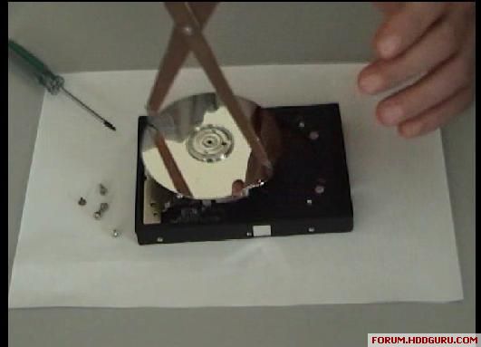

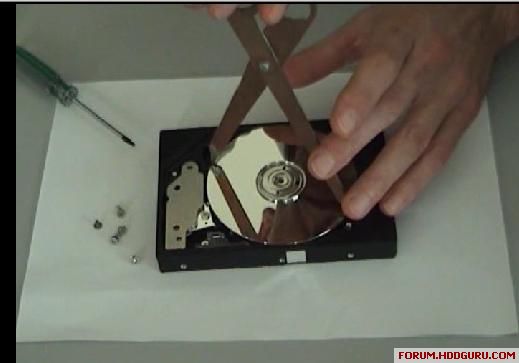

Steel i think would be the best tool for the platter changing tool from salvation data is also made of steel and tool i use also made of steel .
This is the tool i use :
 Post subject:
PostPosted: April 17th, 2007, 18:49
Posts: 2288
Location: In ur HDD !
It looks easy but its not because head replacement needs alot of practise to align heads in proper position so they should be of equal distances from the platter . here is the video of the above picture :

From your picture, it's matxtor 2B.How about 6E?
and it's only prcatical for one platter. what if multi-platter HDD?
Well. I think ,we can use one hand to exchange the platter.
SalvationDATA--Profesionnal Hard drive solution Provider. MSN: sales.laura@salvationdata.com
 Post subject:
PostPosted: April 18th, 2007, 15:12
Posts: 2288
yes u r right i agree with u can be used for single platter drives in most of the cases of platter exchange single platter is exchanged for multi platter drives heads are exchanged .
