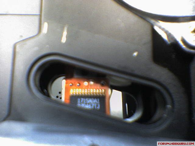

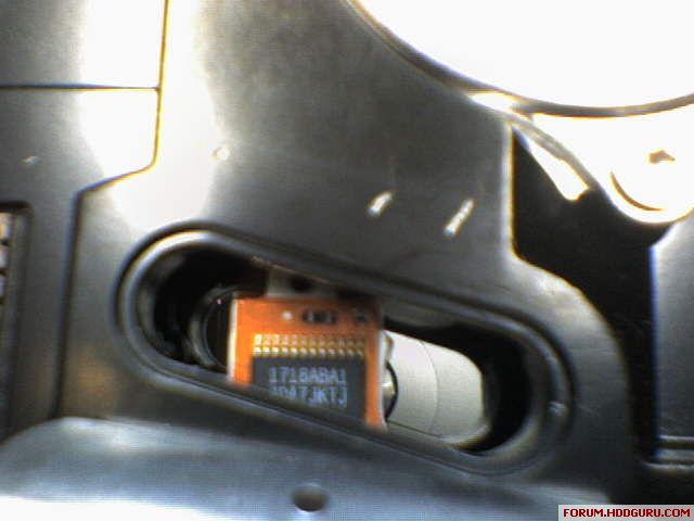

Not sure what they're all for, but the 3rd digit is the one too watch out for when doing head swaps.
I opened several old Maxtor drives, all the ones with one type of 3rd digit had the same type of Preamp chip.

Maxtors - anyone know what the letters in the four letter code reference?
for ex:
K, M, B, D
or
N, M, B, A and so on..
open module 83# use pc3000 :wink:

Ok, thats some good stuff.
But what matches up with what is printed on the lable?
I looked at 2 drives with the code K, G, B, A and nothing in #83 had a "K"

First letter "K" is the Preamp type second letter "M" is the head type .
 Post subject:
PostPosted: June 26th, 2007, 15:41
Rameez..
How sure are you about that?
I opened up several 5409U4 drives looking for a donor, and ones with same 1st two digits had completely different preamp chips.

pcimage,
I read this in acelab manual ,
 Post subject:
PostPosted: July 1st, 2007, 8:37
rameez,
Hi, yes I read that too. Doesn't mean it's true though ;-)
Anybody else shed some more light on this?

THis letters wich said´s need for matching MHA to match letters its not always true
:( I had a Maxtor 2F04L0xxxx patient and search for donnor , bought the hdd donnor, same model, same CODE, SAME LETTERS and when arrive and check lift up the sitcker, the preamplifier was different :(
 Post subject:
PostPosted: July 3rd, 2007, 13:35
Posts: 2288
Location: In ur HDD !
that is strange .
 Post subject:
PostPosted: July 3rd, 2007, 23:30
Posts: 1517
Location: Mexico
yes its true check it
Same Model 2F04L0 Same letters code but preamplifier was different :(
