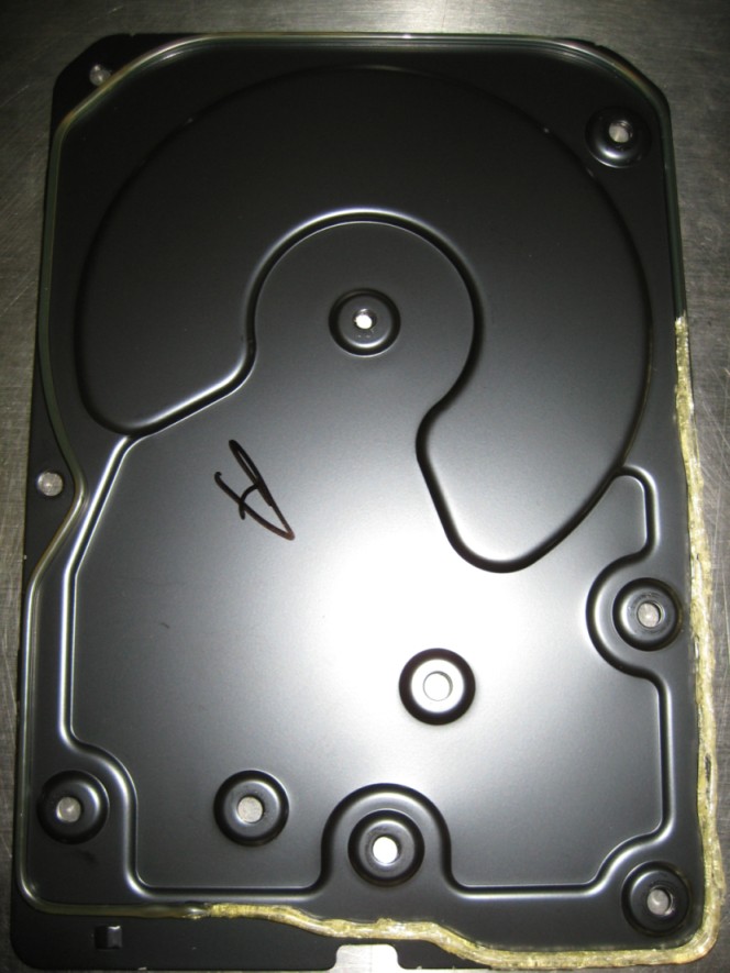

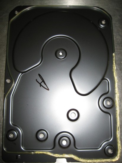

We were the first to open it and this is what we saw. I'm guessing some kind of external contamination made the seal fail. I put the "A" there.

Can you post a closer pic of broken seal? Any 'uncommon' smell? This case makes me curious...
 Post subject: Re: WD5000KS clicking noise
PostPosted: November 4th, 2008, 11:50
Posts: 3577
Location: Chicago
acetone or some other agressive solvents vapors could make that. And rubber should be sticky after that
IMHO
but it has nothing to do with clicking :)

Any sort of internal smoking or burning would have left scorch or smoke marks on the lid.
That seal does look dodgy to me

Q: Can you post a closer pic of broken seal? Any 'uncommon' smell? This case makes me curious...
A: If enough people want a closer look I can do that but would need to take it apart again.
Q: acetone or some other agressive solvents vapors could make that. And rubber should be sticky after that
IMHO but it has nothing to do with clicking
A: Seal is not sticky or anything out of the ordinary. Its feels like something dried it out. I believe what ever caused the seal to fail also got inside the drive and harmed the platters. The failed drives heads worked in a donor drive.
Q: Any sort of internal smoking or burning would have left scorch or smoke marks on the lid.
A: Heads worked in another drive and nothing looked burned or had a smell.
Q: P.s. Always check your PCB is working fine before doing anything with the heads. Even try ROM swaps etc. can save you a whole heap of trouble in the future.
A: pcb was tested against a known good drive and found to be good.
