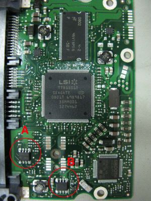

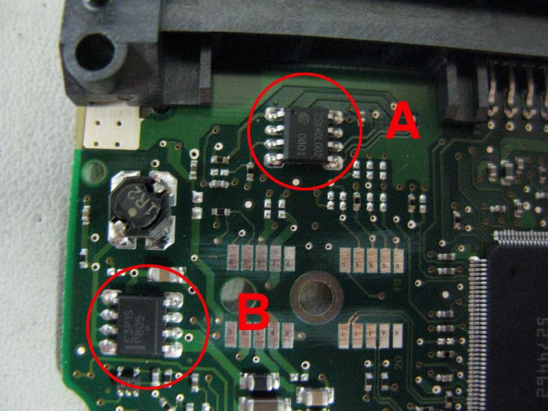

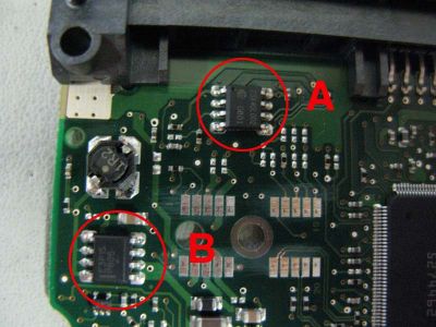

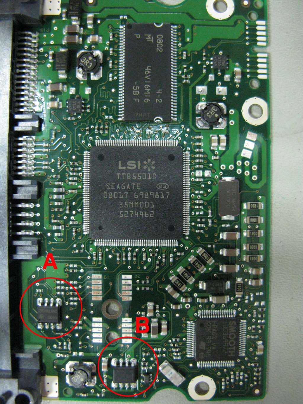

Hi Guys could you please point to me which is ROM? thank you

Well, it's not B.

Thanks Rchadwick.
