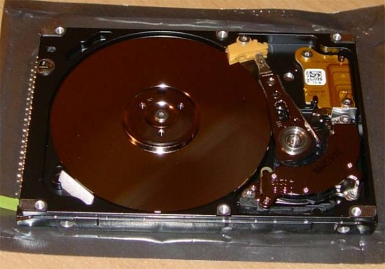

Hi
I have got similar problem, but mine disk is not recognizable by windows. What to start with now? Once i started to download the file from the disk but after a while it went dead.

 Post subject: Re: Dying Seagate Momentus ST94019A - need data
PostPosted: November 29th, 2008, 12:35
Joined: October 31st, 2008, 18:40
So, the problem is, it sounds like it he would like to start, but after few seconds it doesn't do anything. I have opened the disk and the heads are in place and I can easly turn around platter.
PostPosted: November 29th, 2008, 18:49
Posts: 3235
Location: USA
platters never spin? try pcb swap if you can rotate them freely manually.
