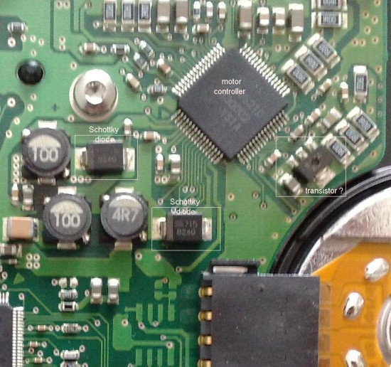

And that would be an SDRAM chip then.
 Post subject: Re: Matching PCB for HD501LJ T166
PostPosted: August 31st, 2010, 20:42
Posts: 17251
The "dark spot" is unclear. I don't know what to make of it.
In any case, measure the resistances of the four small components near the bottom LH corner of the Samsung SDRAM. Set your digital multimeter on the 200 ohms range.
The part marked "LE" is the 12V TVS diode. The component above it is the 5V TVS diode.
The component marked "125F" is a polyswitch. It should measure zero ohms.
The part marked "000" is a zero ohm link.

There also appears to be a damaged component (transistor ?) between the motor controller IC and the motor, at about 11 o'clock.

OK, thanks for your input so far.
Got out my old meter, 000 measures zero, so does 125F.
LE measures 7.2Ohms, both ways.
The one above is open circuit both ways.
I looked over the rest of the board with a 14x magnifier, but don't see anything obviously smoked. Even the dark spot on the SDRAM just looks like a dirty smudge, rather than overheating.

The 12V TVS diode appears to be OK. However, ISTM that something is loading the 12V supply. I suspect a fault in the vicinity of the motor controller chip.
Test the transistor and Schottky diodes in the photo clip.

OK i finally managed to get my meter back on this.
The diode top left measures 197 Ohm one way, 1.7K Ohm the other.
The diode bottom right measures 90 Ohm and 145 Ohm.
I don't know how to test the transistor.
I usually fix mechanical things, not wiggly things.

Sorry, I can't help you.
The diodes are probably OK, but it's hard to be certain without knowing what's connected to them. I think the "hole" on the transistor may in fact be a mould mark, but once again I'm not sure.

Thanks for your help anyway. I think as you say the "hole" in the transistor is a mould mark. When I used the x14 mag it has very neat edges and is very round.
