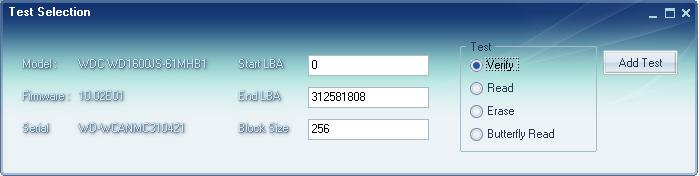

I have another, asking of programa ¿What does it mean? Block size: The number of sector of LBA, or the size of sector, in the program show "256" ¿half of size sector? 256 bytes?

Throw. Or use for unimportant data. Too many bad sector remaps.
How many times do we have to repeat to leave windows programs alone when there is a problem with hard disk? When the drive is good, windows progs are okay. But when it is bad, you dont want to complicate the matters with controller drivers, OS bugs, etc.
