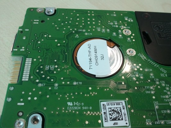

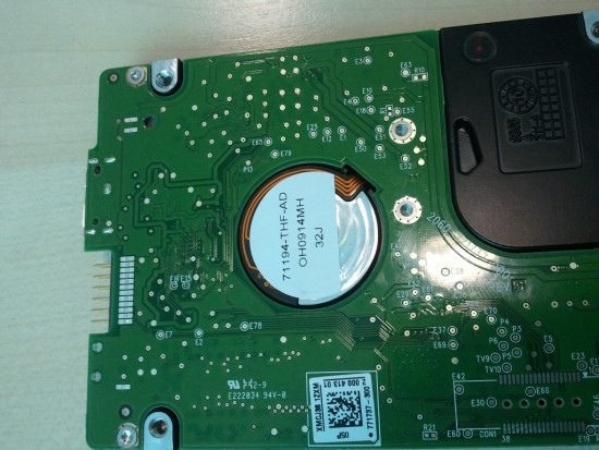

Hi All,
New on here, got an issue with a WD10TMVW, it is not recognised in my computer, but shows up elsewhere (device and printers). The issue happened after a windows re-install and WD support have informed that they can replace the drive but not recover data without pro help. I have taken it apart and can see that the disc is not being read, please see attached, is it corrupt software or broken heads, does anyone know where I can get spare parts, help is much appreciated, I must recover the data on a tight budget.

Broken heads. Hopefully no firmware damage.

Re: WD10TMVV
July 23rd, 2012, 6:28
Hello everyone,
I am having the same problem.... hdd is recognized but with 0 bytes :((( I saw pinouts for SATA but my PCB is slightly different. Does anyone have pinouts for this one?
Re: WD10TMVV
Hello everyone,
Re: WD10TMVV
August 10th, 2012, 2:29
Hi mudassir345, I've got the same pcbon my hdd. My drive spines but is not recognised.
Did you have any luck identifying the pinouts for SATA ?
