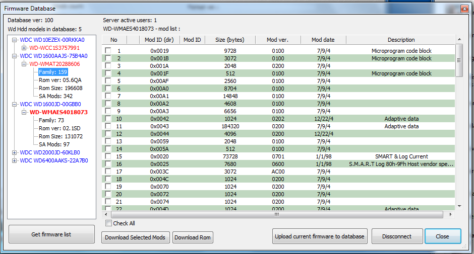

Hi all
@dustyhair I still haven't decided if.. to make that packer version public.
@Spildit I'm working these days (in my free time) at my tool. I'm coding the server side scripts to handle an online database with wd firmwares. Off-course, that must be populated in time by the users of my application. Do u have an idea of how many wd models exist? If I store 3 firmware versions for each model I could estimate the disk space required on server side.
le:ok, found something here. about 1500models. x3 x7MB (medium firmware size) =~ 30-35GB online space needed
