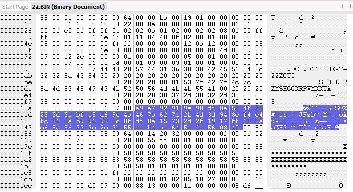

alex2501
PostPosted: November 26th, 2010, 15:55
Joined: November 24th, 2010, 17:42
Location: Germany
Can someone please find my pass? :)
WD.zip [840 Bytes]
Downloaded 17 times
I think your pw would be in the selected bit.

Well, I gave it another go and it must have been in a better mood this time as it populated the .bin files but these look very different from those posted above. I've attached zips of both a locked and unlocked drive. Anyone have suggestions for decoding them?
MHDD info for unlocked drive.
8.12.2010 20:43:41 MHDD>EID
8.12.2010 20:43:41 WDC WD2500JD-00FYB0 LBA: 488,397,168
8.12.2010 20:43:41 SN: WD-WMAEH1377067 FW: 02.05D02
locked.zip [1.52 KiB]
Downloaded 1978 times
unlocked.zip [1.51 KiB]
Downloaded 1934 times
PostPosted: December 9th, 2010, 17:43
Joined: December 7th, 2010, 23:06
Location: US Virgin Islands
Thanks to fzabkar for pointing out the obvious difference between the locked and unlocked version of the 42.BIN file. I was looking for difference between them by flipping back and forth but I think my view was clipping the last two lines where the password was sitting.
Comparing the two 42.BIN files, the entire file this time, shows the difference is the string "3wareUserPassword" is in the locked but not the unlocked version.
I had actually tried 3wareUserPassword before (having noticed it the first time I looked at the locked version of 42.BIN) but it didn't work. The password has to be padded with an additional 15 spaces to bring it's length up to the full 32 bits. These drives had previously been attached to a 3ware SATA raid controller which locks them upon incorporation into the array and that lock persists if the drives are not properly removed from the array. Like what happens when a server is shutdown, sitting on a shelf for 3 years, ravaged for parts (including the sata raid controller, and then give away.
