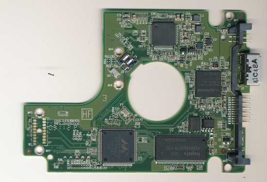

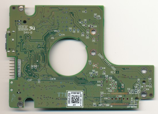

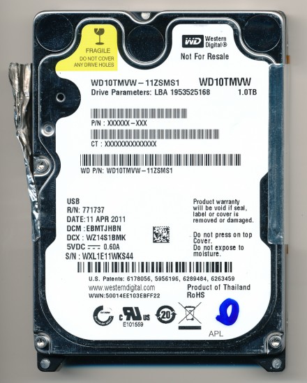

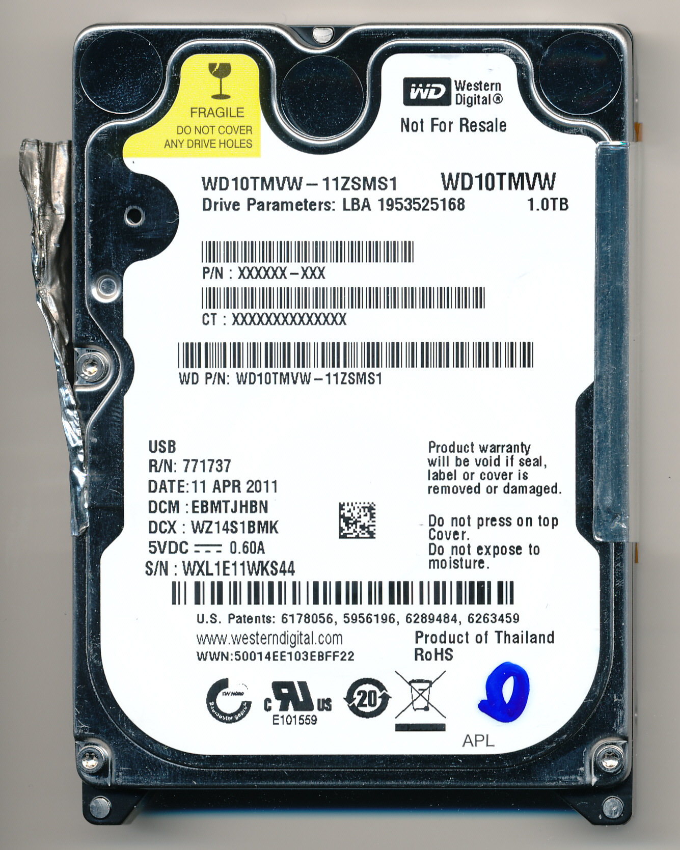

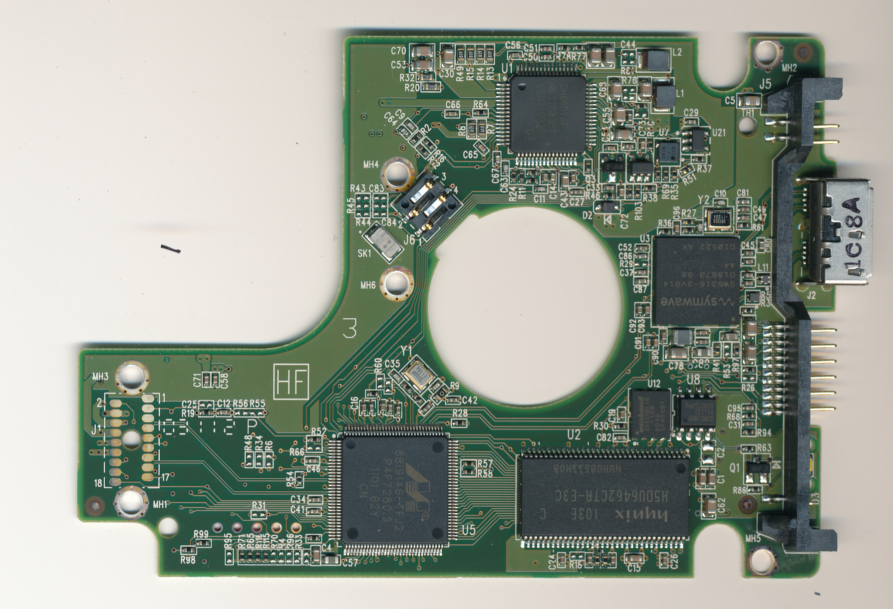

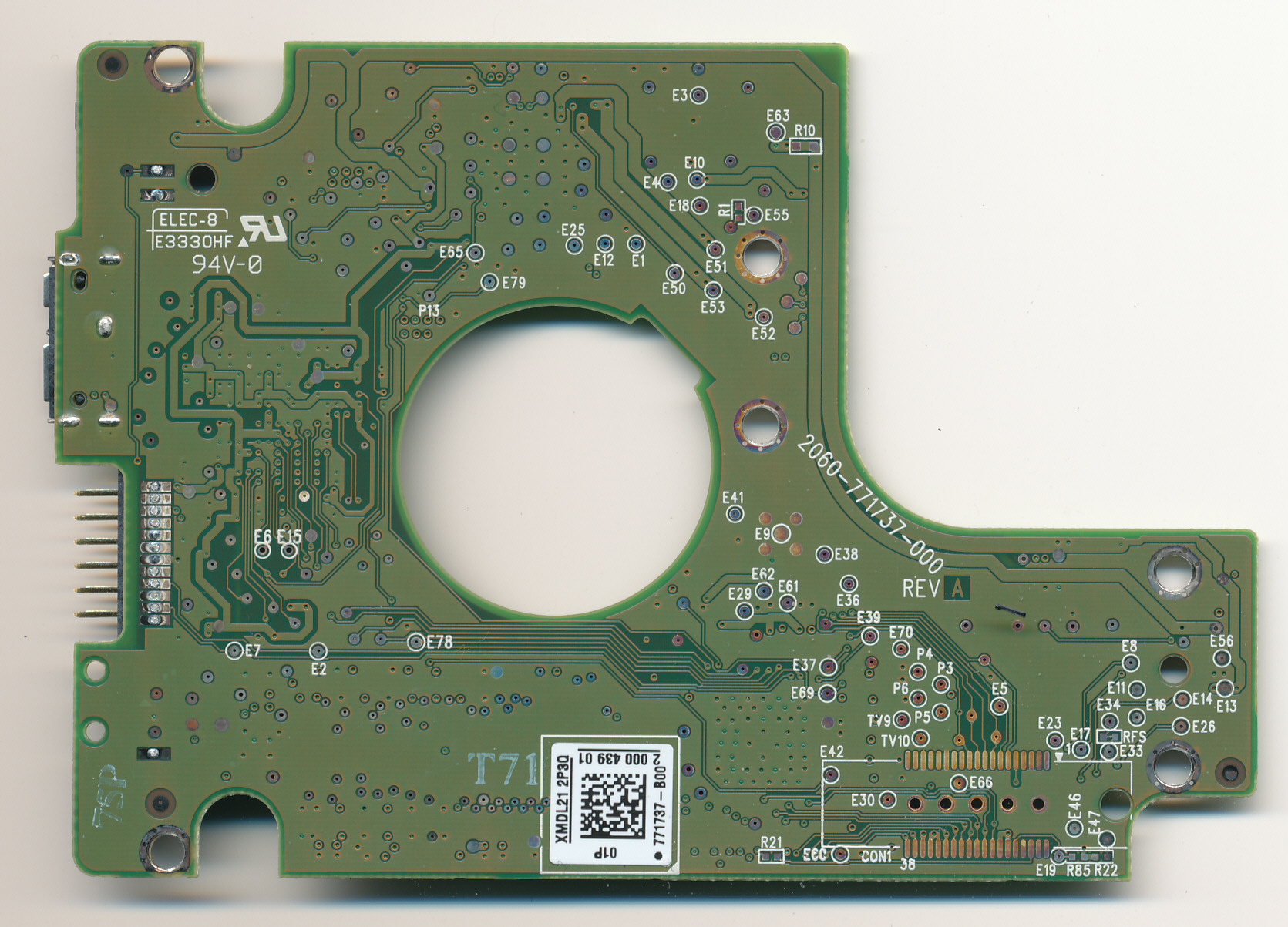

Hi guys,
garymon / martynui / loki, please help!!!
I have a similar drive, but different board revision. How can I identify those USB pins to bypass the connector?
Does anyone have the same board? Is it possible to identify the pins from the pictures attached?
HDD: WD10TMVW-11ZSMS1
Thanks so much!
Igor
 Post subject: Re: WD10TMVV
PostPosted: October 12th, 2012, 5:41
Joined: July 7th, 2010, 4:45
Posts: 924
Hi Igor,
Your USB connector doesn't look physically damaged?
What made you come to this diagnoise?
Whats the symptoms?
More info is really required to get responses
Loki
