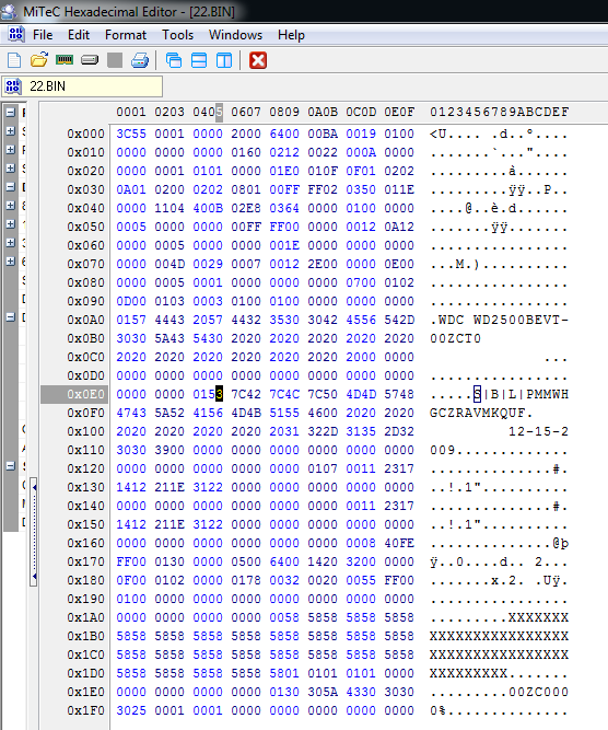

First of all thank you to all the replies on this post, it gave me a jumping off point for recovery of this HDD. On to the business, it was never my intention to post for help with the issue however I am stuck. I've tried various segments of the Hex file with no luck to unlock the drive. I've seen forum members help others after they've posted there dump so here I am.
Thanks in advance for any help with the situation.

So I have my own drive (WDC WD2500BEVT-22A23T0) that I am just trying to learn to do this on. I have set the password to be 'money' (without the quotes) but I can't seem to find the sequence of hex characters that match that password anywhere in the files generated by mhdd (I ran '.script' in mhdd and it gave me 21.bin and 22.bin(included)). Mhdd was run from a floppy drive on my laptop.(using what I suppose to be the last usb floppy drive in at least my zip code ;) ) according to the ascii table at: http://flint.cs.yale.edu/cs422/doc/art- ... APNDXC.PDF the sequence of hex I should be looking for is : 32 18 31 12 15 (m-o-n-e-y). Am I missing some kind of conversion that I have to do to the hex in order to be looking for the right thing? Or is the MHDD script not giving me the right stuff? Thanks in advance for any words of wisdom on this.

Ok, so it looks like the reason that i am not finding the right string of hex numbers in my output is because the script I am using is not using the right offset. I say this because it seems like everyone else here gets their password from the part that comes after the model number of the hdd. unfortunately my dumps are ending just almost exactly after the part where the hard drive model is shown. If I can find which register to change in the script so that the offset is correct, then I should be able to find the password I'm looking for. Can someone here please tell me if I'm on the right track? Can you tell me where to go to read up on how the regs= commands (in the mhdd scripts) work in relation to offsets. I can't seem to find documentation of it any of the ATA specs I've found. any help is appreciated.
PostPosted: March 23rd, 2011, 13:01
No it's because the 'script' doesn't work on ALL drives.

I understand that, so will changing the 'regs= $50 $otherStuff' commands ( in 'script') correctly allow me to change the offset such that the .bin output will show me the hex containing my password? I'm pretty sure that 'script' will work as beatniche (above my post) has been able to get the right output (with correct offset) with the same drive model I have. for some reason, my 22.bin output is only going to about the middle of where beatniche's goes. thanks for your reply.

Your drive WD2500BEVT-(22A23T0) is not the same as beatniche

The OP has informed me that he has successfully retrieved his password by fetching the next sector, as follows:
;script name: read md
;reads md 02 on WD marwell drives
reset
waitnbsy
regs = $45 $0b $00 $44 $57 $a0 $80
waitnbsy
regs = $d6 $01 $be $4f $c2 $a0 $b0
waitnbsy
checkdrq
sectorsfrom = cs.bin
regs = $d5 $01 $bf $4f $c2 $a0 $b0
waitnbsy
checkdrq
sectorsto = 21.bin
waitnbsy
checkdrq
sectorsto = 22.bin
waitnbsy
checkdrq
sectorsto = next.bin
; end

Yes, Thanks fzabkar. I did intend to post that soon but looks like you beat me to it. Looks like WD must be moving the location of the password depending on the iteration of the particular hard drive model. Either that or the exact location of the password for a given model depends on what state or country the drive is sold in. At any rate, thanks for the help!

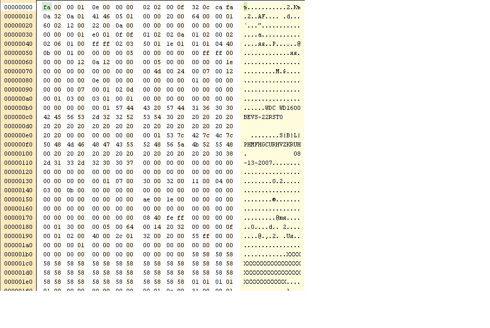

Hello guys! I understand youŗe pretty fed up with annoying "check my bin.22" But I have no choices left to ask you, could you, please, check my 22?:(( I have WD1600BEVS with security:high I have tried everything I had found here: ZU, MAVR_R, HDA2, WDC of 32 symbols. None of the methods worked out for me. Finally, I've managed to dump bin.22, but it seems very strange, cause I have no Alt Gr on my keyboard, so I've tried some hex to ASCII converters on the internet, but the result didn't make any sense, cause of its "illogical" matter. Could you check it, and help me with psw, or, at least just point at the right hex in my .bin. I appreciate in advance!

The psw is retrieved! :) Thank you for such a great thread!:)
