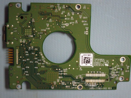

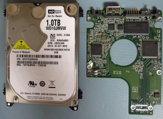

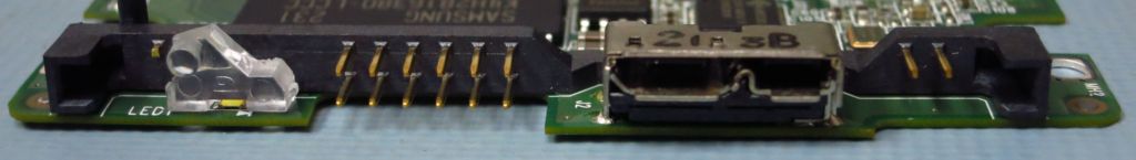

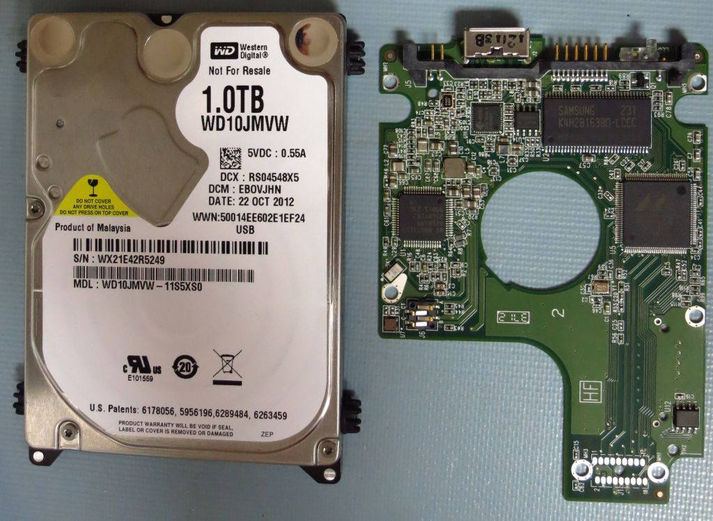

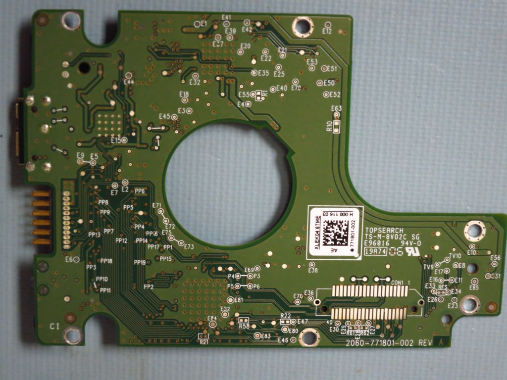

 Post subject: Re: WD10JMVW (not TMVV)
PostPosted: February 27th, 2013, 19:02
Joined: February 27th, 2013, 18:26
Hello all. This seems to be the most knowledgeable place I've yet to find, and this thread the closest cousin. Please excuse me if this is the incorrect place..
  • Up front statement regarding importance of data on this drive: TBD- I have asked the question to the drive owner. I am told that it contains all of their doctoral research that is due within several months. There is a chance this is the proverbial "only copy." I am trying to help, and am waiting to hear back with a few questions of my own..
I'm smart enough to not open my drive. Check. :) I have read through about 75% of this thread and am teetering between it being a controller issue and a HDD issue. In short, I have a WD10JMVW-- well, really, it's a friend of a coworker's, but anyway-- not a TMVV that is normally being discussed in this thread. It was brought to me to try and recover (I purchased a license for Stellar Phoenix recovery suite a few years back for a drive and it worked very well on that drive, so I offered to give it a shot on this drive)..
First of all, it's not a standard mini or micro USB. It's a dual connector of some sort. I'll attach a photo.. Anyway, connecting it with the supplied cable, I hear things start spinning up, and of course dreaded clicking. This goes on for about 30-60 seconds, and eventually stops. Using WinXP Pro, the device manager shows the disk and the SES entry. However no partition is ever mounted. Right clicking the drive in Device Manager and trying to populate the "Volumes" leads to the "Unreadable" and "0MB" values being reported with no volumes. Within the Disk Management section of Computer Management, no drive is ever listed. Plugging into a Windows-7 machine results similar (no partition mounted), but it did show up (the one time I tried it anyway) in the Disk Manager, as an "uninitialized disk."
Moving it back to the WindowsXP machine and using my own USB micro connector (into one of the two available connector slots) seems to still power up the drive, and that time the "Searching Media.." or whatever it's called (dialog box) of Windows XP popped up. So I THINK that meant that enough things occurred that it could actually find and mount a partition. Nervous, however, about running with a normal USB 3' cable instead of the supplied specialty cable, I stopped that process and went back to the short 12" supplied cable. However I cannot seem to get Windows to ever successfully try to scan the drive again.. Nothing is showing up in Disk Management .. I still get the standard entries within the Device Manager under HDD and SES Device, however.
Flash forward to this thread, I have removed the controller card to photograph each side.. I've NOT opened the HDD itself (I know better!).. As luck would have it, no images within this thread line up to the controller card that this version seems to have.
Because it attempted to mount once but not again since, I'm not sure if it's a controller thing and a SATA-workaround (bypassing USB adaptation) would be a worthwhile endeavor. However since it does seem to "re-try" several times going through various rounds of occasional clicking, I'm not sure if it's in fact a more fundamental HDD failure. If necessary I can run a video of what's going on.. but I haven't yet as I don't think that's probably necessary. I do have plenty of pictures though.
Questions and Situations:
1) Have I overlooked a simple way to help nail down if it's an interface problem or a fundamental HDD problem?
2) I am an electrical engineer working in a custom electronics design shop. Luckily, therefore, I have access to solder rework stations and can remove and replace pinned components if necessary. The parts on this board look to all be SOIC, TSSOP, TQFP, and QFN's. Though some are a finer pitch than we typically deal with, I think we can manage if it comes to that..
3) I have read reference to potentially poor ground connections or poor power supply through USB. Is that really a common problem with these drives or is that a rabbit trail I should avoid? I could easily solder up some wires to a bench-top 5+ and GND supply and give it as much juice as it needs.. But I don't want to bother with the effort if it's a red heron..
4) ..insert other appropriate questions here that I *should* be asking.. :)
5) Much higher resolution (12MP) photos available if necessary.. didnt' want to bog things down up-front..
thanks in advance!
..dane
 Post subject: Re: WD10TMVV
PostPosted: February 27th, 2013, 23:38
Posts: 285
USB 3 interface , will work in USB 2 also.
Most of the time the fault is internal , and not PCB fault
1)Disk spins up, clicks .(Heads or firmware problem).
Was the drive dropped ? How did the problem occur ?
2) only necessary if PCB has to be replaced.
3) Drive spins up, so not power related problem.
4) If data is important , get a proper diagnosis from a pro , there is very little DIY options in your case. Also chances of the drive deteriorating by DIY attempts are more.
Right, Do not open the drive, it will surely spoil any chances of recovery later.
PostPosted: February 28th, 2013, 4:01
It's internal (heads and/or media damage) problem, nothing to do with PCB.
There is no DIY solution for this, you need to send it to someone who knows what they're doing and has the appropriate skills,equipment and parts to deal with this.
