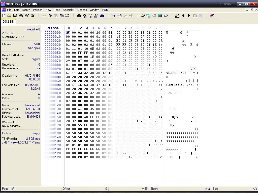

PostPosted: June 15th, 2011, 11:18
Joined: June 13th, 2011, 6:04
Location: Romania
can u tell me where is the pass here?? if it is after 01 07 bytes it is something with eight 0`s but i cant figure it out thnx
PostPosted: June 15th, 2011, 17:30
Posts: 17316
Is the drive installed in a laptop? USB enclosure?
How are you entering the password? BIOS or application software?

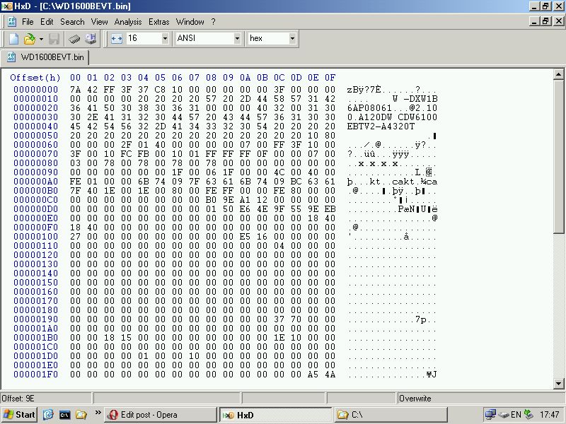

PostPosted: June 18th, 2011, 5:41
Joined: June 18th, 2011, 5:33
Location: Borneo
can anyone tell me what wrong with my drive?
I attach the hex dump using victoria.
WD1600BEVT.7z [325 Bytes]
Downloaded 1740 times
PostPosted: June 18th, 2011, 19:24
Posts: 17316
You have only attached one BIN file. The password appears to be in a subsequent BIN.
-Franc

00000160  C8 00 00 04 32 00 05 07 00 01 00 02 80 00 C8 00  È...2.......€.È.
00000170  80 00 00 80 08 10 0A 05 0A 14 28 5F 5F 78 80 80  €..€......(__x€€
00000180  00 08 00 05 03 00 02 00 10 07 00 08 00 10 0F 00  ................
00000190  01 00 01 00 01 02 0A 0B 07 05 02 00 01 02 06 02  ................
000001A0  00 00 02 06 00 00 06 04 00 03 02 00 16 00 01 02  ................
000001B0  06 02 00 00 02 03 00 00 06 06 00 05 0A 00 16 00  ................
000001C0  01 01 01 00 01 14 64 00 00 00 01 64 00 00 4E 00  ......d....d..N.
000001D0  00 7E 00 00 07 01 78 03 00 64 00 00 00 03 84 7C  .~....x..d....„|
000001E0  D0 00 0A 00 14 3C 40 00 01 04 0A FA 00 00 01 0E  Ð....<@....ú....
000001F0  00 00 00 02 02 00 0F 32 0C CA FA 0A 32 0A 01 3C  .......2.Êú.2..<
00000200  55 00 01 00 00 20 00 64 00 00 BA 00 19 01 00 00  U.... .d..º.....
00000210  00 00 00 00 00 01 60 02 12 00 22 00 0A 00 00 00  ......`...".....
00000220  00 00 00 01 01 00 00 01 E0 01 0F 0F 01 02 02 0A  ........à.......
00000230  01 02 00 02 02 08 01 00 FF FF 02 03 50 01 1E 64  ........ÿÿ..P..d
00000240  01 11 04 40 0B 02 00 01 00 00 00 00 05 00 00 00  ...@............
00000250  00 00 FF FF 00 00 00 00 12 0A 12 00 00 00 05 00  ..ÿÿ............
00000260  00 00 00 00 1E 00 00 00 00 00 00 00 00 00 4D 00  ..............M.
00000270  29 00 07 00 12 2E 00 00 00 0E 00 00 00 00 05 00  )...............
00000280  01 00 00 00 00 00 00 07 00 01 02 0D 00 01 03 00  ................
00000290  03 01 00 01 00 00 00 00 00 00 00 01 57 44 43 20  ............WDC
000002A0  57 44 33 32 30 30 42 45 56 54 2D 32 32 5A 43 54  WD3200BEVT-22ZCT
000002B0  30 20 20 20 20 20 20 20 20 20 20 20 20 20 20 20  0
000002C0  20 20 20 20 20 20 20 20 00 01 53 7C 42 7C 4C 7C          ..S|B|L|
000002D0  50 5A 4D 53 48 47 43 4B 52 5A 56 41 4B 51 55 41  PZMSHGCKRZVAKQUA
000002E0  00 20 20 20 20 20 20 20 20 20 20 20 20 20 31 30  .             10
000002F0  2D 30 36 2D 32 30 30 38 00 00 00 00 00 00 00 00  -06-2008........
00000300  00 00 00 00 00 00 00 00 00 00 00 00 00 00 00 01  ................
00000310  07 00 24 00 16 00 20 00 17 00 14 00 00 00 00 00  ..$... .........
00000320  00 00 00 00 00 00 00 00 00 00 00 00 00 00 00 00  ................
00000330  00 00 53 00 1C 00 00 00 00 00 00 00 00 00 00 00  ..S.............
00000340  00 00 00 00 00 00 00 00 00 00 00 00 00 00 00 00  ................
00000350  00 00 08 40 01 00 00 01 30 00 00 05 00 64 00 14  ...@....0....d..
00000360  20 32 00 00 00 0F 00 01 02 00 00 01 78 00 32 00   2..........x.2.
00000370  20 00 55 FF 00 01 00 00 00 00 00 00 00 00 00 00   .Uÿ............
00000380  00 00 00 00 00 00 00 00 00 00 00 00 00 00 58 58  ..............XX
00000390  58 58 58 58 58 58 58 58 58 58 58 58 58 58 58 58  XXXXXXXXXXXXXXXX
000003A0  58 58 58 58 58 58 58 58 58 58 58 58 58 58 58 58  XXXXXXXXXXXXXXXX
000003B0  58 58 58 58 58 58 58 58 58 58 58 58 58 58 01 01  XXXXXXXXXXXXXX..
000003C0  01 01 01 00 00 00 00 00 00 00 00 00 00 01 FF FF  ..............ÿÿ
000003D0  FF FF FF FF FF FF 00 00 00 00 00 00 00 00 80 00  ÿÿÿÿÿÿ........€.
000003E0  00 00 00 00 00 01 02 05 10 27 00 00 88 13 00 00  .........'..ˆ...
000003F0  00 00 D0 07 00 00 88 13 00 00 1E 00 00 00 05 D6  ..Ð...ˆ........Ö
00000400  06 00 01 00 00 00 00 00 00 00 00 00 00 00 00 00  ................

PostPosted: July 4th, 2011, 6:38
Joined: July 4th, 2011, 6:15
Location: yemen
help with my WD 3200BEVT-22ZCTO I have try every thing and I couldn't know the password here is the 21.bin file&22.bin
help me find the password it's master password
bin files.rar [751 Bytes]
Downloaded 2158 times
