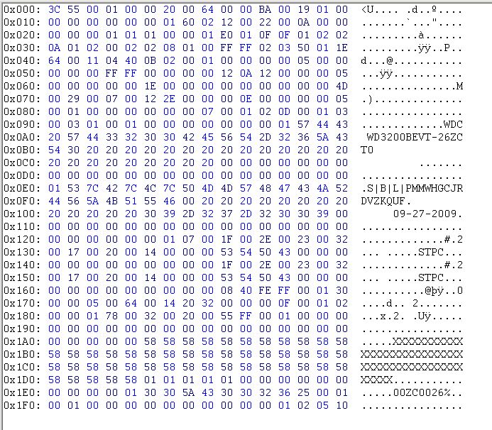

PostPosted: July 15th, 2011, 9:47
Joined: July 15th, 2011, 9:33
Location: Germany
Hi everyone,
could someone plz find the password for my wd?
attached the 22.bin :)
THX

PostPosted: August 15th, 2011, 7:21
Joined: August 15th, 2011, 7:00
Hi, can anybody help me with unlocking my HDD? I tried almost everything but with no results... I saw plenty of 22.bin files on this forum but my file is so different :(
I put here 2 pictures from 22.bin and 42.bin...
I really need your help. Without my files I'll be ruined :(

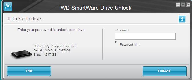

 Post subject: Re: Unlocking Password for Western My passport 320gb usb
PostPosted: August 20th, 2011, 13:54
Joined: August 20th, 2011, 3:16
Location: hcm city
S/N: WXG1A10M5631
P/N: WDBAAA3200ASL-00
File System: UDF
I can't access into hdd and can't copy everything to hdd.
Please you help me unlocking password of HDD.Thanks so much

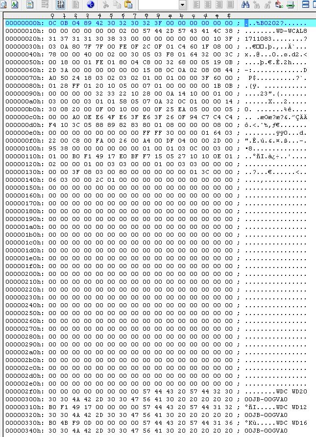

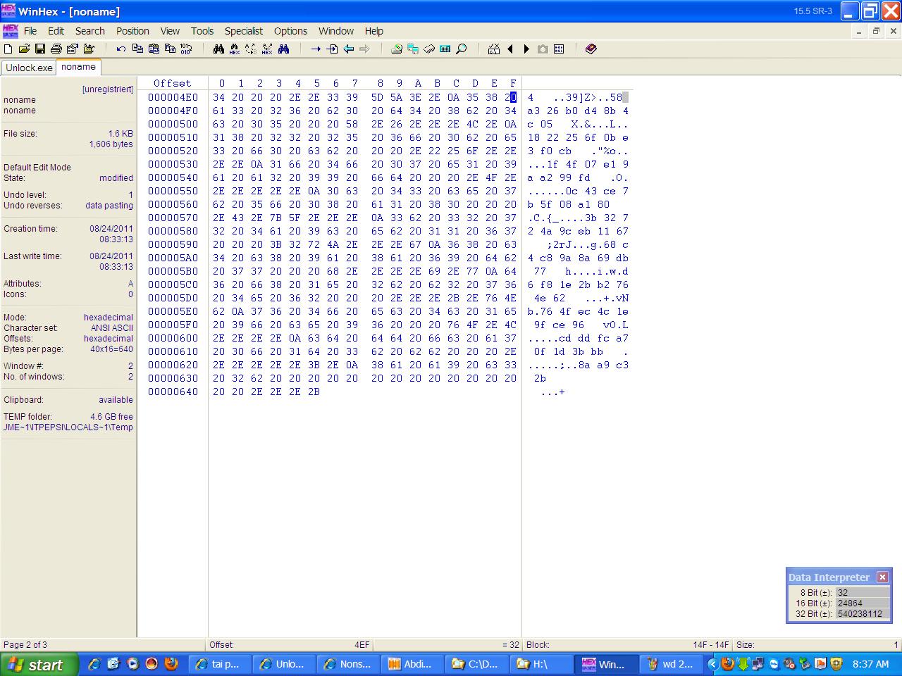

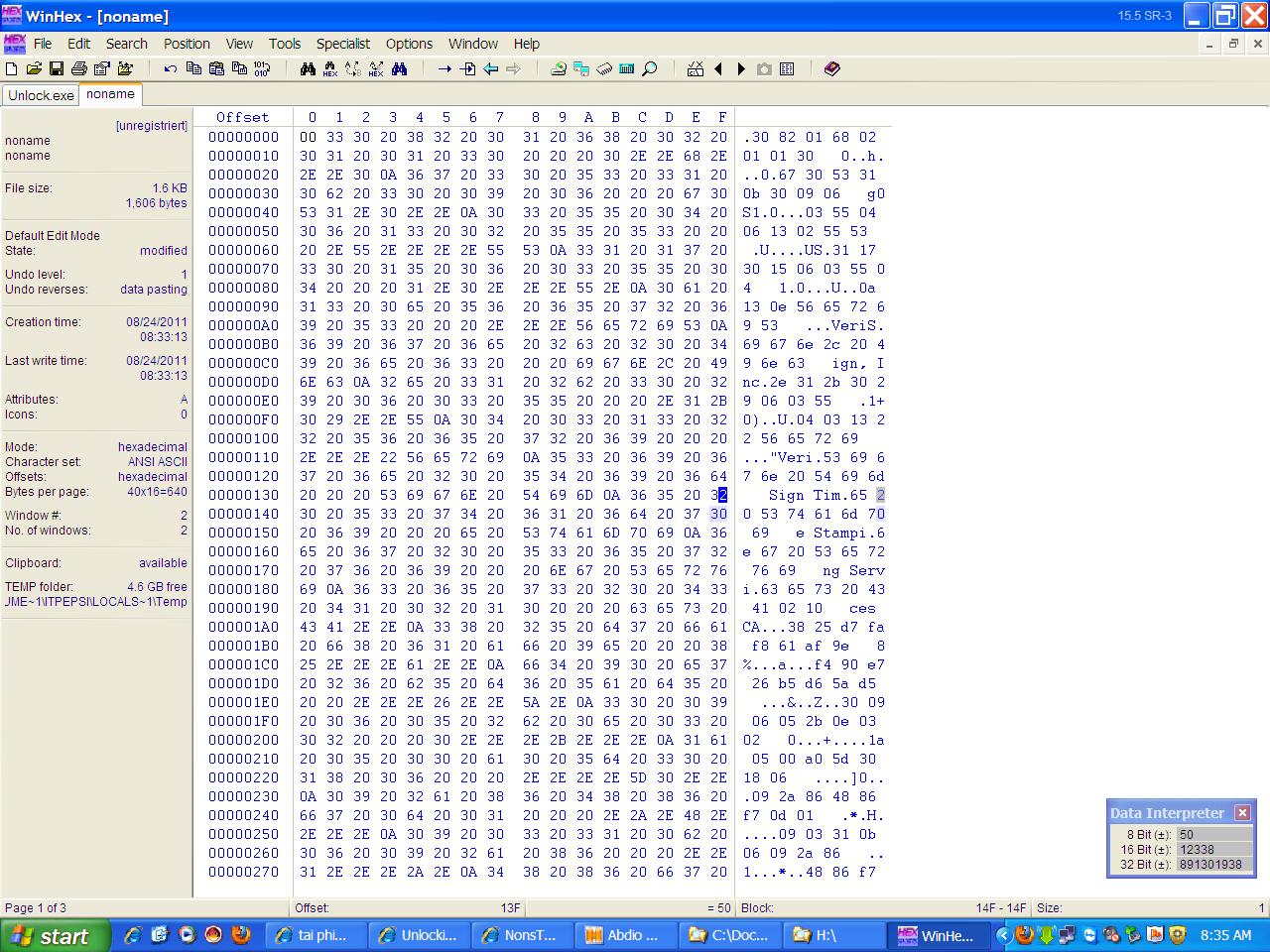

PostPosted: August 21st, 2011, 22:49
Joined: August 21st, 2011, 22:44
This is my 22.BIN. Can someone can help to decode the password?
PostPosted: August 22nd, 2011, 22:47
Location: hcm city
Please,... someone can help me to decode the password???
PostPosted: August 23rd, 2011, 13:00
Posts: 2855
thai_goldsilver wrote:
S/N: WXG1A10M5631
File System: UDF
NO PASSWORD = NO DATA very simple

PostPosted: August 23rd, 2011, 21:41
Location: hcm city
nobody help me to read pass?Please help....
