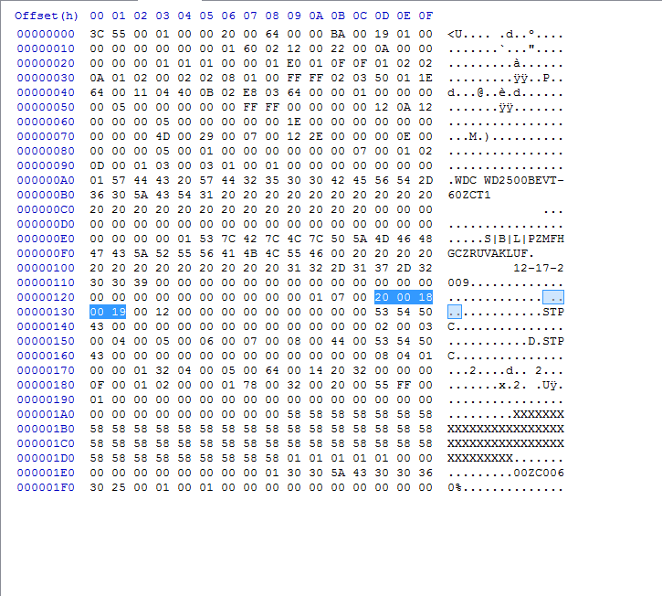

is it possible someone might beable to help me out I have ran the scripts and have the 21.bina nd 22.bin but can't seem to find the password here is the output from 22.bin I assume that the XXXXXXXXXXX is the master password but it rejects it

PostPosted: September 11th, 2011, 19:48
Joined: September 1st, 2011, 19:31
Location: NC USA
I got it solved that you all verymuch for the informative post prior to mine it turned out to be spaces
Thanks again you have just made be a very happy PC tech
