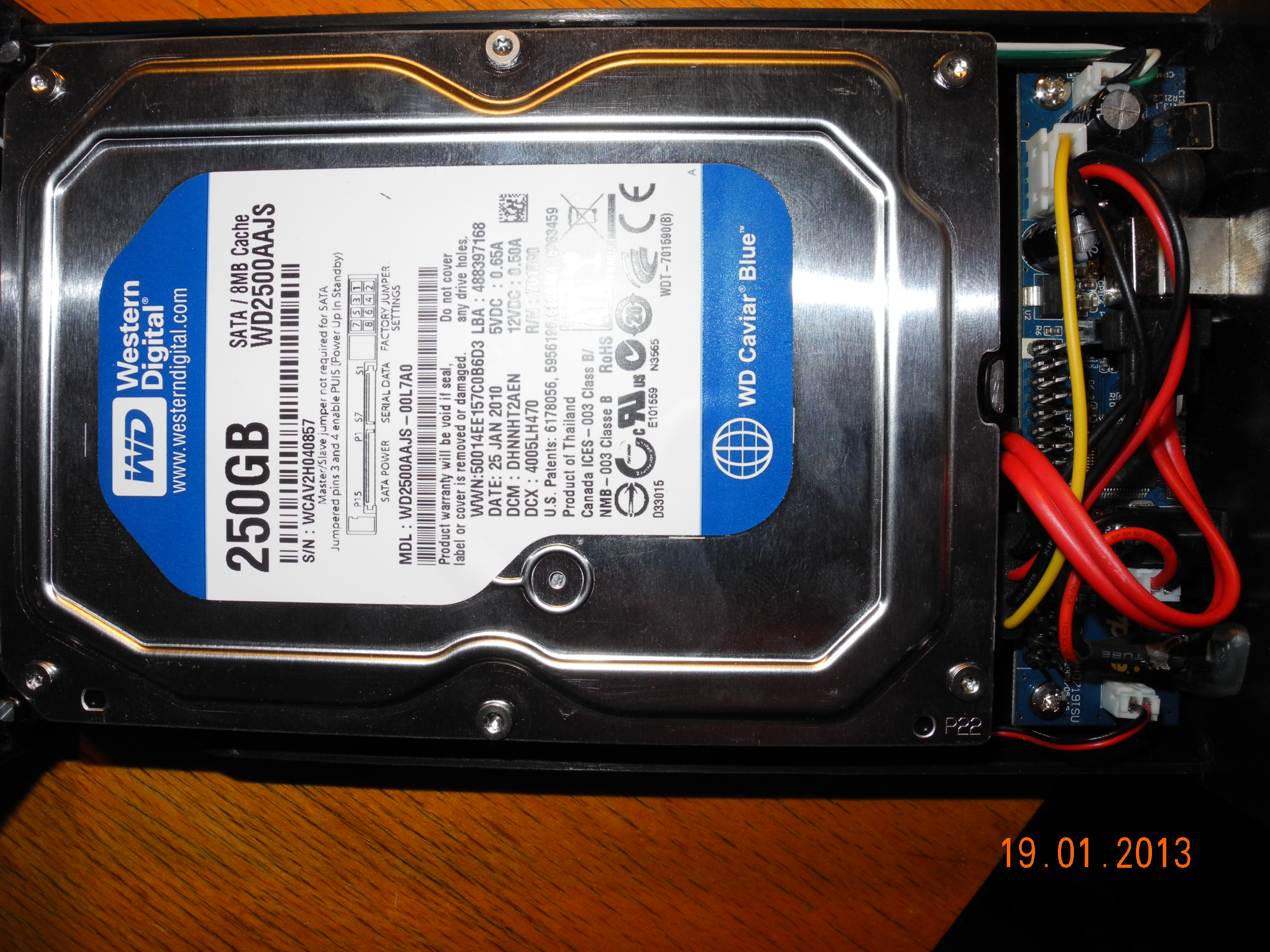

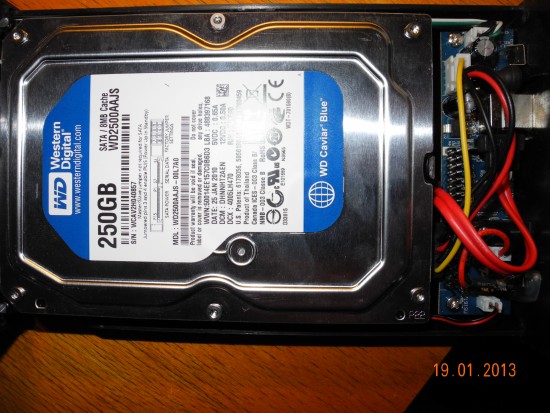

Hello to you all.
It happens that I have a very similar problem with a WD HDD of a friend.
For me it happende like that: The HDD was attaced to an external USB enclosure and work fine.
When I wanted to attach this HDD direct inside the very same computer, I had the same problem. The HDD was not seen by BIOS or Windows Disk Manager.
However if I attach the drive to the external USB enclosure, it works fine.
Searching for a solution I come across this forum.
This is a very strange behavior. It might be that the external controller use another means of comunication with the drive.
Enyway I thought it might be hepfull to giannis267 in order to recover the info from that HDD.
It would be excellent if some specialist could explain that behavior so we can mind it in the future.
 Post subject: Re: WD2500AAJS strange problem...
PostPosted: January 19th, 2013, 8:03
Joined: January 19th, 2013, 6:38
Location: Bucharest
Here is the techical details of the above:
WDC WD2500AAJS
Western Digital 250GB SATA II [WD2500AAJS]
WD CAVIAR - Blue
S/N : WCAV2H040857
MODEL NUMBER: WD2500AAJS
FIRMWARE: 00L7A0
DATE: 25 IAN 2010
DCM: DHNNHT2AEN
COUNTRY: THAILAND
ENCLOSURE SPIRE SP176ISUO-BK-EU (ide+sata)
http://www.spire-corp.com/main/product_ ... ProdID=838
WITH CONTROLLER JMICRON jm20337
http://www.jmicron.com/JM20337.html
