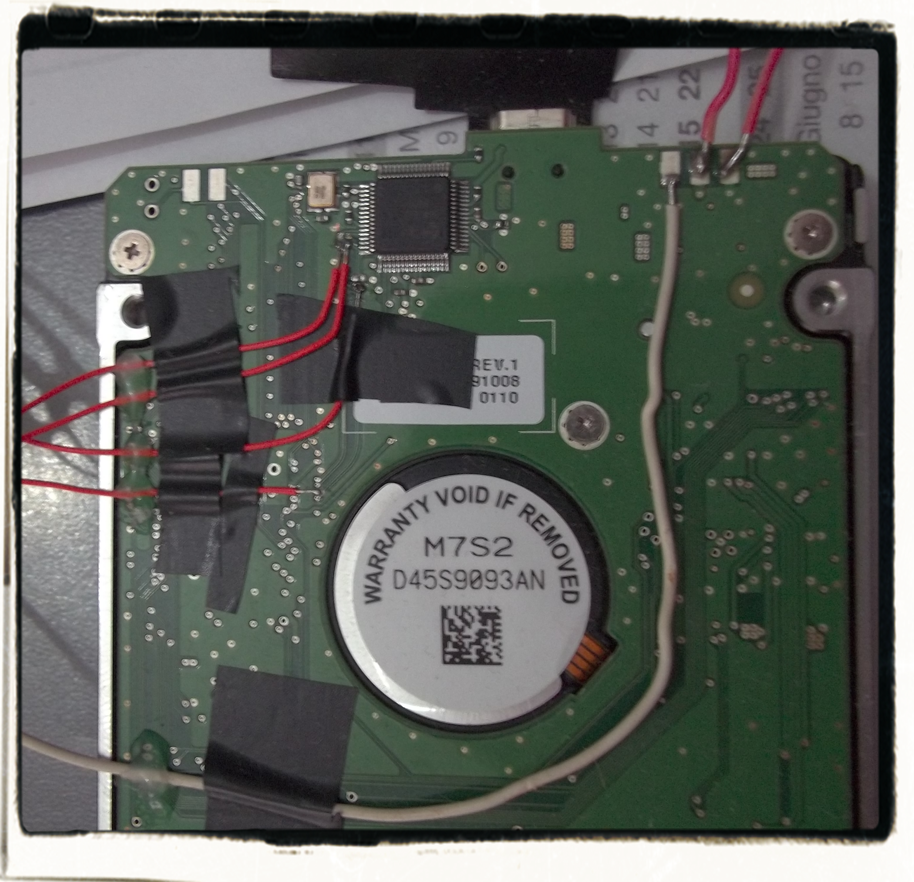

Hi Guys,
I need your help here.
Model: HM502JX
Issue: After connecting USB cable, drive is spinning but it's not recognized by Windows O/S. I want to give a try with connecting a SATA cable but I need to know which of these capacitors correspond to: Transmit+, Transmit-, Receive+, Receive- ?
Please check the picture attached, I have marked 4 capacitors with red numbers 1,2,3 and 4.
Will be grateful for your advice!
Thanks in advance, cheers!

forgot to write that the chip above it is JM20339
Update:
Just found a datasheet here:
http://www.wison.com.tw/cht/document/LT ... 061012.pdf
In my case above:
1- RXP
2- RXN
3- TXN
4- TXP
Can you confirm if P means 'positive' + and N means 'negative' - ?

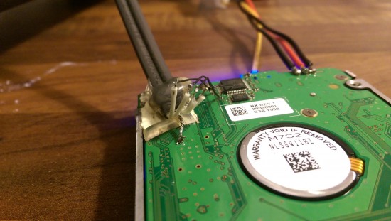

Hi everybody,
As you can imagine, i have the same issue that the other people on this board.
My usb connector on my samsung usb drive 250go is broken and it seems really difficult to repair so i decided to explore others possibilities as described here.
At the beginning, my drive can spin on and i heard head and rotation (when i made contacts between usb connector and pcb), it was seen by computer but not recognized at all (model, capacity,...). But thereafter, the connector was too damaged to continue with that method.
So, i have read what others people have done and removed the 4 capacitors (as loki said) and connected Tx ( /-) and Rx ( /-) from the pcb to a connector (as you can see on the picture).
On this connector, i can plug a sata cable.
So:
RX/TX (green/blue/red/white) => connector => sata cable => motherboard
blue (on the left) => GND on molex motherboard
red (on the left) => 5V on molex motherboard
I checked my soldering works (no contacts between RX/TX and /-).
When i powered up, blue light was on and i heard the disk rotation but no head and spin on.
My question is what can i check to see if i cracked something else, verify my solderings, any ideas ... ?
In the same time, i'm searching others compatible pcb as donor.
ref:
Model: HM252HX
HDD P/N: HM252HX/VPK
PCB Number BF41-00282A 00
PCB Info M7S-S_Line Rev .01 R00
Number of Main Chip: 88i8823-TFJ2
Number of Motor Chip: TLS2505
Bios chip ? (inside main chip or it's the 8 contacts chip near my solderings)
Thank you in advance for any suggestions

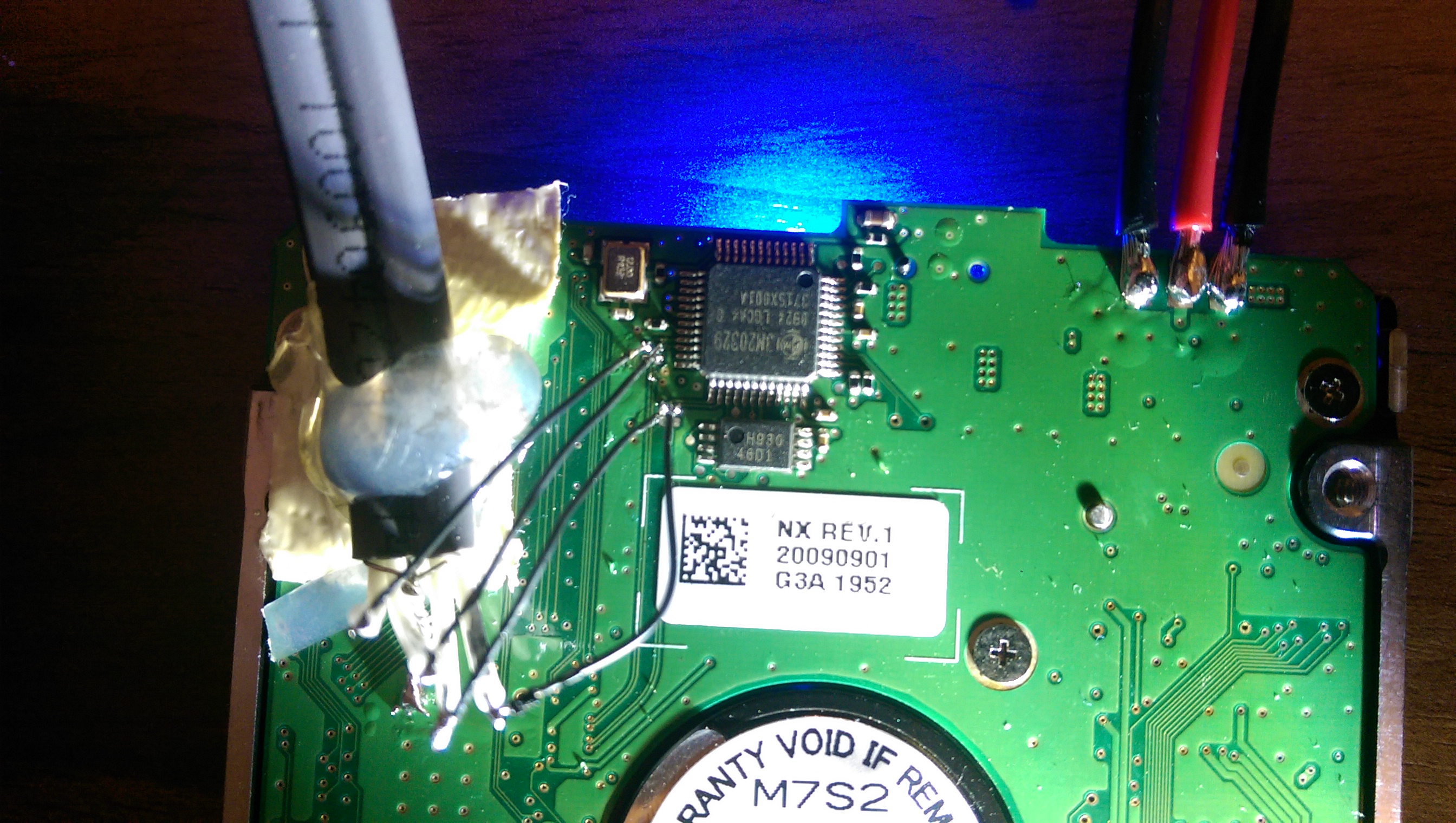

I made these changes, raised capacitors.
Food intake as in the photo, or from USB.
It gives me the same error sound.
What can I now?
What evidence?
thanks

What sort of sound have you ? rotation sound ? clicking sound ?
Make sure you have 5V (for my case i have to take stable 5V directly on molex, under voltage doesn't work for me)
Have you a terminal access ?

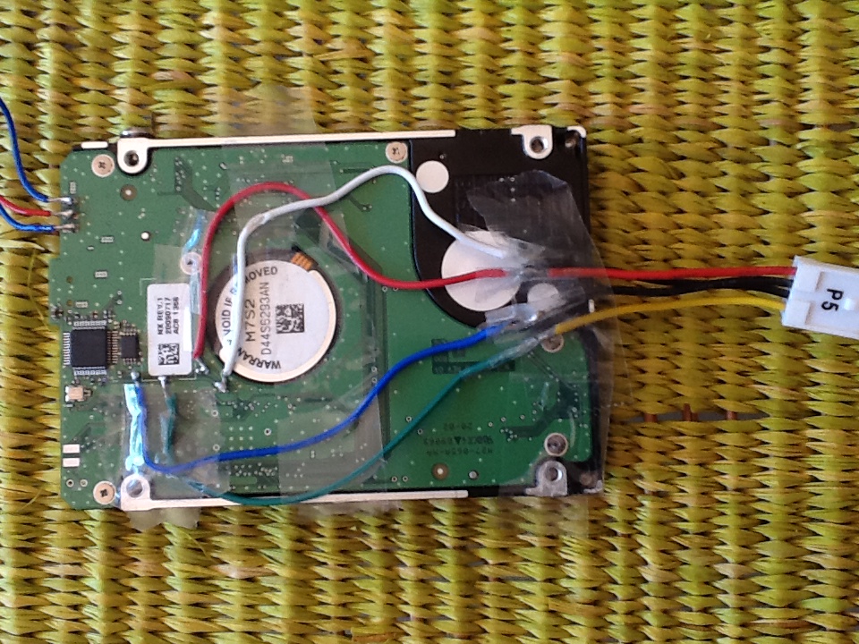

Location: Germany
my HDD is broken at the USB connector. We solderd the 5V and ground.
Also we put RXN / RXP and TXP /TXN on the board.
We put of the 2 caps.
This is my SATA Kabel:
|RXP RXN TXN TXP| |
When I boot up Linux I recieve the folling error messages:
ATA8: COMRESET failed errno = -32
reset failed
irq_stat 0x00000040, connection status changed
SError: { CommWake DevExch }
Exception Emask 0x10 SAct 0x0 SErr 0x404000
Do anybody know anything to help me out of trouble?
Best Regards
Heinz

These are the pictures of our wireing.

I would say, pay attention on were you solder things....you are at the wrong end.

What do you mean, I am at the wrong end?
 Post subject: Re: Samsung HM502JX USB Only?
PostPosted: August 17th, 2017, 3:44
Posts: 17326
You should be connecting to the MCU end of each capacitor rather than the bridge end.
