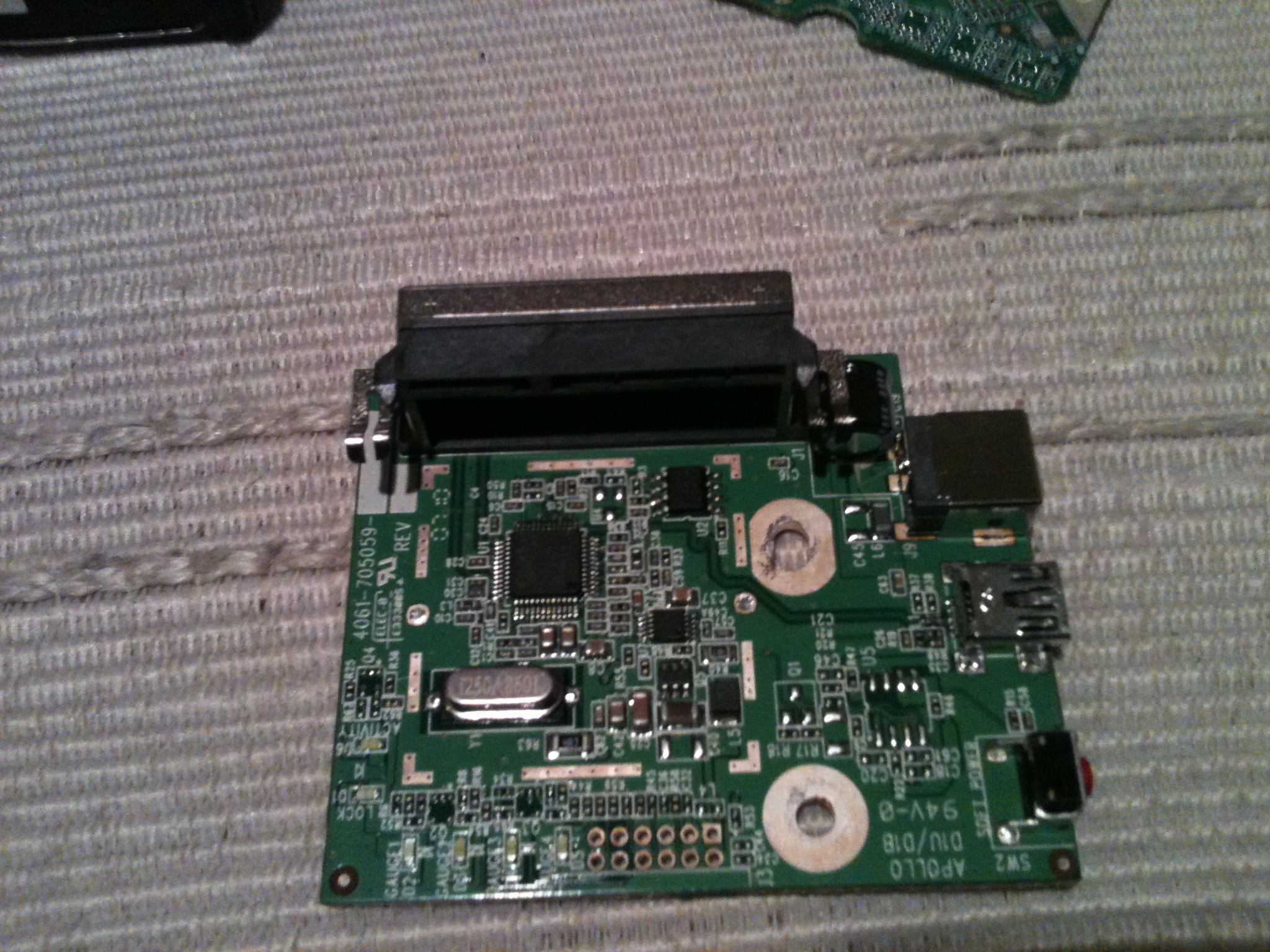

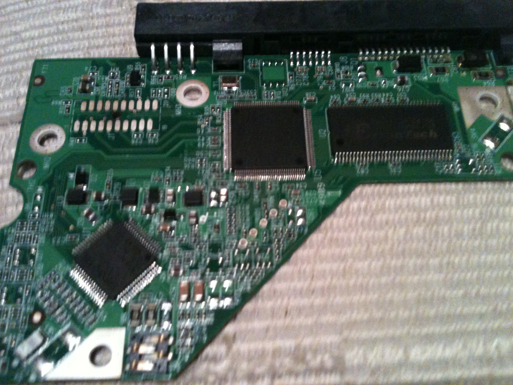

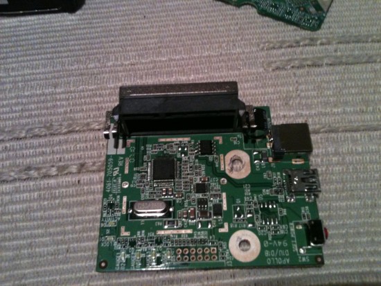

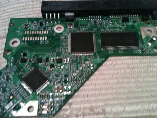

eclipse74569 wrote:
... all I have to say is Thank heavens mine doesn't have the U12 eeeprom, as it's on the other board for my My Book External HDD (which is where the messed up HDD comes from to begin with). Just snip the 8 pin off the new PCB and just go with the flow!
I don't understand what you mean. Snipping EEPROMs is something that you DO NOT want to do. Furthermore, the fact that your board doesn't have an external EEPROM is a big minus, not a plus. When you swap a board, you need to transfer the EEPROM, or its contents, to your donor. This is because the EEPROM stores unique, drive specific information. Transferring an 8-pin chip is something that any TV repair shop can do. Unfortunately, your board's "adaptive" data are contained within the Marvell MCU (big "M"). This means that, if your board has other problems, then you will need to pay for professional data recovery to transfer the MCU to your donor, or recover the adaptives from the platters.
Ok...*blinks* Ok, what I mean is the eeeprom is not on the current messed up PCB itself! But it's rather on the first photo attached. Unless I am mistaken and I have been known to make mistakes :D
And if I'm understanding you correctly, that would have to be transferred over to the new PCB? I apologize for inconveniencing you :)
