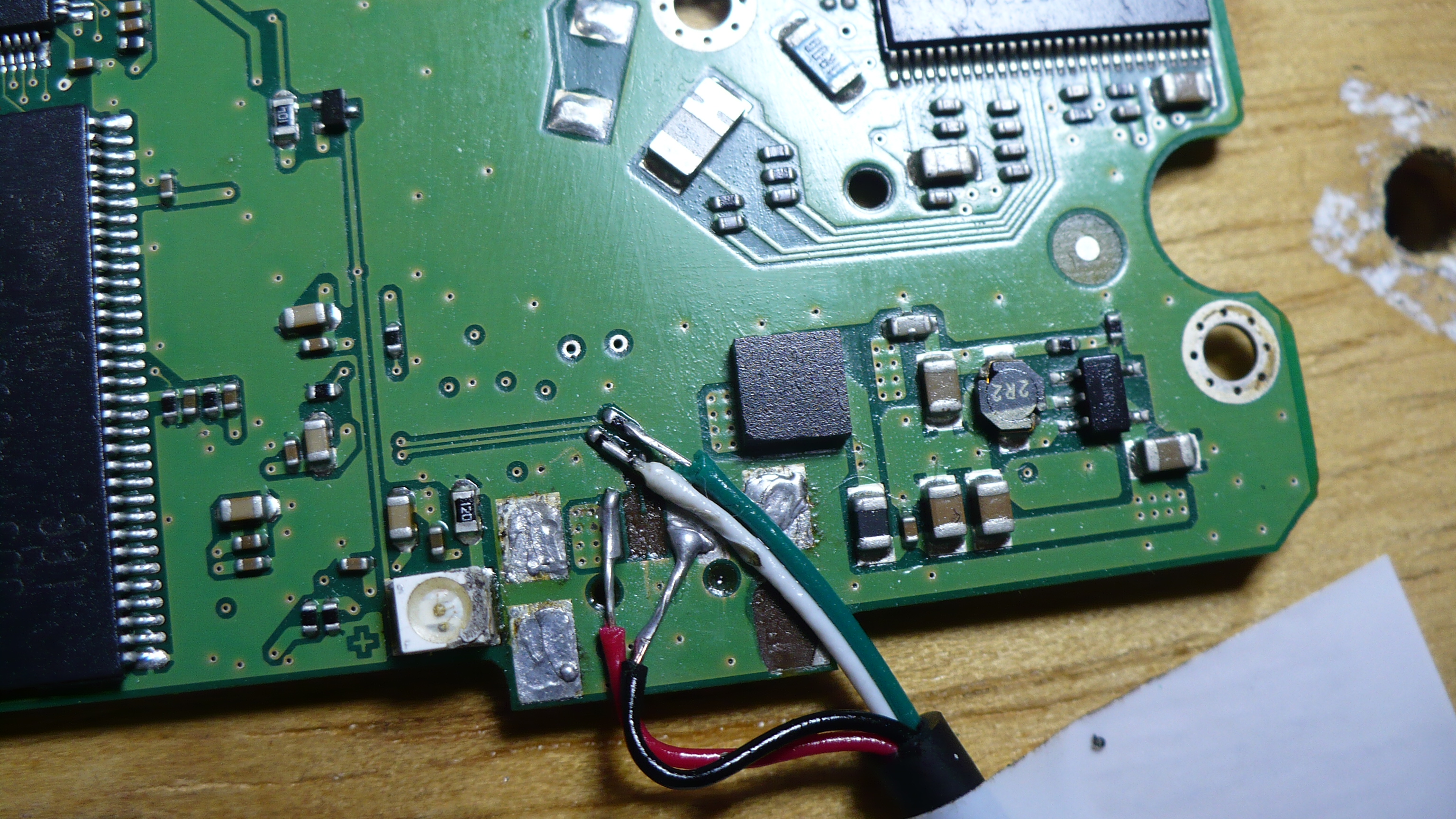

Hi everyone! I manage to get the data out of the drive!
I were able to solder a usb cable directly to the pcb.
Here a picture of the finished work.
Thank you all for the help!

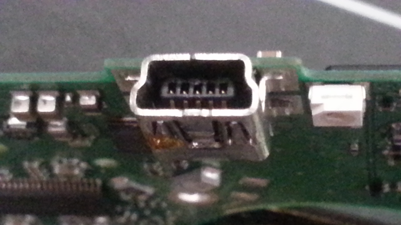

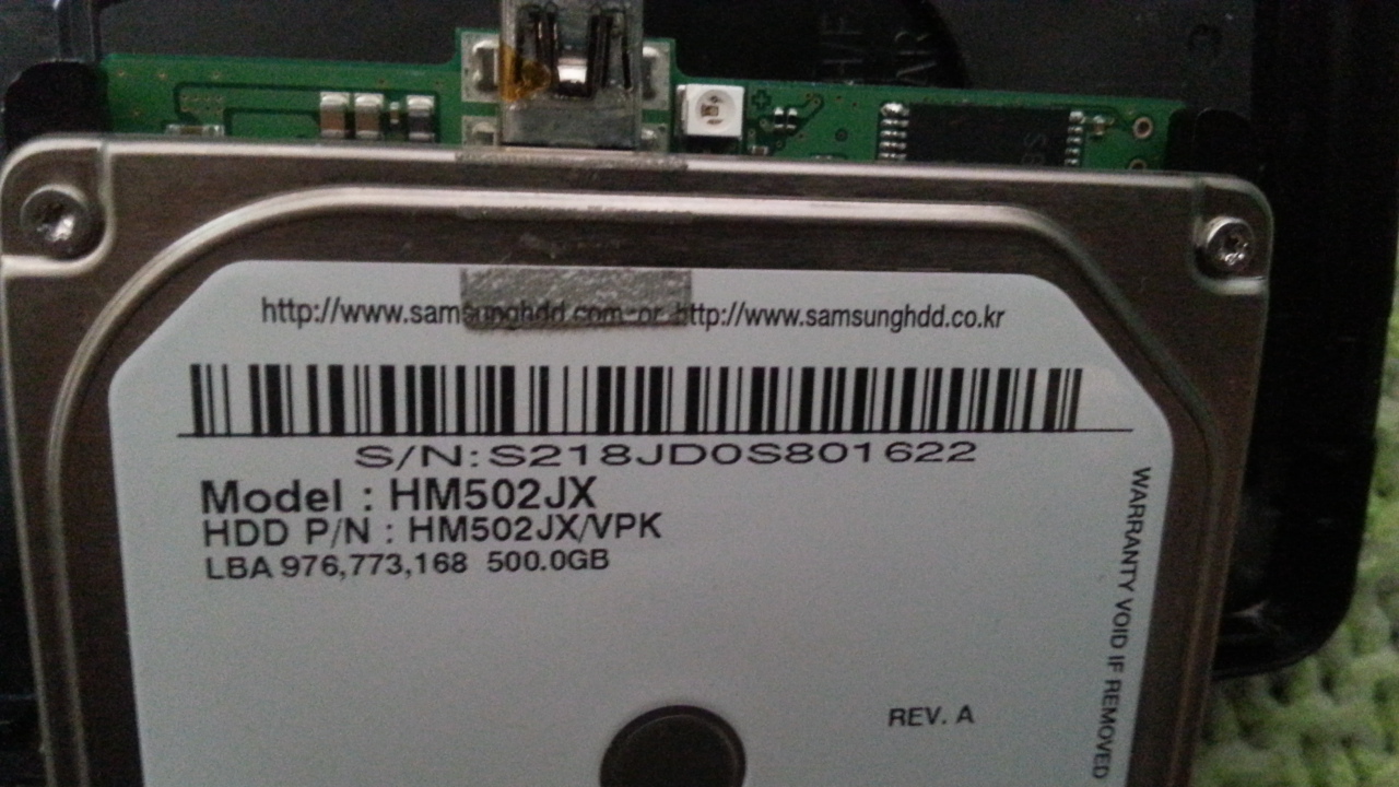

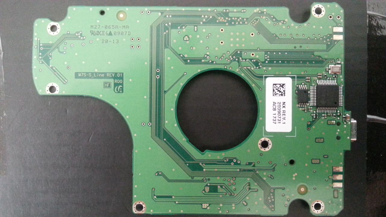

Old topic but same case.
Samsung HM502JX/VPK
PCB BF41-00282A (M7S-S Line Rev 01 R10 )
Client says damage occured possibly by water . No water anywhere now. Dried .
Drive working. But spinning and clicking nonstop. I guess head problem.
PCP has different connector Not SATA . But I want to check with MRT before head swap. I don't have SATA donor PCB ( BF41-00249B) according to data medics compatible list .
Also no external bios chip. (Maybe not unique rom chip for this drive. I don't know. Don't have donor PCB yet also)
How do I prepare sata connection . Any pinout info to communicate with MRT.

Locate the SATA Tx/Rx pairs on the SATA PCB and follow the traces back to their respective pins on the MCU:
https://hddsdatarecovery.com/2527-thickbox_default/samsung-hm320ii-pn-c2131f141a4c9c-bf41-00249b-02-pcb.jpg
Then locate those same MCU pins on the USB PCB, remove the coupling capacitors, etc.

Thanks. I have decided to do same way. Would try
