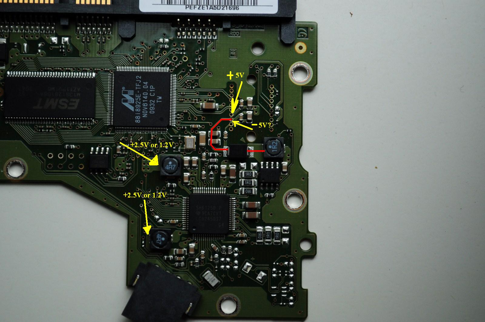

so i've bridged the fuse but still nothing.
But the chip with the M on is getting warm, not hot, but warm.
Don't know if that's a common thing.

 Post subject: Re: Samsung hd502hj
PostPosted: January 18th, 2011, 20:08
Posts: 17335
The most expedient solution is to transfer the flash memory chip (AT25DF041A) to your donor PCB.
Otherwise, I would say that a warm MCU may be normal, except possibly if it is being held in the reset state by a POR signal from the motor controller. If you wish to troubleshoot the board, then I would check the output voltages of the 3 switchmode DC-DC converters. These DC-DC converters are in the vicinity of the three coils, 1R2, 4R7, and 4R7.
The 1R2 coil is part of the negative supply for the preamp. There is a Schottky flywheel diode immediately to the left of it. The anode (non-striped end) of the diode connects to the 3rd pin from the bottom left corner of the preamp connector. That's the negative supply pin, probably -5V. The 4th pin is probably a +5V supply for the preamp.
The two 4R7 coils are part of the Vcore and Vio supplies. Measure the voltages at the left pin of each coil. Vio should be +2.5V, Vcore is probably 1.2V.

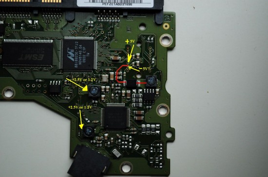

You mean like this Fzabkar????
I use one probe of my fluke on marked items and where do i put my other probe of the multimeter???
Or do i measure over the coils????

Root cause for your problem is a faulty power supply, which generates high(er) voltage spikes. Please replace it asap.!
Please don't use OHM test, use DIODE test instead. The voltage should be between 0.6V and approx. 1.8V.
There is no fuse on this PCB.
If nothing really helps, take (another disc with) the same PCB, and replace the FLASH-ROM: the small chip with 8 pins, reght beside the "M"-Controller.
Cheers,
Thomas
PostPosted: January 19th, 2011, 16:55
Posts: 17335
Yes, your illustration is correct.
The black (common) lead goes to ground. Use one of the ground pins at the SATA power connector:
Set the meter on the appropriate DC voltage range, eg 2VDC or 10VDC. Be very careful not to slip with the probes, as serious damage could result.

so the resistor next to the 5v tvs isn't sort of a fuse??
PostPosted: January 19th, 2011, 23:03
Posts: 17335
I can't see the marking, but if it is an "N" or "S", then it's an smt fuse.
Littelfuse Surface Mount Fuses, N = 2A, S = 4A:
http://www.farnell.com/datasheets/48294.pdf
In any case, the component connects the +5V supply pins at the SATA power connector to the +5V plane of the PCB, so it must be a protection device of some sort.
