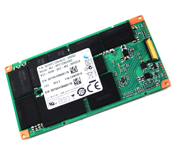

I don't mind a little soldering; is book14's pinout from page one good?
"pin 1 17 20 23 26 should be G
Pin 3-13 is 3.3V (try to use the 1117 to regenerate the 3.3V instead of 5V
the 18-19 21-22 is the Front Side SATA Signal
and the 24-25 27-28 is the Back Side Sata Signal."
For starters, looking at the drive it looks like pin 16 is G not 17. Everything else seems reasonable in terms of the data channels being easy to ID. I just want to kind of make sure that pinout is mostly correct, and that I won't fry something by connecting it like that. I have USB SATA interfaces to solder it to, but since it has 2 data channels won't I need 2 interfaces? or can I just use 1 ZIF cable? http://pinoutsguide.com/HD/ata_sata_zif_pinout.shtml
ZIF cable seems to have enough data channels to handle two drives, but will it be recognized?

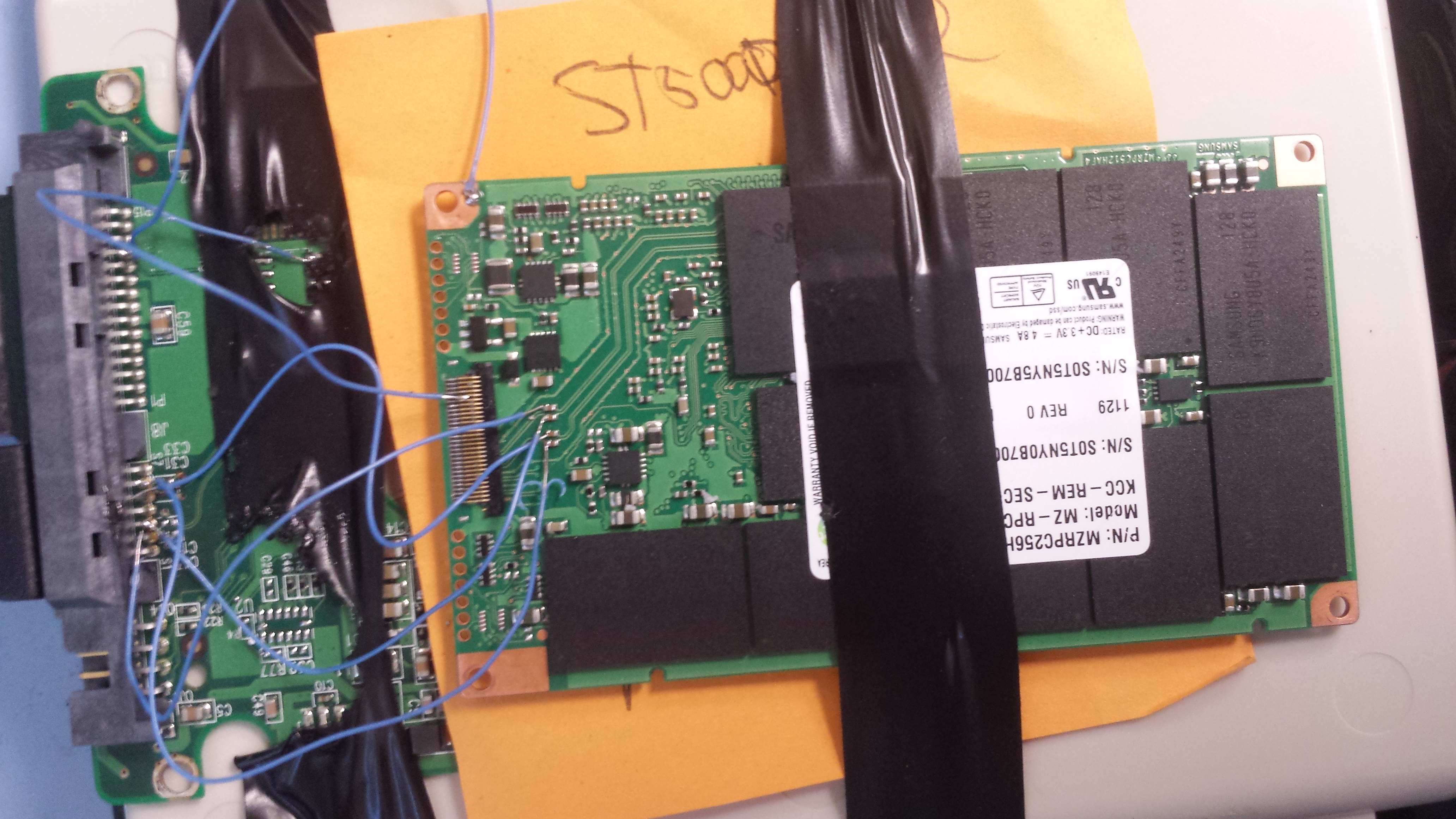

Found this forum today. Thanks for the previous posters info, it got me pointed in the right direction. samsung mzrpc256hadr-000so 256gb with broken\missing connector. Very interesting, unique drive. 2 ssds in a raid. 1st side is dumping now.

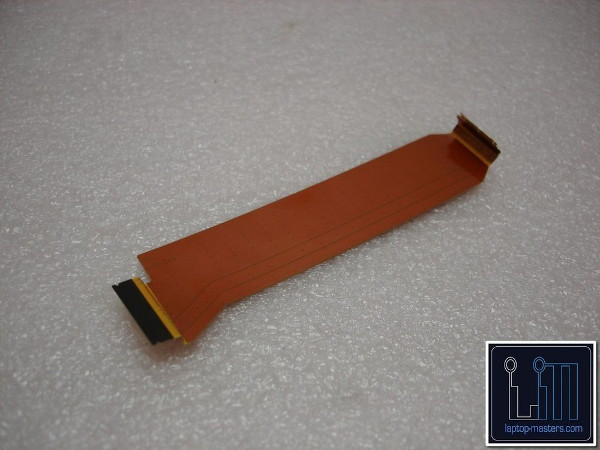

I have similar SSD in my Sony SVZ-13 but bit different "problem". Original ssd died. (computer works like a charm with other ssd)
I would like to use msata ssd in this laptop instead of original, due to ridiculous pricing of original.
What's needed then? Small adapter which has similar LIF-connector used in MZRPC128HACD and msata-female connector in other end. But has anyone made or tried to make this kind of adapter? Or even better, adapted msata connector to the ssd end of original ssd cable.
I know I will loose some of the speed by using only one ssd but I doubt there's enough space for two msata ssd's with adapters?
Could someone make me such an adapter? If so please contact me random_man(a)live.com. Thx in advance!

Unfortunately those that helped resolve the issue above did so through PM's (private messages). I think several other probably have similar items. Anyway I am also looking to adapt a SSD drive to a computer hopefully Sata connections.
Here are some pics of my SSD and cable connection.
The above is a metric ruler so it is in millimeters, or one centimeter.
Terry
