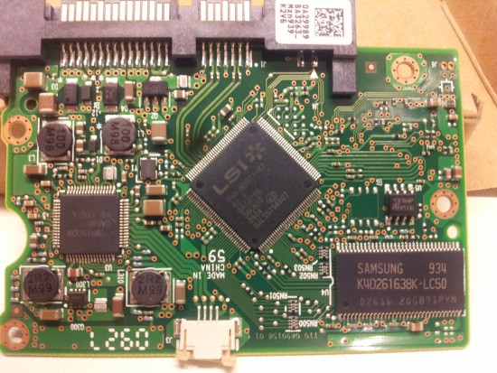

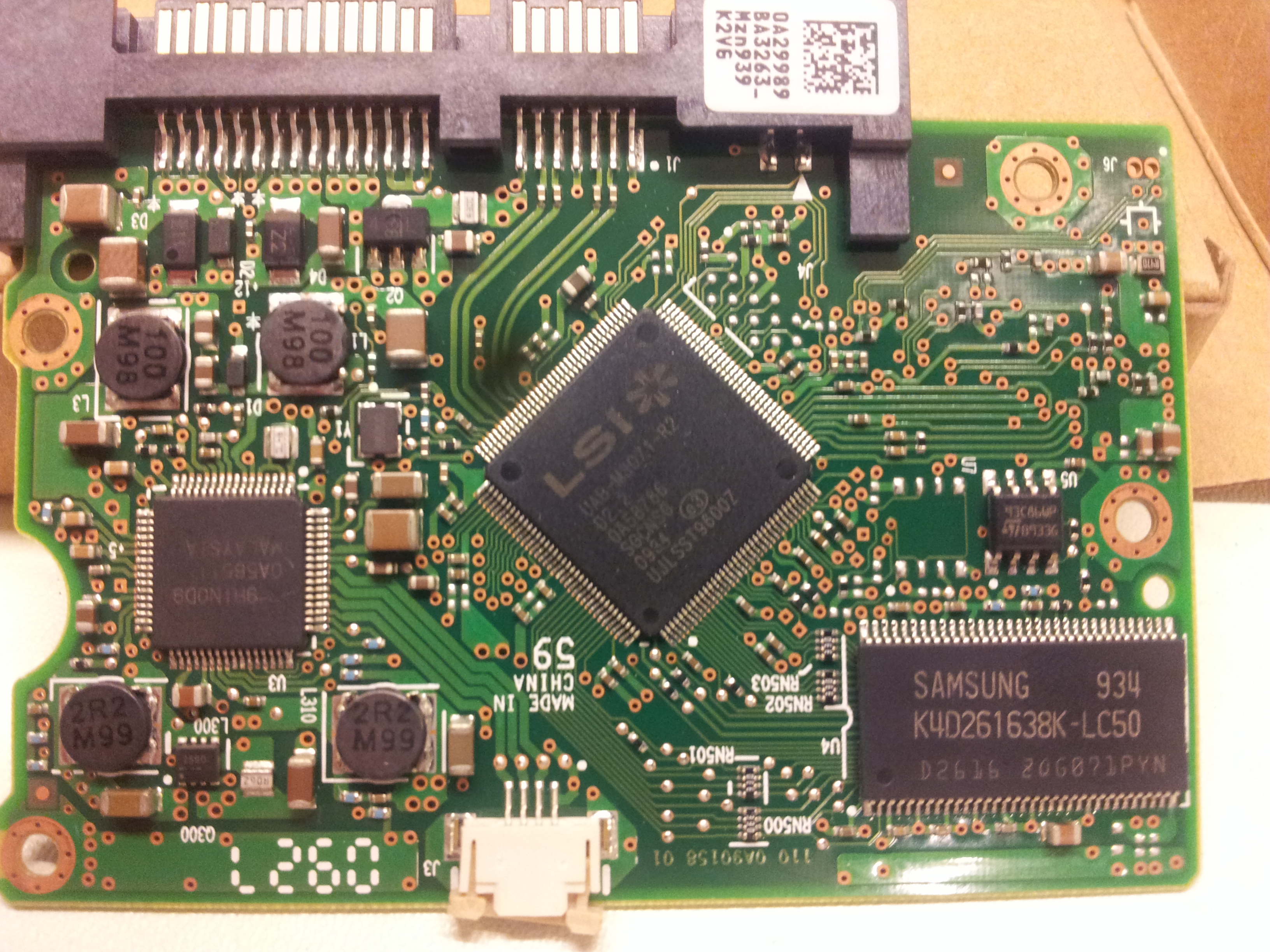

Hey guys, I was wondering if you could help me out with a similar hard drive. I'm trying to fix a hard drive for my brother-in-law. It was his back-up drive for his wife's pictures of their kids. Both their laptop drive and back-up drive died within two weeks of one another, so they would really appreciate it if we could get this working. Basically, the hard drive does nothing at all when hooked up to an external source (an external docking station and hooked up to my desktop). It doesn't power on or register or anything, so I figured I could try a new PCB and see if that does anything.
Here are the drive details:
http://i.imgur.com/aOD3G.jpg
http://i.imgur.com/1xJPT.jpg
So, I did some searching and managed to find a PCB that might work:
http://www.ebay.com/itm/PCB-ONLY-0A2998 ... 8&x=48&y=6
I was wondering if you could look at the information above and tell me if the PCB I linked to would work with this hard drive. Not all of the serial information matches up exactly, but this is the closest I could find. If you think it will work, I'll give it a shot.
Thank you all so much for any help you can provide!

Hey everyone, I was hoping you could help me with a problem. I'm trying to help my brother-in-law with his external backup hard drive. He used it to store all his wife's pics of their kids; the backup drive died within a month of their laptop drive, and they hadn't used the backup to restore the pics.
The external drive does not power up at all. I hooked it up to a new external enclosure, a hard drive dock, and my desktop, and the drive doesn't do anything. I thought trying to replace the PCB might be a good course of action.
Here is the drive information:
I found a PCB on ebay that I thought might work:
Not all the information about the ebay PCB I linked to matches up with the drive information (pictures). I was wondering if you all might take a look at the above information and tell me if it will work. I'm not very knowledgeable about this kind of stuff.
Thank you all for your help!
