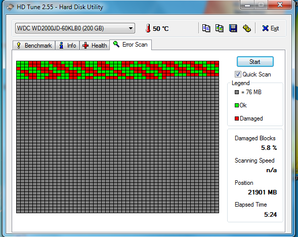

tsted again backup all function and it downloads well the rom and SA modules. all modules are located on head 0...and therefore I could play fine with it till today, not knowing what lies inside :D

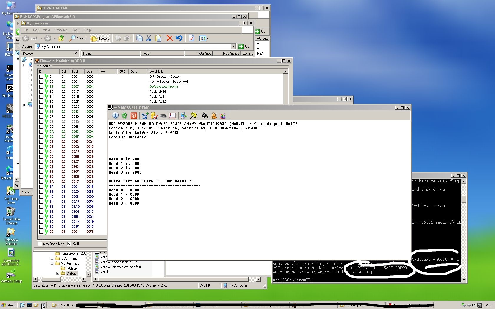

well, since I have formatted the hdd, now it's seen by wingoz. this is a big deal because it tries to access it and f. it. the device must be disabled from device manager, otherwise it will screw your operations!
as I said, the wdr demo or not reports ok on heads tests read...write etc. look in the image at the dos window...my app reporting head 1 down + the error. I'm 100% that the head is dead. I see it during debugging... the error and nothing came up in the read buffer.
more..wdr back-ups the files to a drive and unfortunately it was exactly the one I was working on, the donor. suddenly windows started throwing errors that cannot access that dir created by wdr. to play around..I did a head depop for head 1 and did a reset. then the entire modules list (except mod1) went red..with the error FM...bla bla...like on the other thread. while windows continuing popping messages with "cannot access ...blabla". I did a pc reboot this time, popped back the head and now the SA modules are fine. only that the hdd identifies as something else :lol: while it was WDC WD2000JD now it became WDC WD1200LB . at inspection the rom firmware is heavy changed in mod 47 (SA adaptives), so really I don't understand from where such large modifications and what was touched inside that mod.

wdr3 demo and full too. look at the window's title.
I'll wait for another donor to appear at a decent price on ebay. this one It was sold only to us..that's why I purchased it through a guy which can buy in us ans ship to me. so no doubts that I can do anything at this moment. one with only a letter in DCM slipped through after already placed the order for this one..

ROYL mod traced mode name: 0x0030
ROYL mod traced mode name: 0x000B
ROM dir module traced...
ROYL mod traced mode name: 0x000A
Performing CRC on Flash Module 0x000A
CRC OK.
Performing CRC on Flash Module 0x000B
CRC OK.
Performing CRC on Flash Module 0x0030
CRC OK.
Performing CRC on Flash Module 0x0047
CRC OK.
Performing CRC on Flash Module 0x000D
CRC OK.
Performing CRC on Flash Module 0x004F
CRC OK.firmware, I don't see a method for checking the internal mods.

louis wrote:
it sucks.
Hello louis, i noticed that you have WDR3.0 inside HBCD? you customized your HBCD i guess?
Also about your tool, just for information, do you plan to release it or not?
