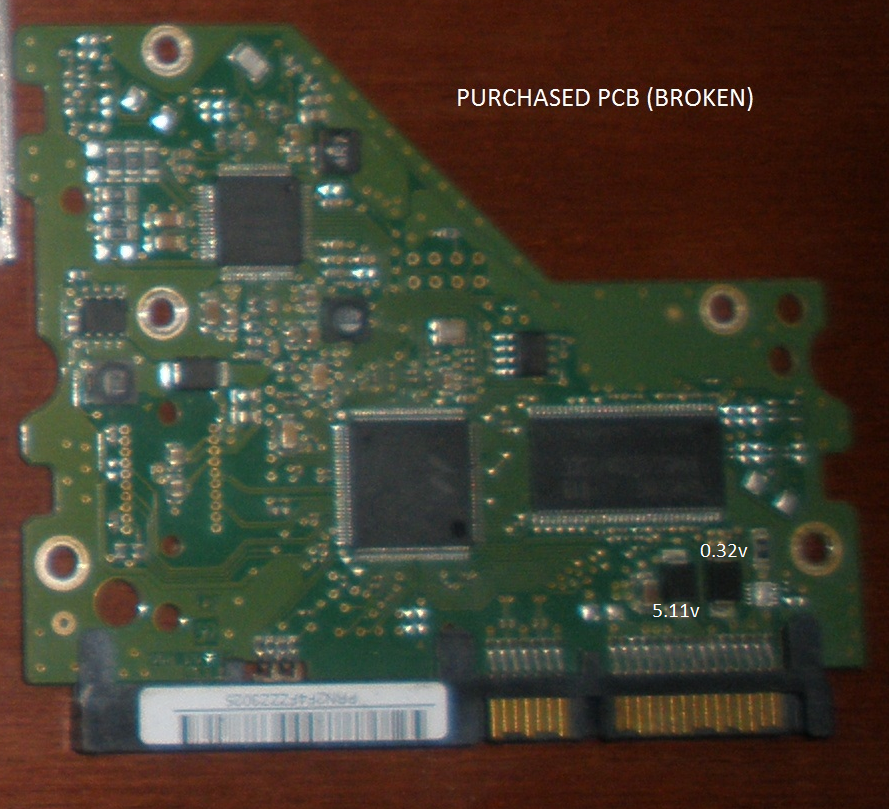

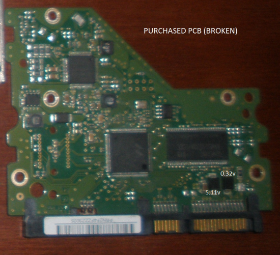

Hi fzkbar and thank you again. I appreciate your help very much.
I measured tvs diodes in the striped side:
Greetings
 Post subject: Re: Samsung HD204UI PCB BF41-00314A 00
PostPosted: May 24th, 2012, 20:14
Joined: May 6th, 2008, 22:53
Posts: 2138
In case fzabkar isn't around, I'll give a brief comment...
Your photo appears to show that the +12V supply is missing on the PCB. There can be multiple possible causes e.g. shorted TVS (but in that case, why hasn't the PSU shutdown the +5V supply?); open fusible resistor, which seems to be in series with the +12V supply; short-circuit on the +12V rail elsewhere on the PCB; faulty PSU; etc. etc. A missing +12V supply would cause all the 3 missing voltages that you confirmed by following the plan from fzabkar. :(
(Providing a better close-up photo of the TVS diodes & nearby components would be helpful IMHO.)
Further diagnosis could be done on the PCB, of course. But if it's a problem on the PCB and not external (which, as we've discussed on another thread, does not necessarily mean that the PCB was faulty when it was dispatched to you), then what are you going to do? If you attempt any repair on that faulty PCB, then you'll likely lose any warranty, but your repair attempt may be unsuccessful (depending on the actual cause and diagnosis process). I thought you were negotiating to send that PCB back to the supplier?
Anyway, those are my thoughts - use them (at your own risk) or ignore them, whichever you want to do :)
http://www.users.on.net/~fzabkar/HDD/HD204UI_TVS.jpg
I'm a curious person. I like to learn, and i only want to test what in my first post i was telling: that the PCB i bought was faulty. Of course i am not idiot and i don't want to attempt fix it the PCB that i bought. I have not the knowledge nor the skills to do it. As i said before i'm sysadmin. Neither want to harm the reputation of anyone as long the problem THAT I NO CAUSED can be solved. And of course i will tell here and in the other thread if the company send me a good PCB.
I repeat my only intention is to solve my problem.
The first thing you should do is to measure the resistance of the 12V TVS diode. Set your meter on the 200 ohms range. If the problem is indeed as Vulcan and I suspect, then there will probably be an easy, no-cost DIY fix. And from your initial post it is clear that you already have all the necessary tools.
BTW, to see just how damaging libel can be, read this thread:
seagate-barracude-drive-clicking-and-not-detected-bios-t22956-20.html
First, i want to say sorry if i bothered anyone, and to Vulcan. Hi fazabkar thanks to you and northwind and all of you of this great forum.
In the pcb i bought in the tvs diode with the com of the multimeter in the striped side measures continuity but is not a stable measure, later goes to 1 ohm. With the com in the opposite side of the tvs there is not continuity (1). I suppose the right thing is to measure it with the diode removed from the pcb but i'm going to give back the pcb to the supplier.
I also measured the removed tvs diode from the pcb of my broken HDD: 0.662 in both sides.
