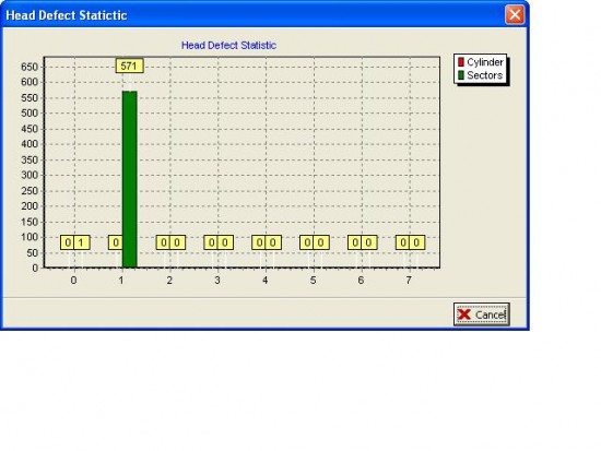

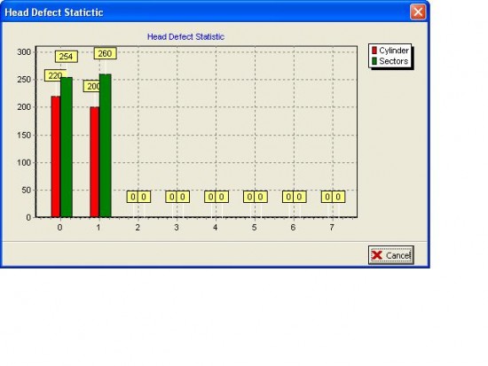

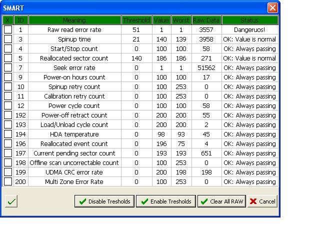

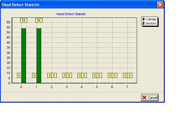

michael chiklis wrote:
Bad news is you can not fix it by yourself, you really need a profi help.
I think that the disk has a problem with the mechanical positioning system(heads) and therefore is so slow.
The problem not related to heads anyway.
Good luck.
 Post subject: Re: WD5000AAKX-001CAO Caviar Blue slow sectors issue
PostPosted: August 10th, 2012, 5:25
Posts: 1744
Location: Verona, Italy
I checked al modules, SeDiv at end says "All module OK"

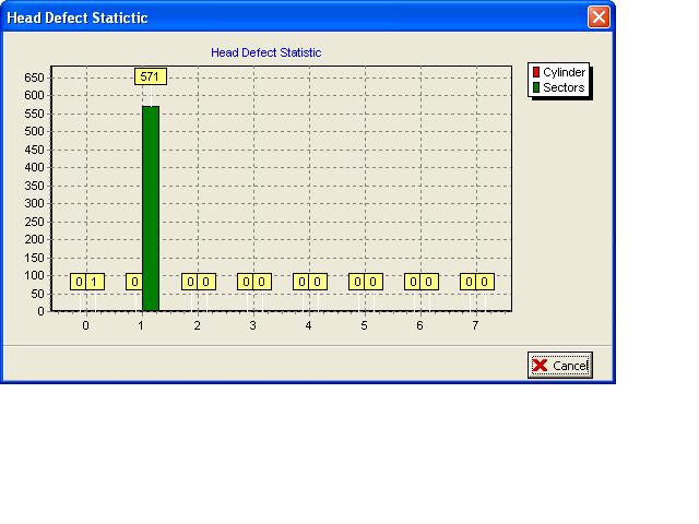

Other test:
File comment: G-list 572 defect list entries
File comment: P-List 934 Defect list entries
File comment: T-List 108 defect list entries

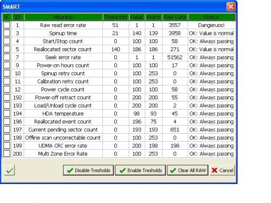

File comment: SMART

I did some other test on cylinders.
All cylinder in head "0" are good.
But on head "1" i get error on cylinder from -1 to -133
and from -172 to -197
Idea?
