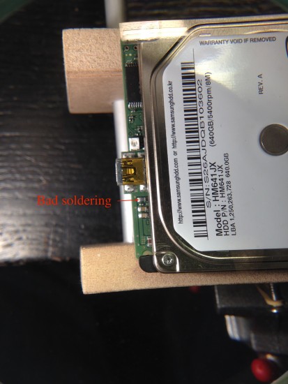

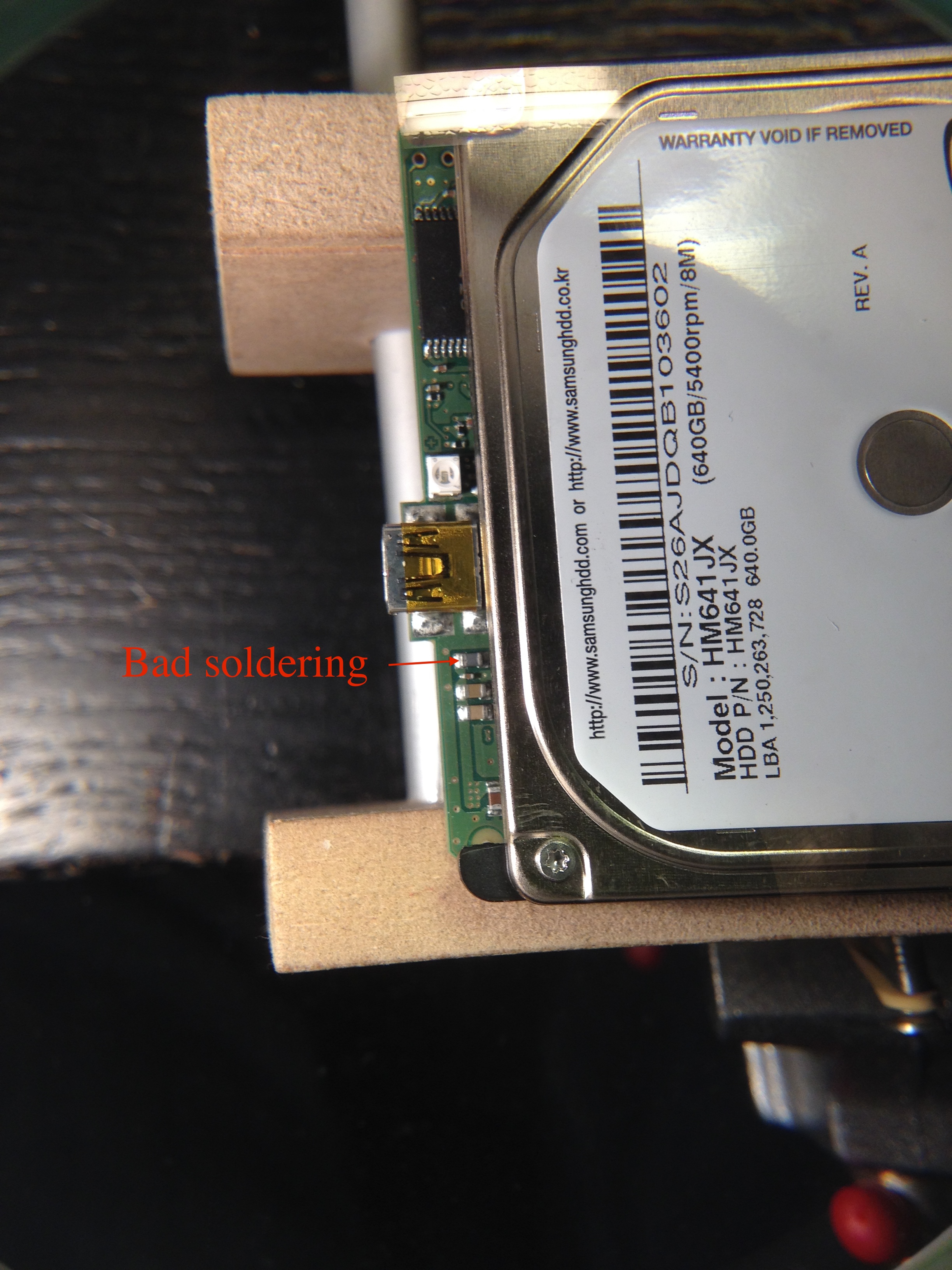

+1 on a HM641JX Samsung but no damage to the USB connector and never dropped.

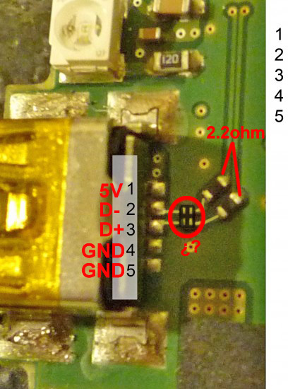

Hi, i have the same hdd with the same problem! At first instance, hdd not detected, not spining, not led light.
After resolder usb connector and the mentioned chip inductor led light turn on and hdd spin up, but not detected mass storage device neither usb interface, there is not any signal of data TX RX.
I am suspecting about smd network component connected to data D- and D+ lines in series with 2 ohm resistor to usb bridge. Please, see circled component at bottom image.
This is a black smd network component, so i am thinking in network resistors or inductors and not in capacitors. But resistance value give me around 1.5 Mega, i think this is too high, practically open.
Can somebody point what it is this component?
thanks in advance,
Oleg.
File comment: Need to know about this component

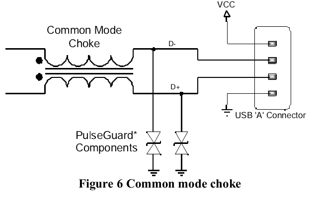

That component looks like a common mode EMI suppression choke.
High Speed USB Platform Design Guidelines:
http://www.usb.org/developers/docs/hs_usb_pdg_r1_0.pdf
BTW, if you are getting nothing from the serial terminal port, then that's another problem. Have you checked the Tx/Rx LVTTL signal levels?

Well, Common mode shoke in figure you shown should have continuity between in-out points (because after remove it from pcb traces are interrupted), in my case it is open, that´s why i thinking it broken, i will replace it with a 0 ohm resistor and probe.
thanks very much.
