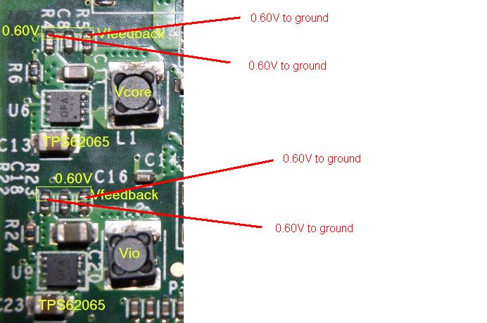

hhddrec wrote:
L1=0,97V
L1=2,79V
about other voltages
Fuse pins to ground = 4,9V
JTAG P1 to ground = 3,22V
I presume the two L1 readings actually refer to L1 and L2. If so, then the 2.79V reading must be the supply for the NAND flash array, and 0.97V must be the Vcore supply for the SandForce controller.
If so, then the JTAG supply must be coming from some other IC, possibly U3 near the SATA power input (or U22).
In any case, 2.79V is too low for the NAND array. My searching suggests that the OCZ M2502128T048AX22 NAND flash parts are rebadged Micron MT29F128G08CFAAAWP chips. These are 3.3V, 128Gb, 16G x 8 parts.
If this measurement is correct, and if my analysis is correct, then the POWR607 chip is probably holding the SF-1222TA3-SBH controller in a reset state.
Can you tell me the markings on U3 and U4?
Could you also measure the resistances of R4, R5, R22, and R23? These will allow us to calculate the correct supply voltages for the "OFA" regulators.
About Vol, sorry you was on true
L1=0,97V
L2=2,79V

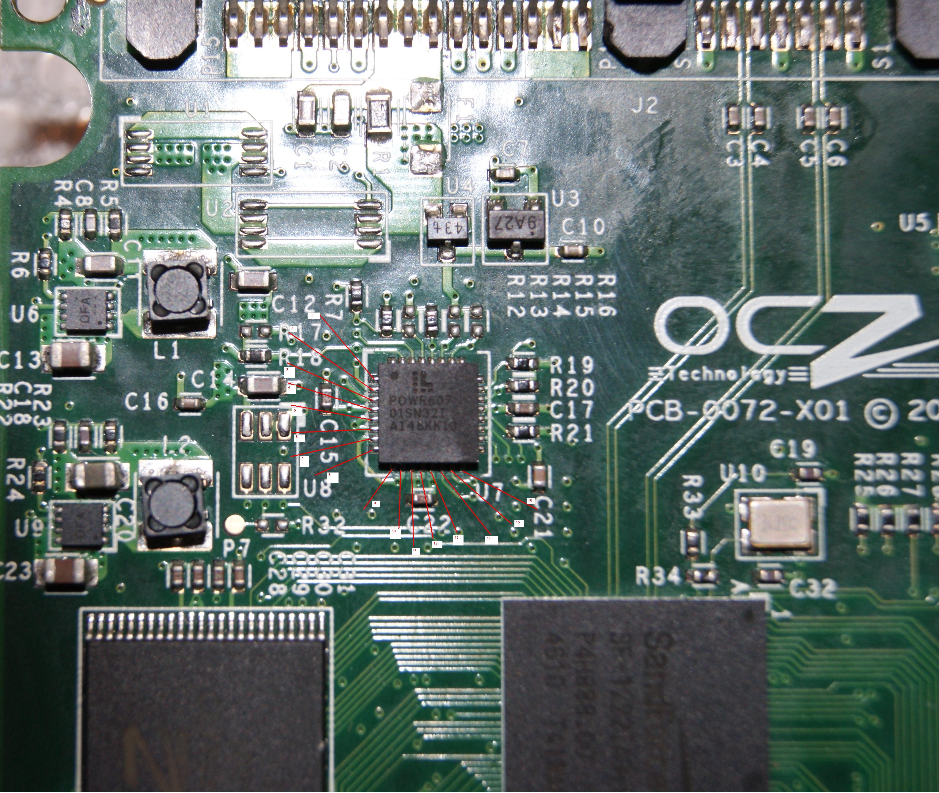

Info about IC
IC at U7
POWR607
01SN321
A146KK10
Info about U22 IC
F
PB98F
FDS
6898A
markings on U3 (I think now you can see it in atached new picture)
9A27
markings on U4 (I think now you can see it in atached new picture)
43t
measure the resistances of R4, R5, R22, and R23 (Measured inside PCB not out of PCB)
R4
71.3 x 200k Ohm
14.260 OHM
R5
71.8 x 200k Ohm
14360 OHM
R22
107 x 200k Ohm
21.400 OHM
R23
400 x2000K Ohm (but increasing measure to infinit)
800.000 OHM (but increasing measure to infinit)
I'm a bit concerned about the "stuff" in the top right corner of the IC. It could be a manufacturing mark (the IC is in-circuit programmable), but I'm not sure.
About stuff , i was cleanig but not sure about it. I think metalic ink mark from factory
About POWR607 Pinout i am not sure if you can see new atached PIC, can you repeat me about testing pinout.
witch pins you want to test voltage?
in this case we can add more power to recover data?

Fig 26 on page 17 of the TPS62065 datasheet shows a typical configuration.
The output voltage is given by ...
Vout = Vref x (1 + R1/R2)
... where Vref = 0.60V
In the L1 case ...
Vout = Vref x (1 + R5 / R4) = 0.6 x (1 + 71.8 / 71.3) = 1.20V
For L2 ...
Vout = 0.6 x (1 + R23 / R22) = 0.6 x (1 + 400 / 107) = 2.84V
Neither of these numbers feels right. The resistances are difficult to measure in-circuit because they are high enough to be influenced by the resistances of the respective loads. Therefore I wouldn't place too much faith in these calculations except to say that they are in the ballpark.
Your temperature measurements seem OK to me. I would have thought that, if a bad controller or NAND flash IC were responsible for any droop in the supply, then it should be very hot to the touch.
The pinout you have marked out for the POWR607 is correct. That said, I would refrain from measuring the voltages right at the pins of the IC since a slip of the probes will probably destroy the board. Instead I would probe the less "busy" areas.
The JTAG pins are probably associated with the POWR607. They would be used at manufacturing time to program the IC. I suspect that the "stuff" on the chip may be a marker to indicate that the chip has been programmed.

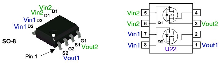

U22 is a FDS6898A dual MOSFET.
FDS6898A, Fairchild, Dual N-Channel Logic Level PWM Optimized PowerTrench MOSFET:
http://datasheet.octopart.com/FDS6898A- ... -46434.pdf
U22 appears to be operating as a power switch. Each of its drain pins are connected to Vcore and Vio. The POWR607 has two high voltage outputs. I suspect that these are used to switch the gates of the two MOSFETs. If you could measure the voltages on pins #1 and 3, then this should tell us whether the MOSFETs are switched on. Pins #5 - 8 will be the inputs.
It appears that the 3.3V JTAG supply, and the Vcc supply on pins #4 and #21 of the POWR607, may be provided by U3 (9A27). I haven't been able to identify this chip, but I suspect that it may be an LDO regulator. If you could measure the voltages on each of its pins, then that might help to identify it.
The bottom line is that the Vio voltage (2.8V) still doesn't look right, but I'm wondering if that is indeed the correct voltage. One way to determine whether the "OFA" chips are regulating correctly would be to measure the feedback voltages at the junctions of R4 and R5, and R22 and R23. This voltage should be 0.60V.

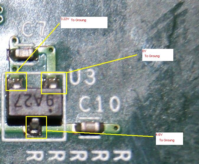

U22
Betwein pins #1 and 3 = 1.82V
Betwein pins #5 - 8 = 1.82V too
About U3 Regulator measures to Ground i atach pic
voltages at the junctions of R4 and R5 (betwen)
None V
voltages at the junctions of R22 and R23 (betwen)
None V
strange

You've measured the wrong voltages at U22, but in any case they are OK. I was wanting to see the voltages with respect to SATA ground, not with respect to each other. As you can see, U22 consists of two MOSFETs. Each MOSFET switches Vin to Vout. Vin and Vout are the Vcore and Vio inputs and outputs. If each switch is working correctly, then Vin = Vout.
U3 is indeed an LDO 3.3V regulator. It provides the supply for the POWR607.
The R4/R5 and R23/R22 junction readings are very strange. It's as if the FB (FeedBack) pin were sitting at ground. Are you using SATA ground as your ground reference for measurements? If not, have you been using pin #4 of the "OFA" chips as your ground. If so, then this would explain why Vio is reading approximately 0.6V lower than it should be.
sorry for inconvenience i have done bad measures i two cases, bada measures in U22 and bad measures in R(nº).
i'll do other measures.
about U22
1 t ground 0,98v
3 t ground 2,81v
5 t ground 2,81v
8 t ground 0,98v
about R(nº) see pic

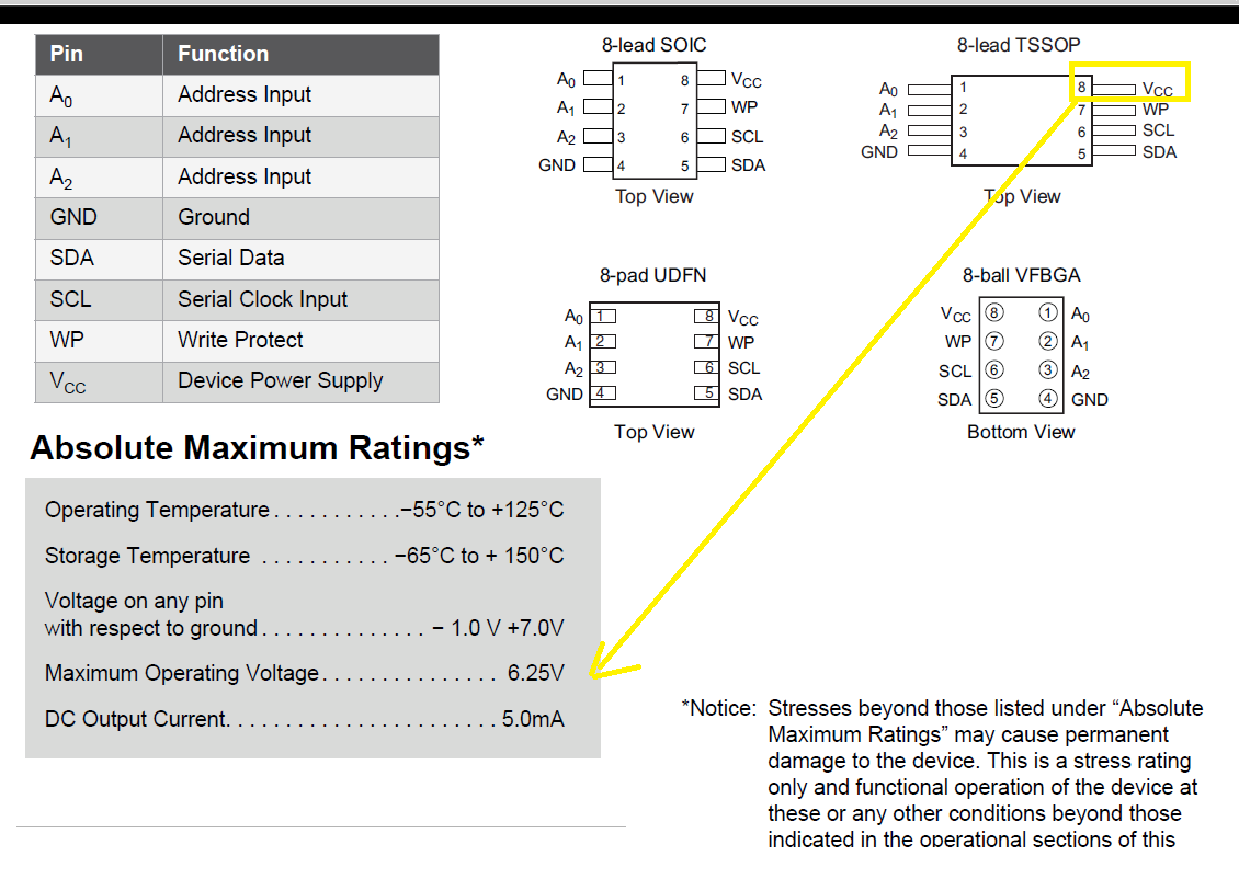

hhddrec, do you have another (similar to it) SSD OCZ drive?
If you do, then what voltage for NAND chips it is provide? Can you measure it?
And, what exactly written on U5 chip? Is it SPI flash?
If it is, then, do you have a SPI programmer to read it?
If you do, then it is possible to try to analize a dump from it.
But again, chances to get data are low, it is difficult case.
 Post subject: Re: OCZ Vertex 2 240GB SSD for recovery
PostPosted: April 9th, 2013, 13:21
Posts: 811
Location: World
Hi Randy,
Thanks for your news
Info about U5
ATH130
2ECL 8
186931P
PostPosted: April 9th, 2013, 14:12
Joined: September 28th, 2005, 8:56
Posts: 22
Location: Krasnoyarsk, Russia
It's not a SPI flash IC. Seems it's ATMEL 256 Kbit EEPROM.
Datasheet: http://www.atmel.com/Images/doc8568.pdf
I doubt, that it contains a firmware code. Most likely, it contains some firmware constants, working data, smart data, counters etc. But i may be wrong.
If you'll be able to make a dump, then we can see, what inside. And make suggestions, what it is.
fzabkar has done a good analisys, and i suggest to you first follow his instructions. At least, to make sure, what NAND array is powered with correct voltage.
Even if U5 is just a some kind of configuration storage, because of power failure (if), it may contain now a "garbage".
Make sure also, that U5 is also powered with correct voltage.
Good suggestions
yes the best analisys, thanks Frank
I think measure here. What you think?
see picture
