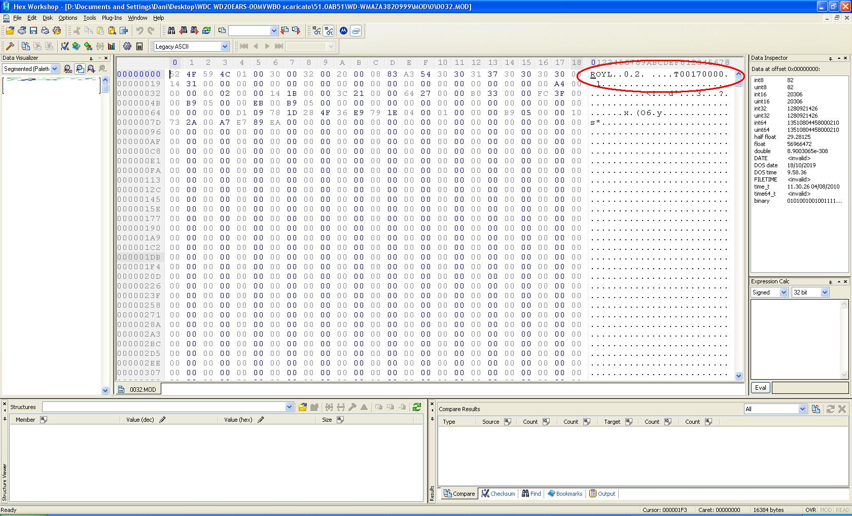

FWIW, MOD 107 doesn't exist in the following resource dump:
http://www.datadonor.net/HD%20Western%2 ... 0MVWB0.rar
Other MODs such as 102, 104, 105 are "NOT_INIT", so they don't appear to be necessary.

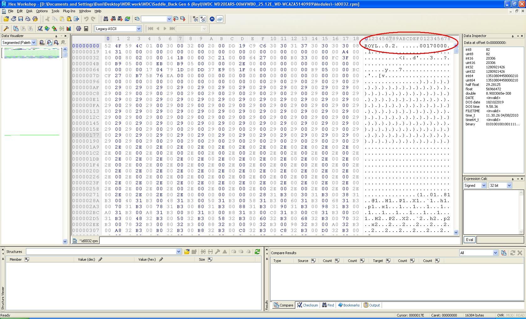

Bytes 0x04 - 0x07 appear to be 01 00 1E 00 in the SA and 04 00 1E 00 in the ROM. Maybe that part of the header needs to be edited, too. ???
I downloaded the resource dump linked by "fzabkar" and i took from it module 32 and i wrote into my drive, then i did fast p-list translator recalculation.
Now the drive is faster in mhdd scan and is detect faster also in bios, but i still have the stop issue after few seconds (anywhere in the drive)

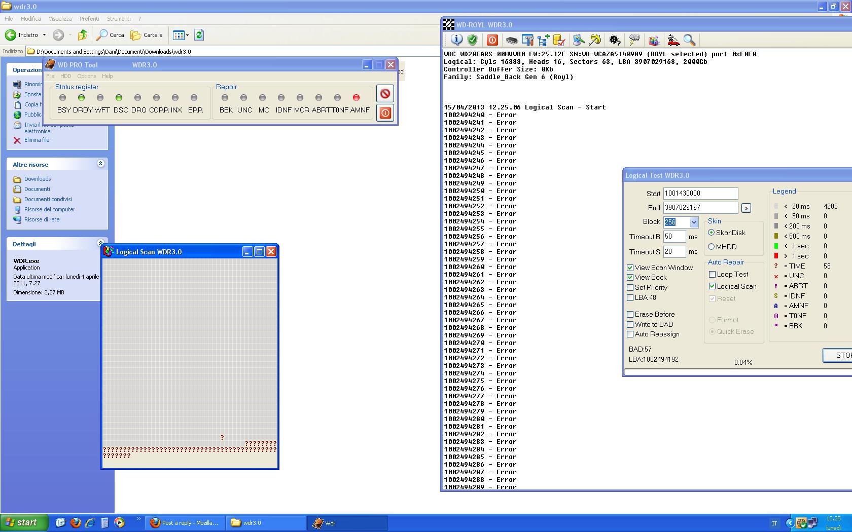

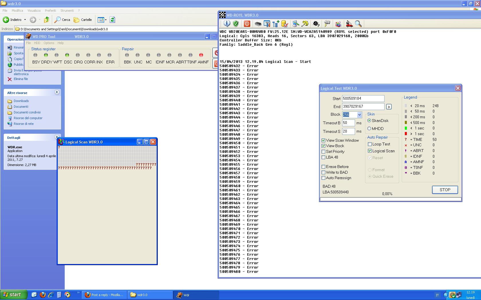

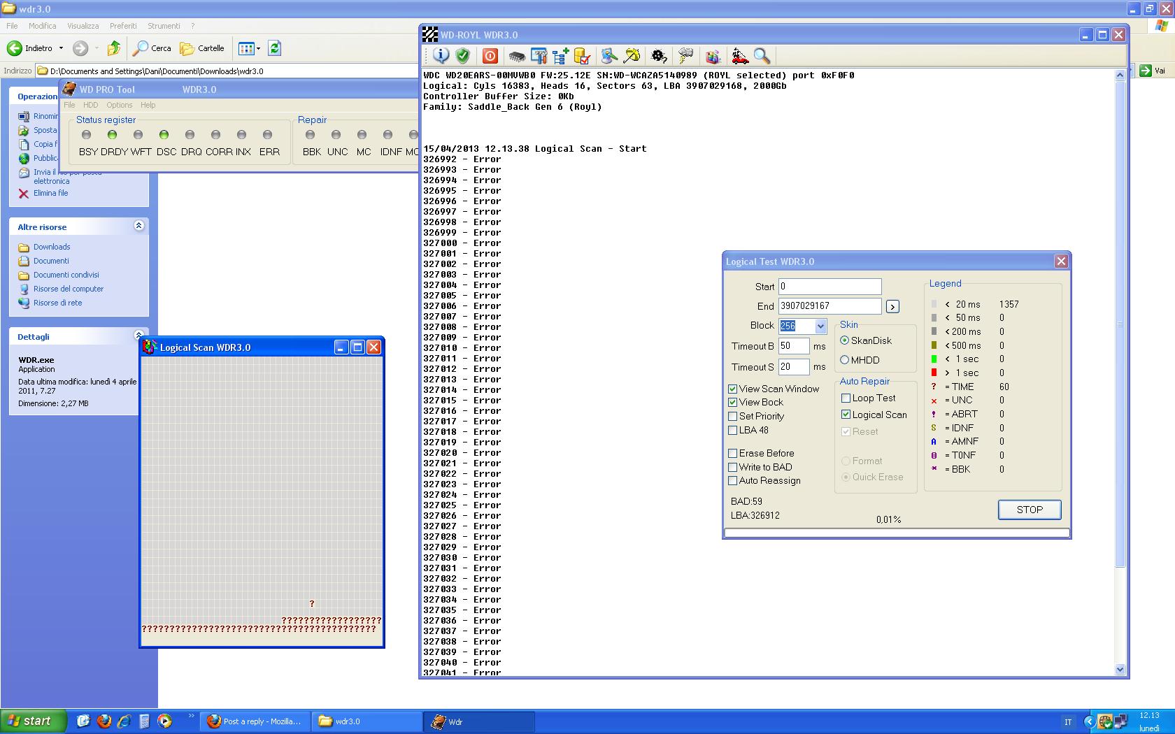

I did a test also with option "logical scan" in WDR.
As you can see i get all "?" after few good sectors.
Example from LBA 0:
I get all "?" from lba 326.992

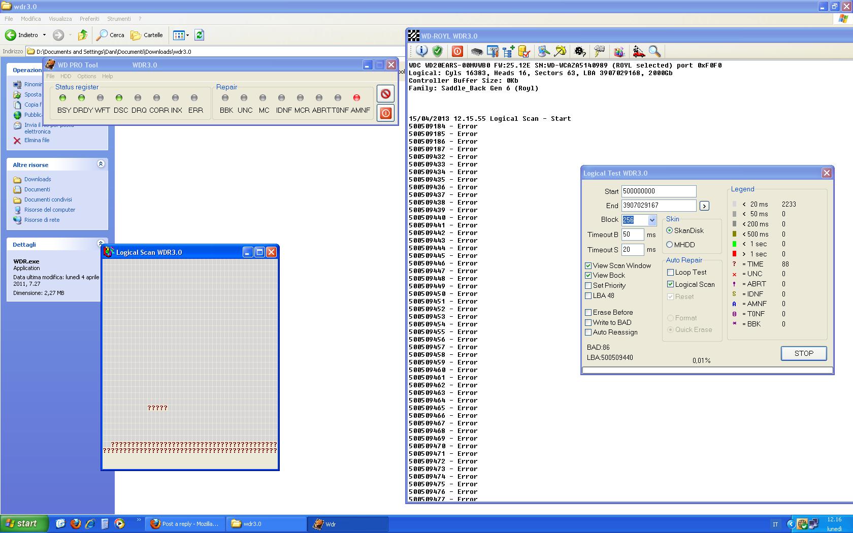

Another example from LBA 500.000.000:
I get all "?" from lba 500.509.184
If i begin scan since lba 500.509.000, i get all "?" from lba 500.509.432

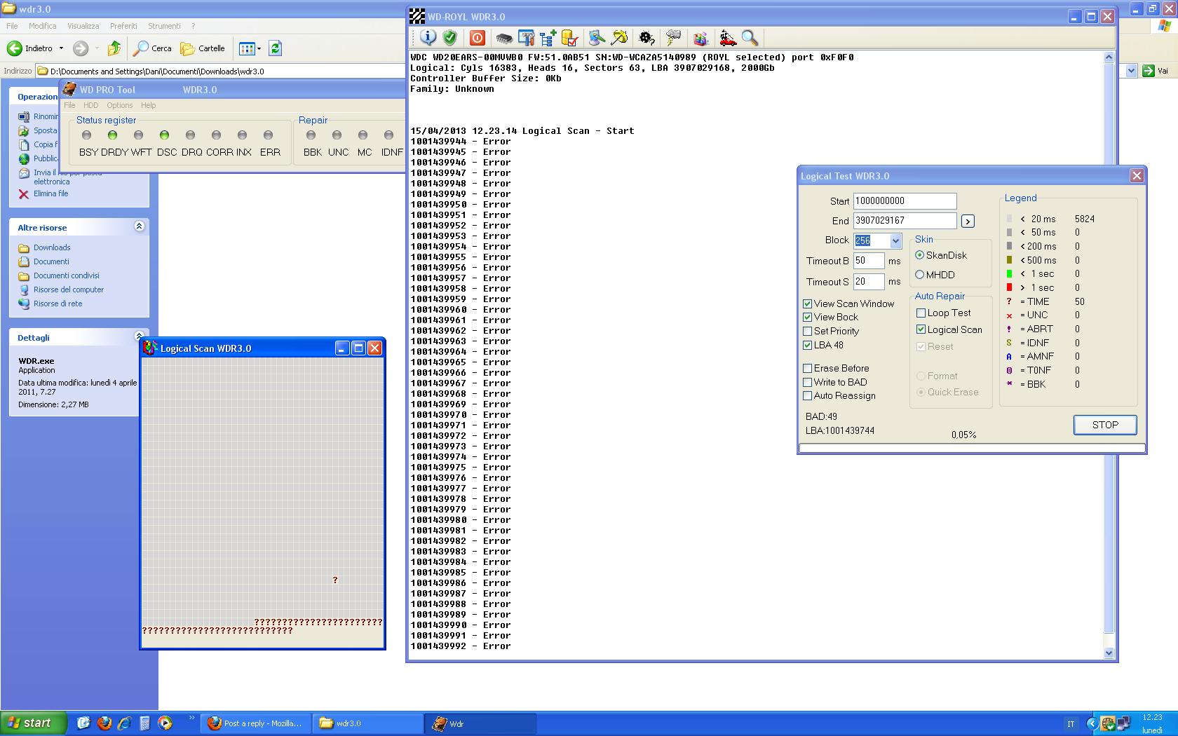

One more example, from lba 1.000.000.000:
I get all "?" from lba 1.001.439.944
If i begin scan since lba 1.001.430.000, i get all "?" from lba 1.002.494.240
This means that they are not really bad sectors, maybe still translator issue?
I guess the module 32 is clean now, but something more should be fix, any idea?

I downloaded the resource dump linked by "fzabkar" and i took from it module 32 and i wrote into my drive ...
I don't know why you did this, but did you match the MOD version?
 Post subject: Re: Need firmware for pc3k WDC WD20EARS-00MVWB0 25.12E
PostPosted: April 15th, 2013, 9:41
The drive has at least one bad head
PostPosted: April 15th, 2013, 9:56
Posts: 17323
I notice that in the SMART report the Current Pending Sectors attribute has a worst normalised value of 1. This suggests that at one time there were several thousand pending sectors but these have since been returned to service. Sounds like an intermittent fault to me ...
PostPosted: April 15th, 2013, 10:09
Posts: 1768
Location: Verona, Italy
Yes MOD version is the same
My original mod 32:
mod 32 resource dump:

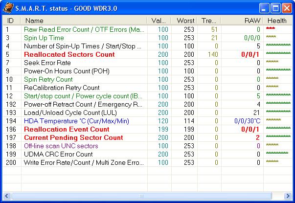

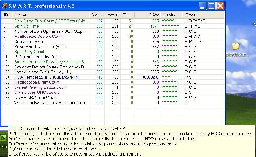

Could it be a smart issue?
It's possible to disable smart in WDR 3.0?
This was the original smart status:
Smart status now:
My firmware database:
PostPosted: April 15th, 2013, 10:36
Posts: 17323
SMART isn't the reason for your problems. SMART is merely reporting the problems.
AISI, the Raw Read Error Rate, Seek Error Rate, and Current Pending Sectors were clues that the drive had a head fault. Your defect list pointed to head 4, but subsequent testing hinted at head 1.
Your latest SMART results are typical of a new drive which has not yet recorded sufficient activity in order for the SMART data to be statistically significant. That's why you see a lot of "253" values.
