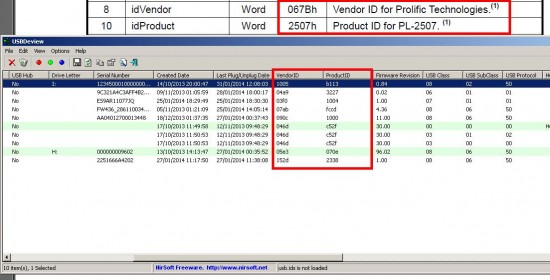

Looks like no dice on the eeprom short :
Where do we go from here?
Thanks for your continued interest and advice.
 Post subject: Re: USB-IDE Bridge Fail - old Freecom External : HW encrypti
PostPosted: February 1st, 2014, 19:56
Posts: 17328
I don't use USBDeview, so I'm not certain that I fully understand its output.
The device with VID/PID = 07AB/FCCD is a "FREECOM Classic HD 160GB". It has a "Last Plug / Unplug Date" of Jan 25, 2014. Therefore I'm wondering whether the device list is just a registry dump rather than a report of the currently connected devices. Instead I use Microsoft's UVCView which reports the currently connected USB hardware.
In any case it does appear that no USB device has been detected since January 31, so the Prolific bridge does appear to be brain dead. The next thing to test would be the 12MHz crystal. I have an oscilloscope, but I suspect that you might not.
My understanding is that the green entries are current. Any others are just historical.
I have a 1940s oscilloscope - valves and all - but I suspect the caps would need replacing as a min, so yeah, you suspect right. I guess I'm right in saying that w/o CLK edges the PL-2507 will look as dead as a dead PL-2507, no?
Also, I had no IDE drive connected during these eeprom short tests: just thought I might mention this on the off chance you believe it might make a difference - can't see it myself, by what do I know?
