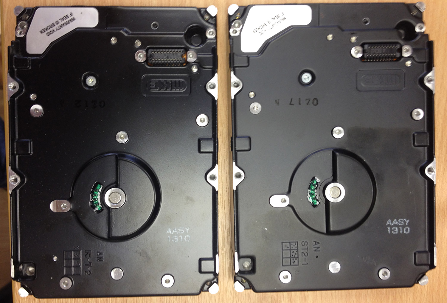

Still want pics of both bottoms of HDD's :)
Don't worry, I hadn't forgotten you! Donor is on the left.

I'm guessing that the following sequence corresponds to a head calibration process beginning with head #0 and ending with head #5. ISTM that the drive tests for the presence of 6 heads and detects only 3 (heads #1, 2, and 3). A calibration test result is reported for each of the discovered heads (71, 7E, 80).
recalStep 0005
recalStep 0005 71
recalStep 0005 7E
recalStep 0005 80
recalStep 0005
recalStep 0005
recalStep 0007
HdMap 0E
This makes sense now that the comparison can be made with the same section in the working drive's output:
recalStep 0005 93
recalStep 0005 A4
recalStep 0005 92
recalStep 0005 93
recalStep 0005 8A
recalStep 0005 92
recalStep 0007
HdMap 3F

So 3F = 00111111
From memory I think the values against each step is the head BIAS.
I will check if I can find a good sample

"The third symbol of the serial number [of Quantum Plus AS] shows the quantity of installed and being used heads":
http://hddguru.com/articles/2006.02.17- ... k-Q-and-A/

Wouldn't the OP's results suggest that the 3 missing heads may have been physically destroyed such as in a head crash, or perhaps there are bad connections at the preamp on the headstack? In the case of the latter, might it be possible to overcome the bad connection by orienting the drive vertically so that the preamp is pressed against the flex lead by its own weight???
In any case, the 3 missing heads appear to be open circuit, IIUC.

0-4-5 head duff and that would make sense as it tried copy 1 (HD 1)
That's just a calculated guess :)

ABC of data recovery : Quantum AS drives.... (nostalgia mood on)
1) AS the PCB was died some damage to the headstack was possible. In that case,
2) You cannot straightforward do a headswap and expect success. 1 out of 200 donors can work and also maybe partially. Forget it.
3) If you really have one bad head, it is still not game over. Unless there is a crash going on inside the HDA. But you have to know how AS work and how the FW is structured, and most of all, have something to communicate with the drive (with a working PCB of course). Oh, and don't rely on copies on heads different from H0... :mrgreen: ...
Note before I receive PMs that I hardly read now : have a working solution for data recovery on Quantums and MX740 - that are Quantum Maxtors - with bad heads, but the cost for this kind of recovery is very high. So please don't ask me anything about it.
