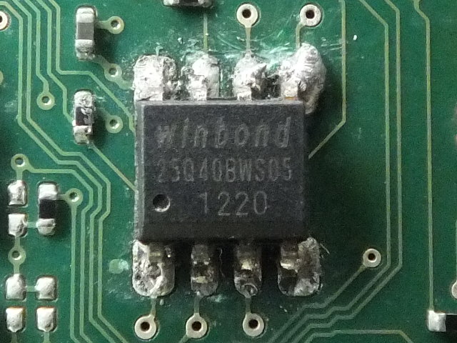

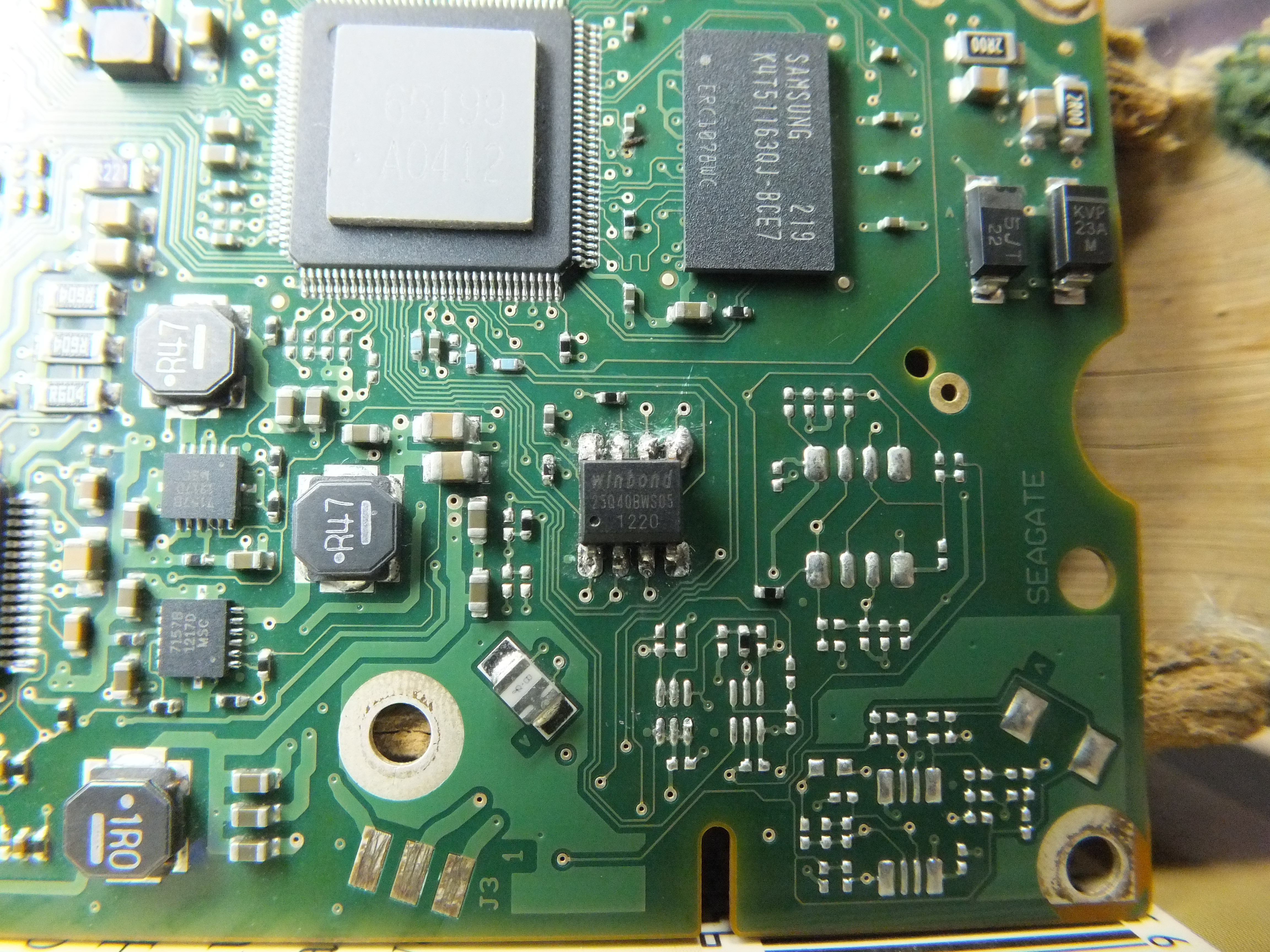

the macro pics of my new PCB donor with eeprom.
thanks
 Post subject: Re: seagate 2GB st2000dm001 dead
PostPosted: August 21st, 2014, 19:51
Posts: 17323
Something looks wrong.
Apart from the extremely bad soldering job, the date codes on the donor PCB's ICs (1217, 1219) are a closer match for the date code on the ROM (1220) than the date codes on the patient PCB's ICs (1228, 1224).
Do you have the donor's ROM IC?

ICs typically have YYWW or YWW (Year / Week) date codes. For example, "1228" means that the IC was manufactured during the 28th week of 2012. The range of date codes is not great (1220 versus 1228, ie 8 weeks difference), and normally I wouldn't be bothered about it, but in your case there is a legitimate concern as to whether the ROM is original. Many manufacturers have a "just in time" philosophy which means that they don't hold parts in stock for very long, so one would expect that the date codes would be closely matched. This "anomaly" is something that I would investigate, but I wouldn't be surprised if everything turns out to be OK.

I confirm that this is a very bad soldering job.
You need a better technician, who did this job doesn't have enough skills with SMD soldering!
I can do this job for you, hoping that the rom chip is not damaged.
ok, thanks but my old PCB had eeprom 1220 and ICs 1228 and 1224. The donor has 1217 and 1219.
It seems that donor PCB was built before, according to the explanation of fzabkar.
thanks+

Anelito send me his drive
This is terminal log:
Flash boot code checksum failure!
SEA4 Boot ROM 2.0 (05/03/2010)
Copyright Seagate  2010
Not able to read the rom on board with my eprom programmer.
If i try to read it via terminal boot mode i get all 0000
I unsoldered the rom chip and i was able to read the content with my eprom programmer (if rom is outside the pcb it's possible to read it).

The ROM code would suggest that it should be a 256KB chip. However, your ROM dump is 512KB. The second half of the ROM is a copy of the first half, so it appears that the wrong chip has been selected. ISTR that you had a similar identification problem with your programmer once before.
