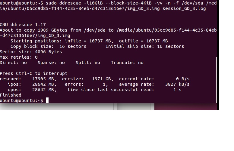

after jermy help i have avg. speed 4000kB/s but still after some time disk stop be accesable - ddrescue stop revocer , fast count errorzise and finsih.
i must go to termianl /1 N1 -clear smart and can contionue recover.
Anny ideas?

when disk hung on terminal i have this output :
F3 T>
