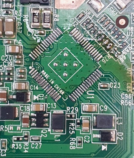

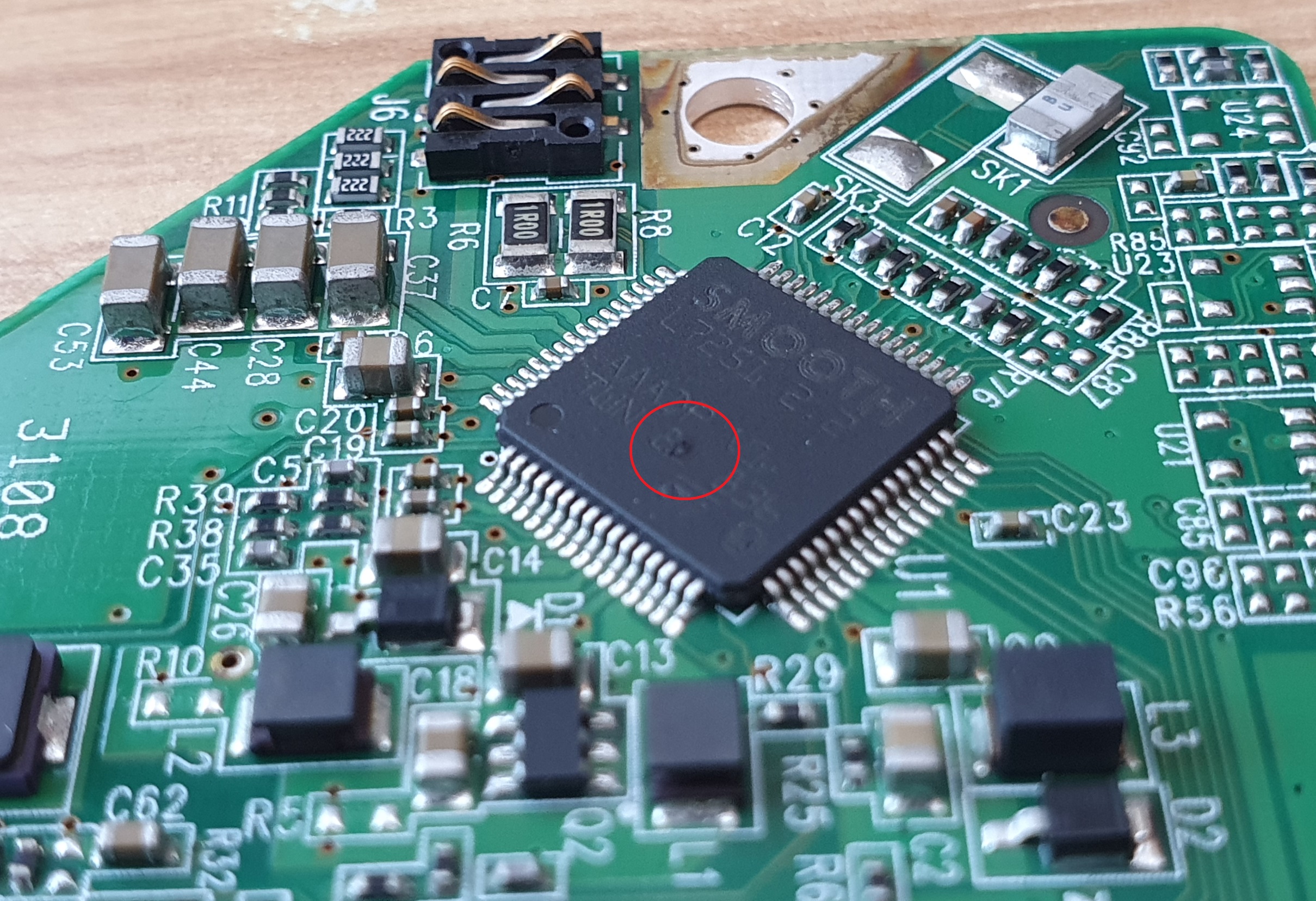

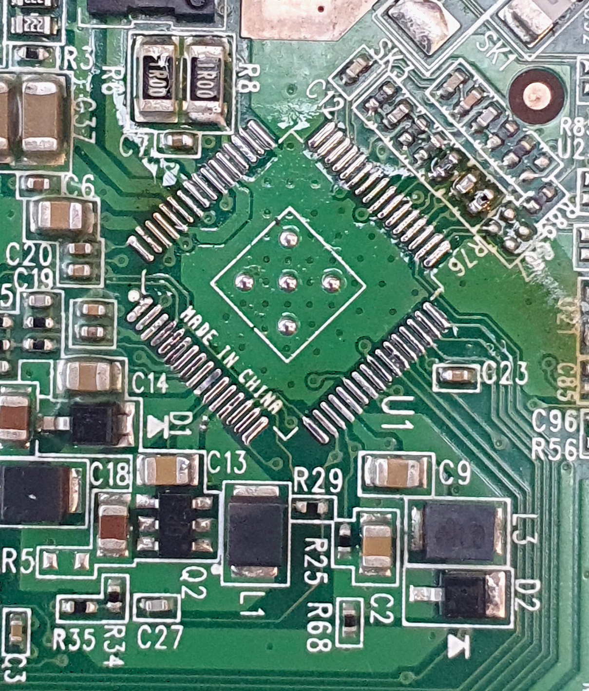

Hello All and fzabkar!
I would like to continue this topic, as i have also two dead WD HDDs with fried Smooth chips.
Would someone please be able to provide a pdf for the L7251? there is one easily available for the L7250, but not the 7251.
I want to find out what voltages should be at the test points.
PCBs are the following: 2060-701537-004 rev A
One smooth chip is clearly blown.
Checking the capacitors around the Smooth chips shows that both are shorted.
Spindle motor connectors U V W are all shorted to the ground.
How big is the chance , that main controller is also fried?
Is it even worth to try and replace the smooth chip in the first place?
ROM is located in the 88i8845C-DHG2 controller, so if its fried also then PCB swap is the only option i guess.

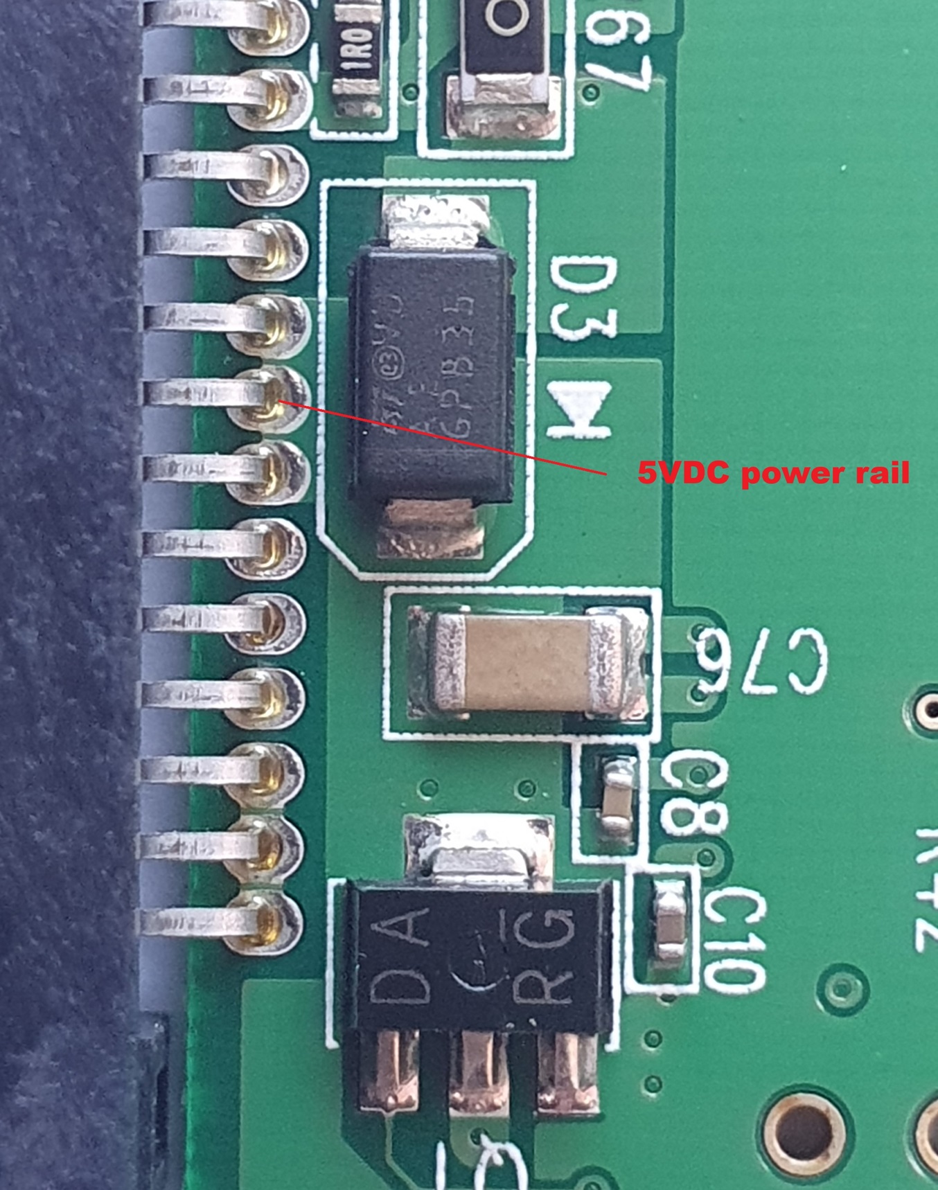

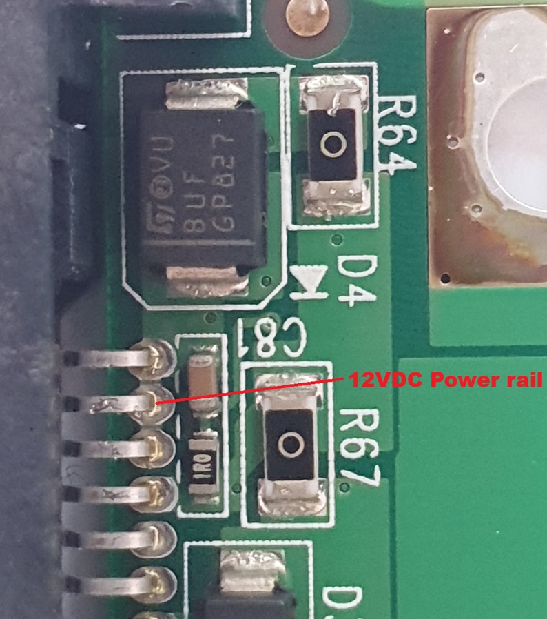

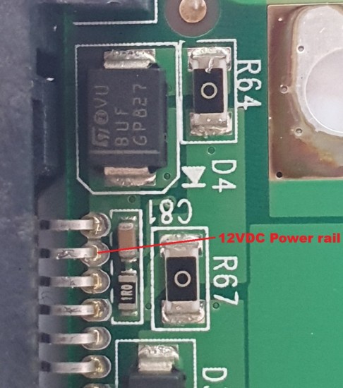

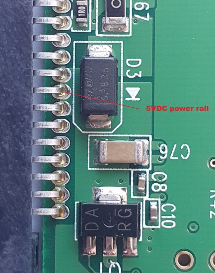

The preamp gets its +5V supply from the SATA connector, often via a small inductor (for noise filtering). Its negative supply (-5V) comes from an inverting buck regulator powered from the +5V supply, and with PWM control coming from the motor controller.
I was really amazed to find out there are no actual fuses on the 5VDC and 12VDC power rails :shock:
Would be a common sense to place two simple fast acting fuses, but no.... There are no fuses at all!
I suspect that the two power rails got shorted together at some point, and 5V power rail received 12 volts, in my case, since two HDDs died at the same time.
These two protective diodes can do very little really.
 Post subject: Re: Fried Smooth L7251 controller, possibly fried board WD 7
PostPosted: October 30th, 2025, 12:43
Posts: 4779
there are but some stupid engineer placed them wrong, they actually protect the TVSes instead of the circuit...
if the drives got 12V on the 5V rail, preamp is almost surely toast, so it needs to be properly diagnosed and probably requires head swap in addition to pcb swap... with all the hassle adding to these.

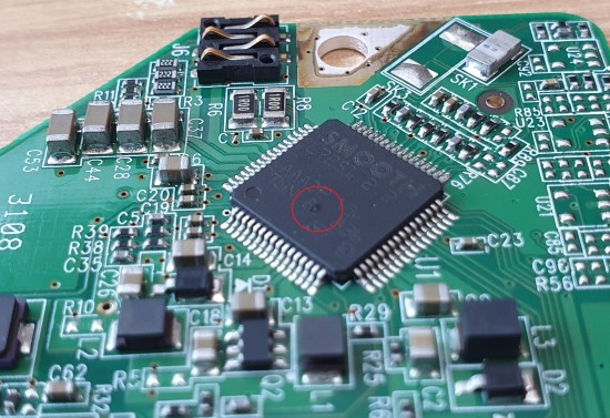

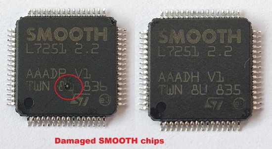

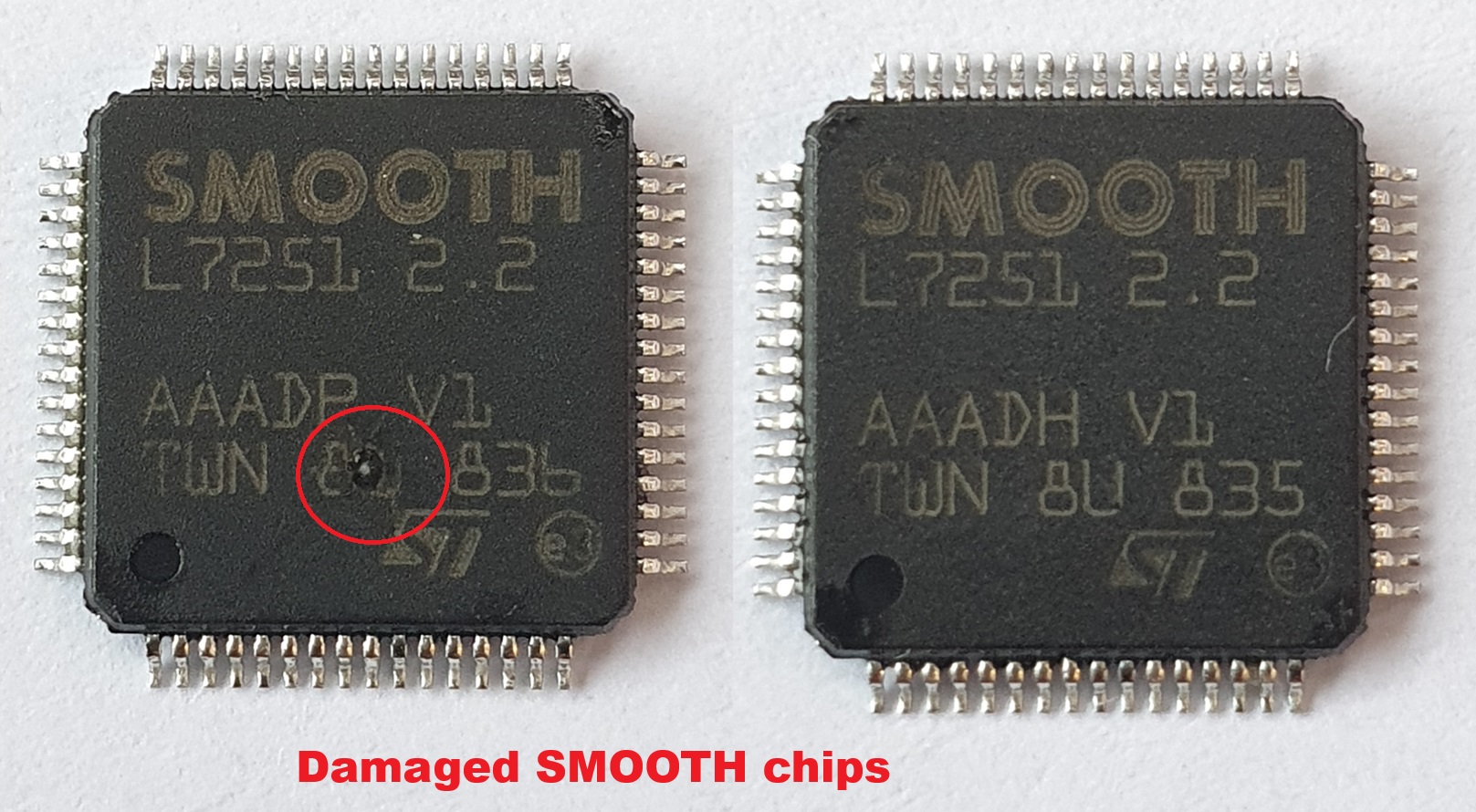

Hello All, some update,
I decided to inspect the faulty PCB's further.
Fried SMOOTH chips have been removed, original PCBs inspected carefully, no physical damage found and all shorts disappeared.
Out of curiosity, I decided to transfer chips from the donor PCBs.
PostPosted: November 17th, 2025, 6:58
Joined: October 30th, 2025, 4:31
Posts: 19
Location: Dublin
Surprise! BOTH HDDs showed signs of life!
Clicking sound disappeared, Both drives can now be seen by the Disk Management in Win10. :shock:
So clicking sound, after the PCB swap does not always mean that preamp and heads are also damaged.

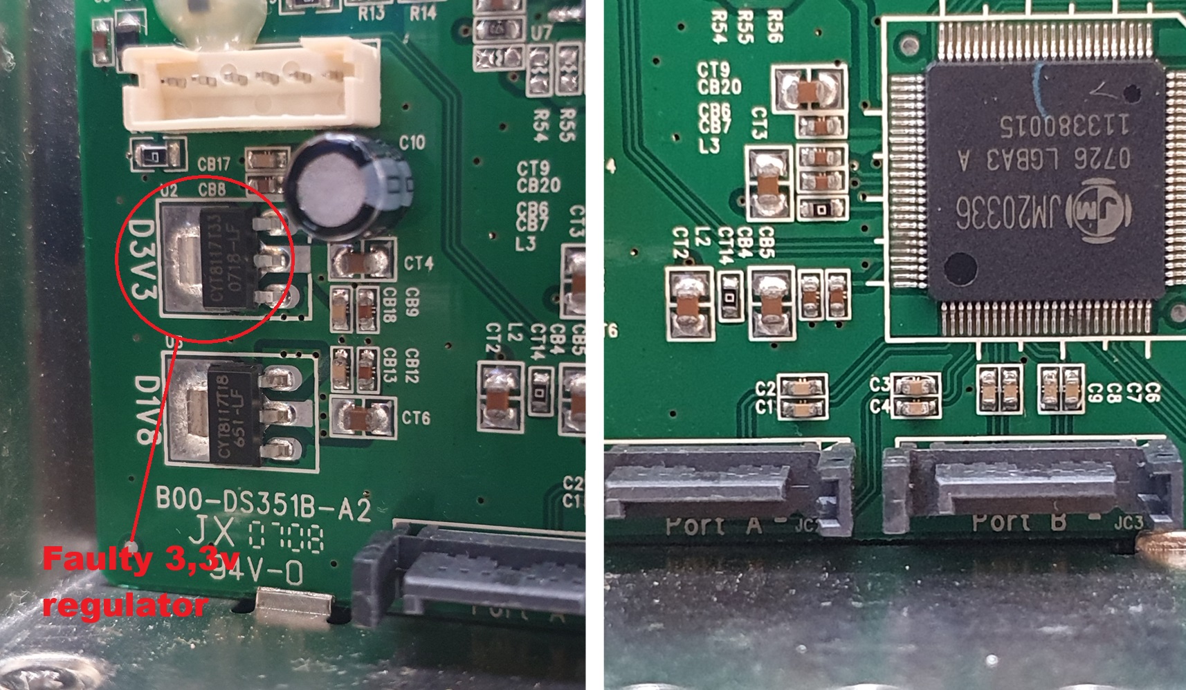

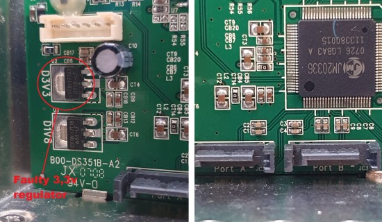

HDDs have been inside the TrekStore DSDWUB-JM-b enclosure, that also sustained damage.
3,3 volts regulator was gone as well as one 8 pin unknown chip. no marking is visible on it, but it controlled the power button.
3.3V regulator replaced, shorted power button IC removed. Enclosure PCB came back to live! :shock:
At this point Win Disk Management can see the HDDs and shows the correct full capacity - 1.8Tb, but disk is not initialized.
