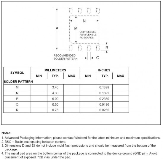

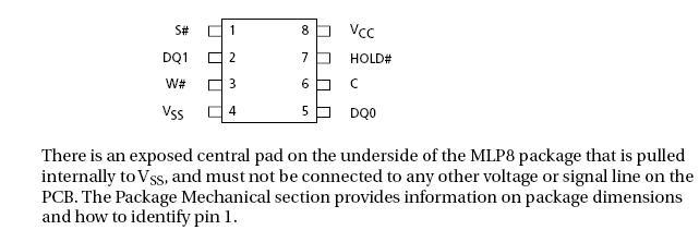

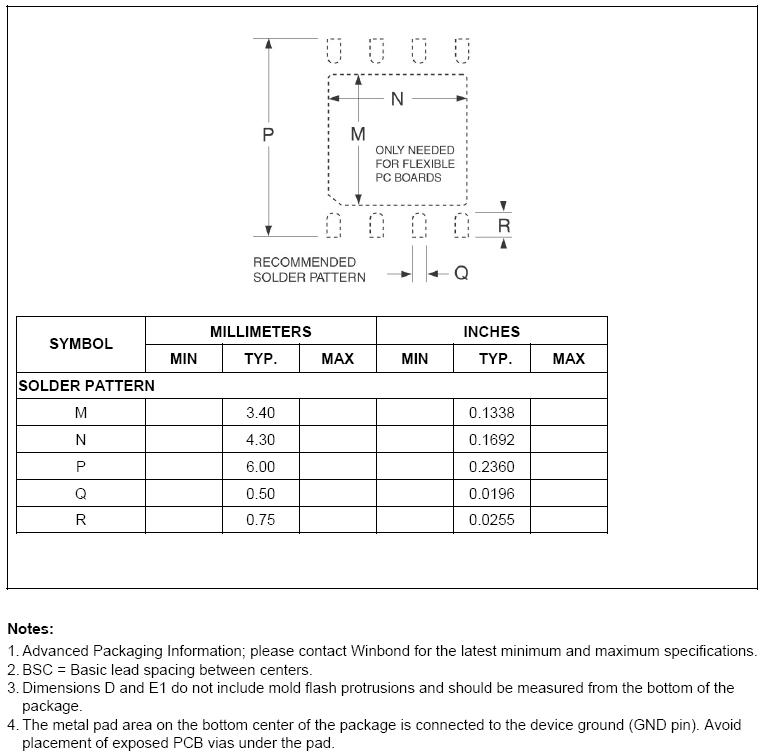

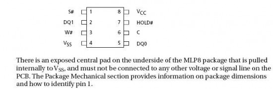

michael chiklis wrote:
No, it's not ground!
you're probably right, but for some reason - i don't know why - the datasheet says otherwise
here is what it says on an ST chip that has been used on PCB MK2555GSX G002439-0A
and here is another chip from winbond that it's been used on another toshiba PCB (note no. 4)
but there is no point to argue with you, because as i have written on the beginning you're probably right and it's not GND, and the manufacturers don't know what they are talking

The word "pulled" does not mean the same as "connected". Usually a pin is pulled high or low via a pullup or pulldown resistor. This resistance could easily be in the 10K+ range. Could this explain the apparent disagreement between measurement and datasheet?
