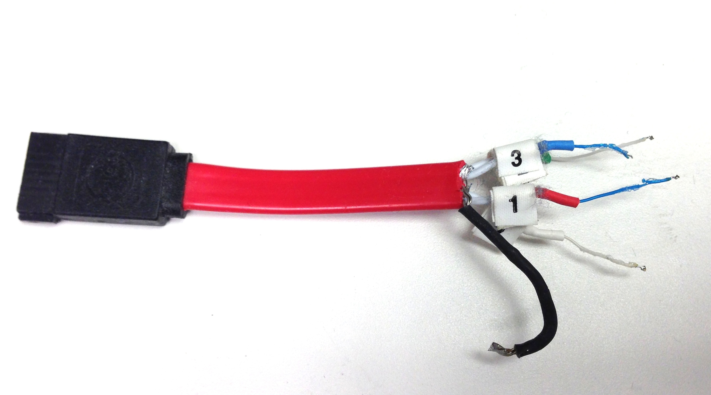

Here is a photo of an adapter that I have actually used.
Small gauge wire-wrap wires are soldered to the SATA cable wires, to make it easy for connecting to PCB signal points. Wires are numbered (and color-coded) to reduce chance of error. You are welcome to copy it Fzabkar, if it will come in handy for the recoveries that you don't actually do. :-)

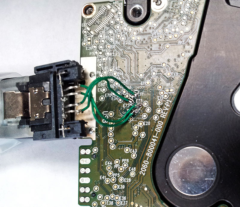

Here is a solution that works for PebbleBeach
I believe I already have the patent on that technique. At least I've done it often enough. In any case I prefer your method to Doomer's.
So soldering thin wires to a SATA cable are better than soldering thin wires to a SATA connector.
That's the Australian way, got it.

That said, I would have used all 3 grounds, but the central one (which separates Tx and Rx) would be the most important, AFAICT.
Still waiting for you to try something before claiming that it's the best

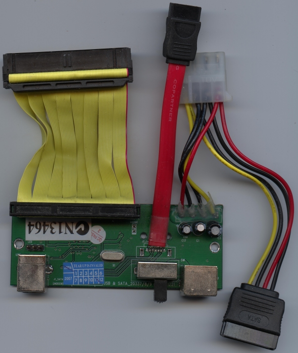

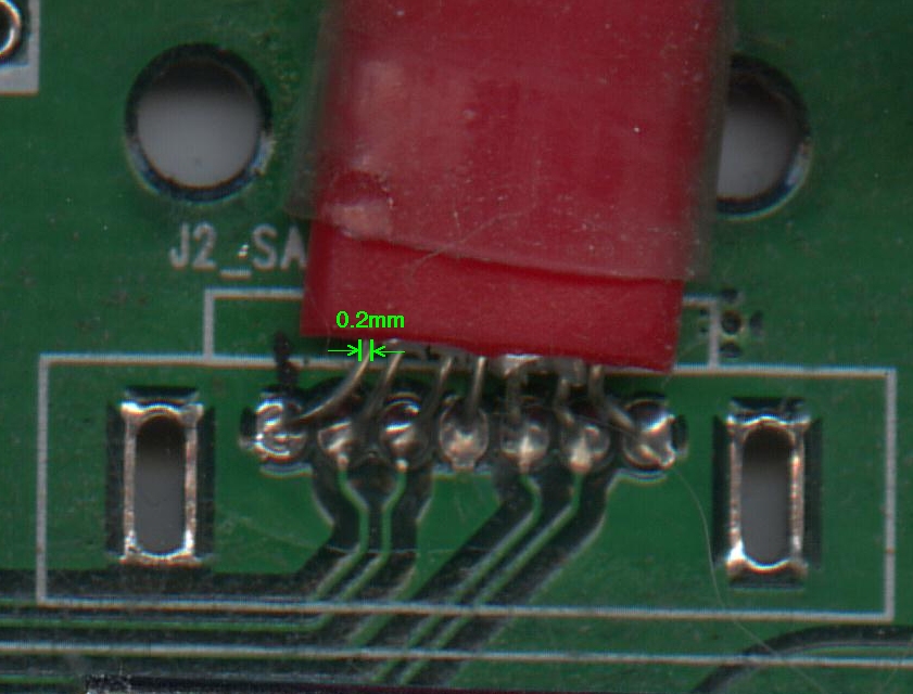

Here's how my USB-SATA/IDE bridge PCB does it:
My eyesight wouldn't be good enough, but ISTM that those people who solder monoliths would be able to do something similar, even if it requires an extra few mm of thin wire.
BTW the wavelength is 5cm at 6GHz and 10cm at 3GHZ, so there really isn't that much to work with, at least theoretically.
