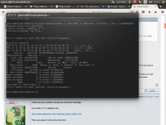

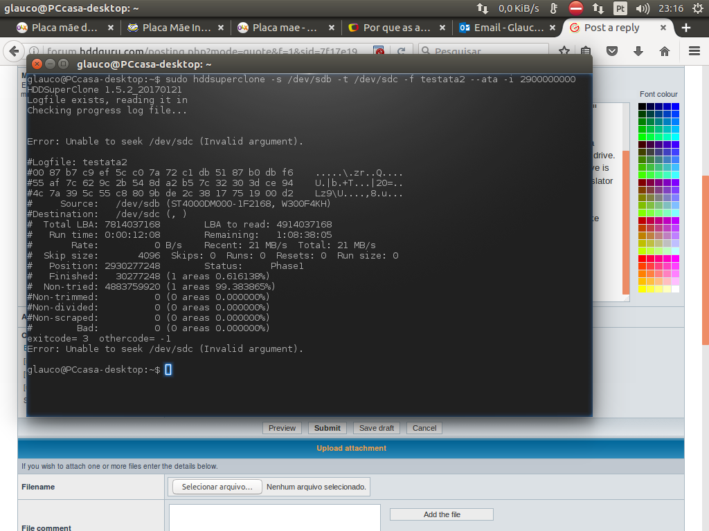

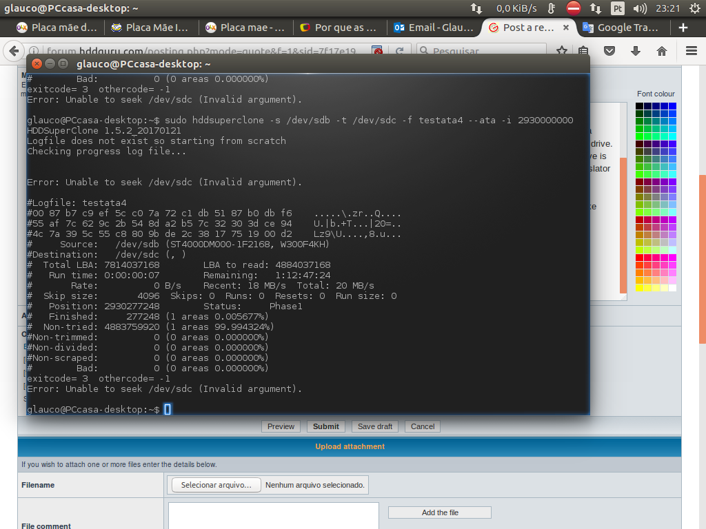

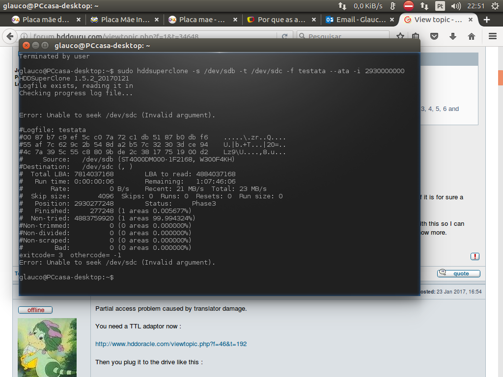

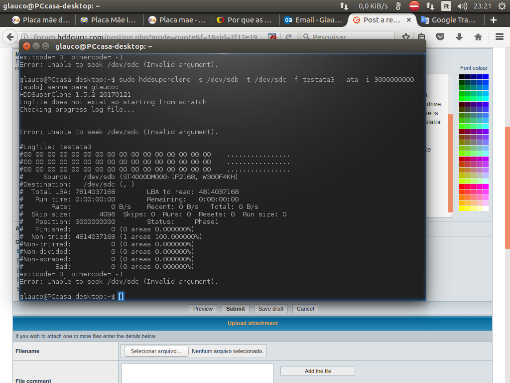

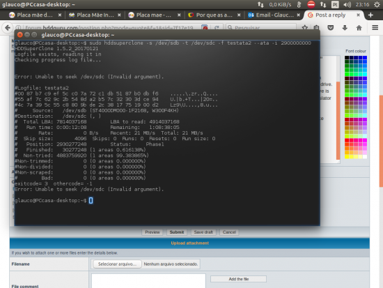

The third drive is connected in a USB port (Expansion desk, is the only one i have at this moment to make tests)
@maximus, I did it:
I started in a "good" area, near to failing LBA (2930000000) (last printscreen)
Then, i made the test again in a good area even earlier (2900000000)
And, in a "Bad" area (3000000000)
and back to a "good" area, hddsuperclone read it perfectly again (2930000000)
This is it.
Waiting feedback.
Thank you all!

The current issue is with the DESTINATION (target) drive, NOT the source. That is why it seemed so odd. Is the destination drive large enough? You are trying to copy a 4TB drive, and it is failing at about 1.5TB.
You can test further commands using /dev/null as the destination, but that will not copy any data and is only for testing. You need to figure out why the destination is having issues if you want to clone the drive.

 Post subject: Re: "Blank" or "Empty" Media files after HDD data recovery
PostPosted: January 23rd, 2017, 21:55
Posts: 992
Spildit wrote:
Translator problem ....
Partial Access Problem ....
(As expected ...)
I bet you did not see the destination drive as the possible issue. I did, but there was an issue with the code that did not show this, and I needed this to see it. I did extensive testing with issues with the input device, but not the output. So then the question will be, will there be a physical issue found with the source later on when a full recovery can be attempted, or is it a logical issue with the data on the drive?

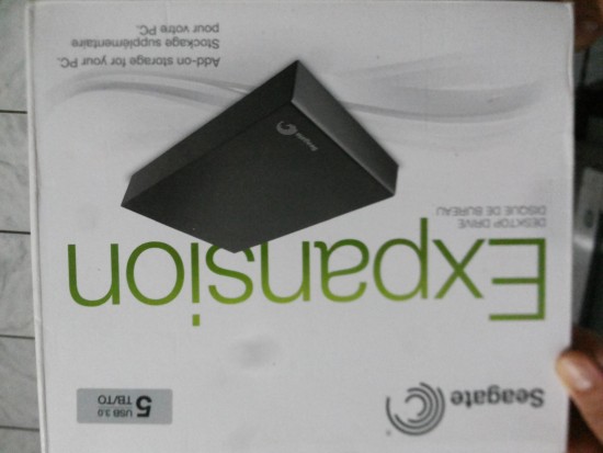

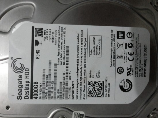

I found a specification document that may shed a bit of light on the "5TB" drive. The Seagate Desktop HDD ST1500DM003 is supposed to have 2,930,277,168 sectors. That is perfectly in the range where the write failed.
:shock: :? :shock:
http://www.hddsuperclone.com
Home of HDDSuperClone
PostPosted: January 25th, 2017, 18:56
Posts: 713
Location: Brazil
Then maybe Glauco doesn´t have a ST5000 but a ST1500 external unit ? Seems very possible, yes.
Glauco, please, post pictures of the labels of both your drives, the problem one and the usb one.

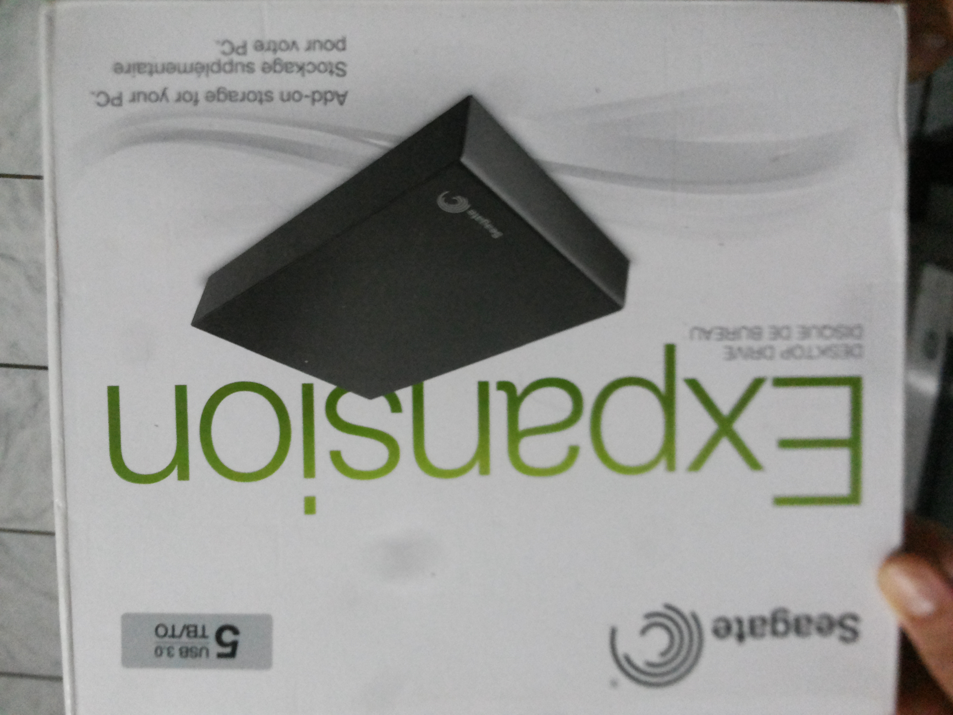

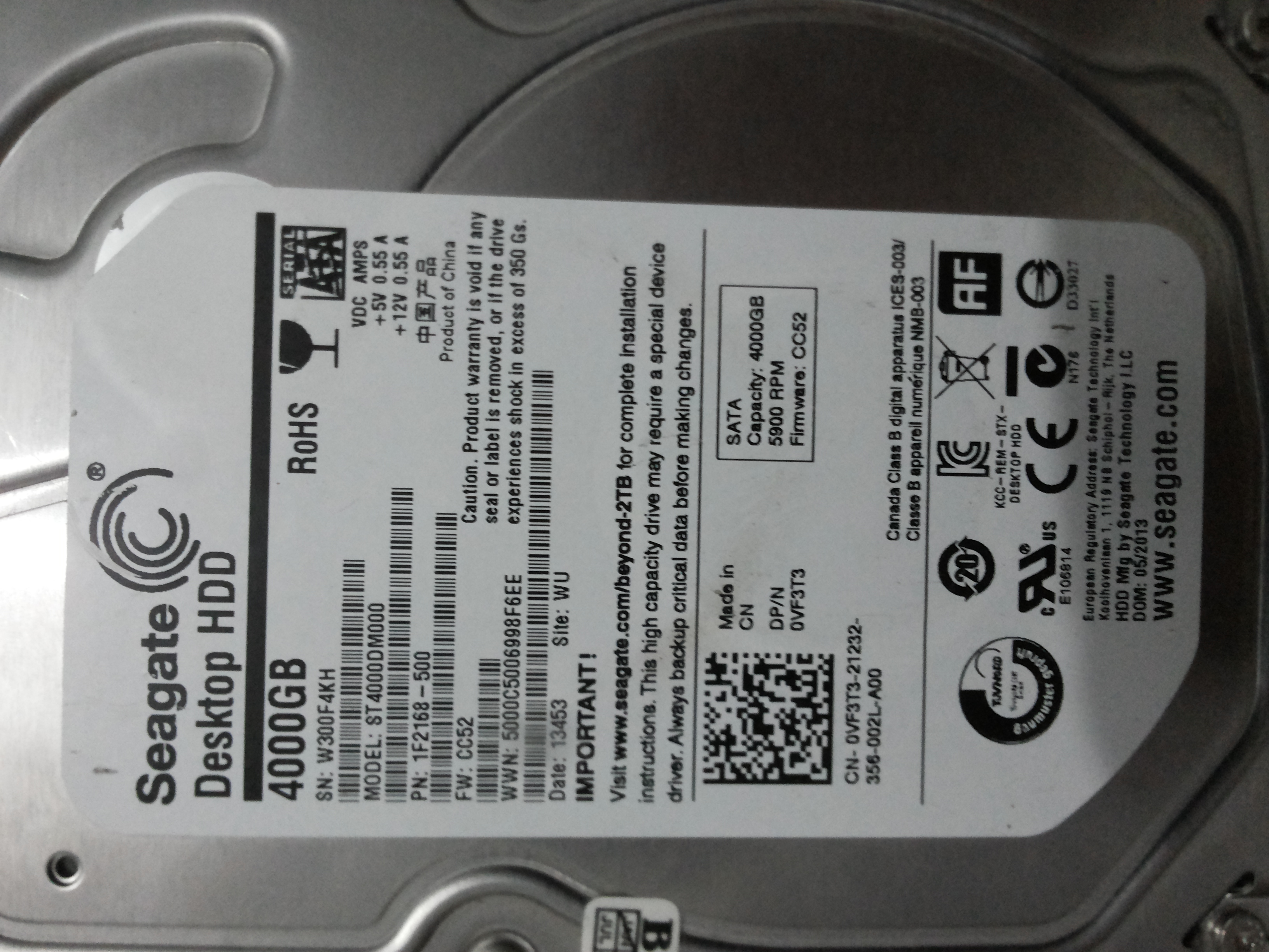

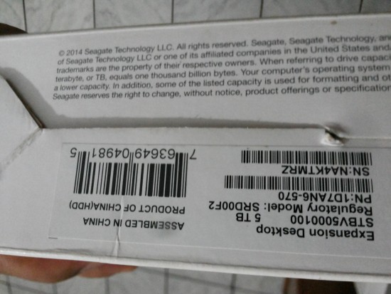

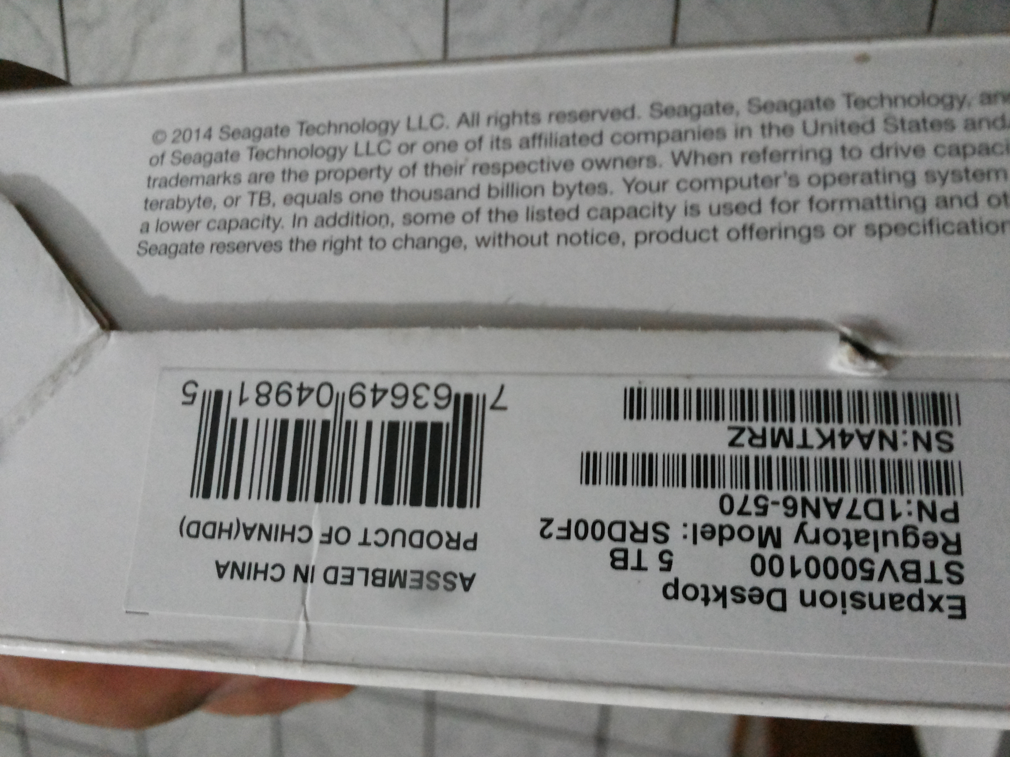

Hi, first of all,
I could not take the tests today because it was too hard.
This 5tb HD has one of the unallocated 1.5TB partition, may have something to do with the issue being presented.
Tomorrow, I hope, I can do the tests.
Follow the HDD photos as requested.
P.S.: I tried posting the photos in every possible position. Always appear upside down in the post.
