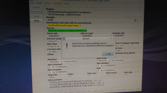

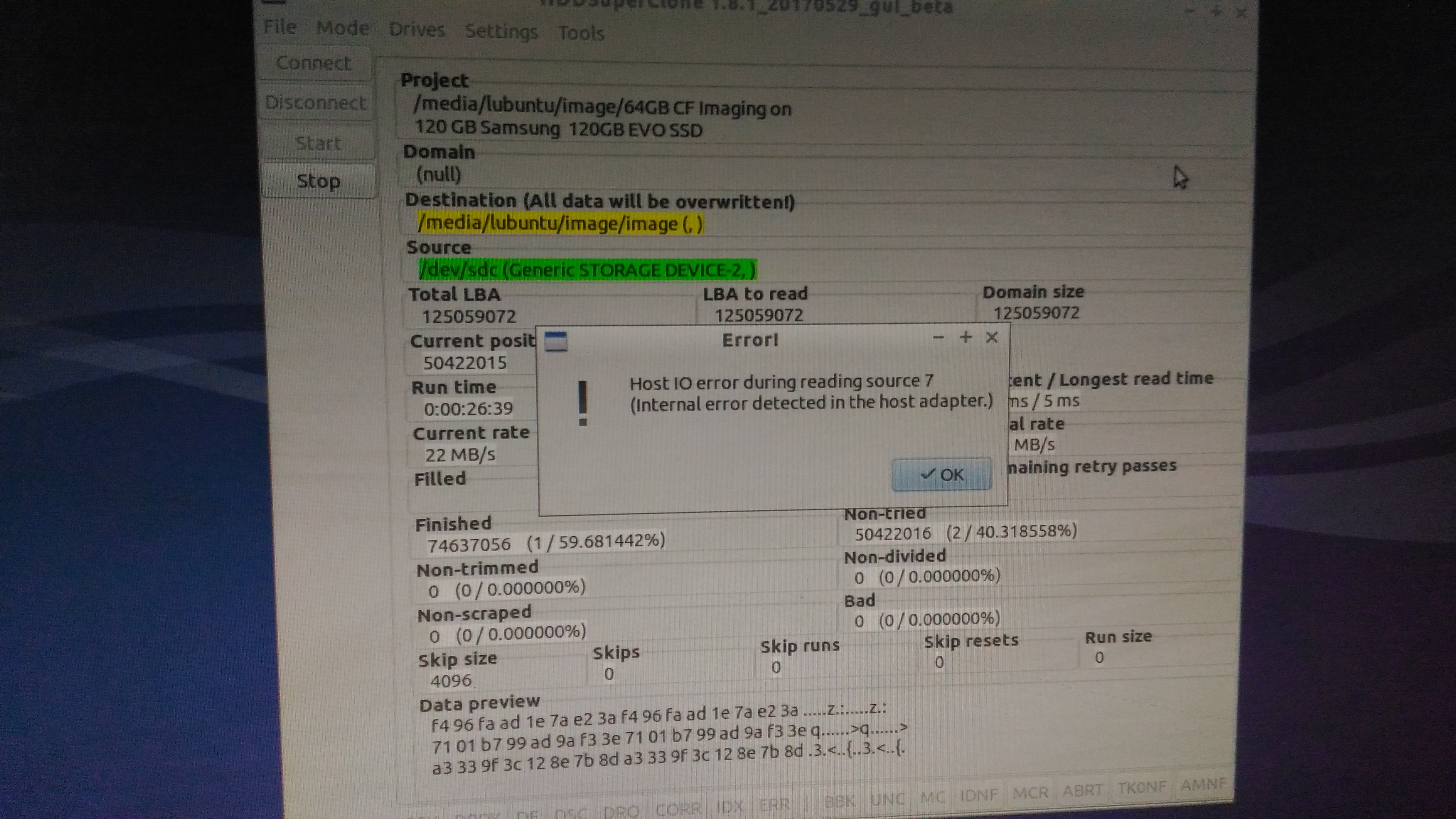

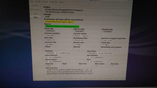

Hi maximus
Unfortunately there is bad news. As you have suggested ,I tried to image disk instead of cloning . But process ended abruptly giving error.
I am fearful card may fail due to multiple imaging as it is already in bad condition.
 Post subject: Re: Cloning Tool
PostPosted: June 2nd, 2017, 17:33
Posts: 992
That is not a good sign for sure. But hddsuperclone can be resumed with project file. You might be able to remove and reinsert the memory card to get it recognized again, then resume the recovery. You should choose to disconnect and then connect again, and if there is an issue you may need to choose the source again. If you have closed hddsuperclone you can reload (open) the project file, but you must choose both source and destination again.

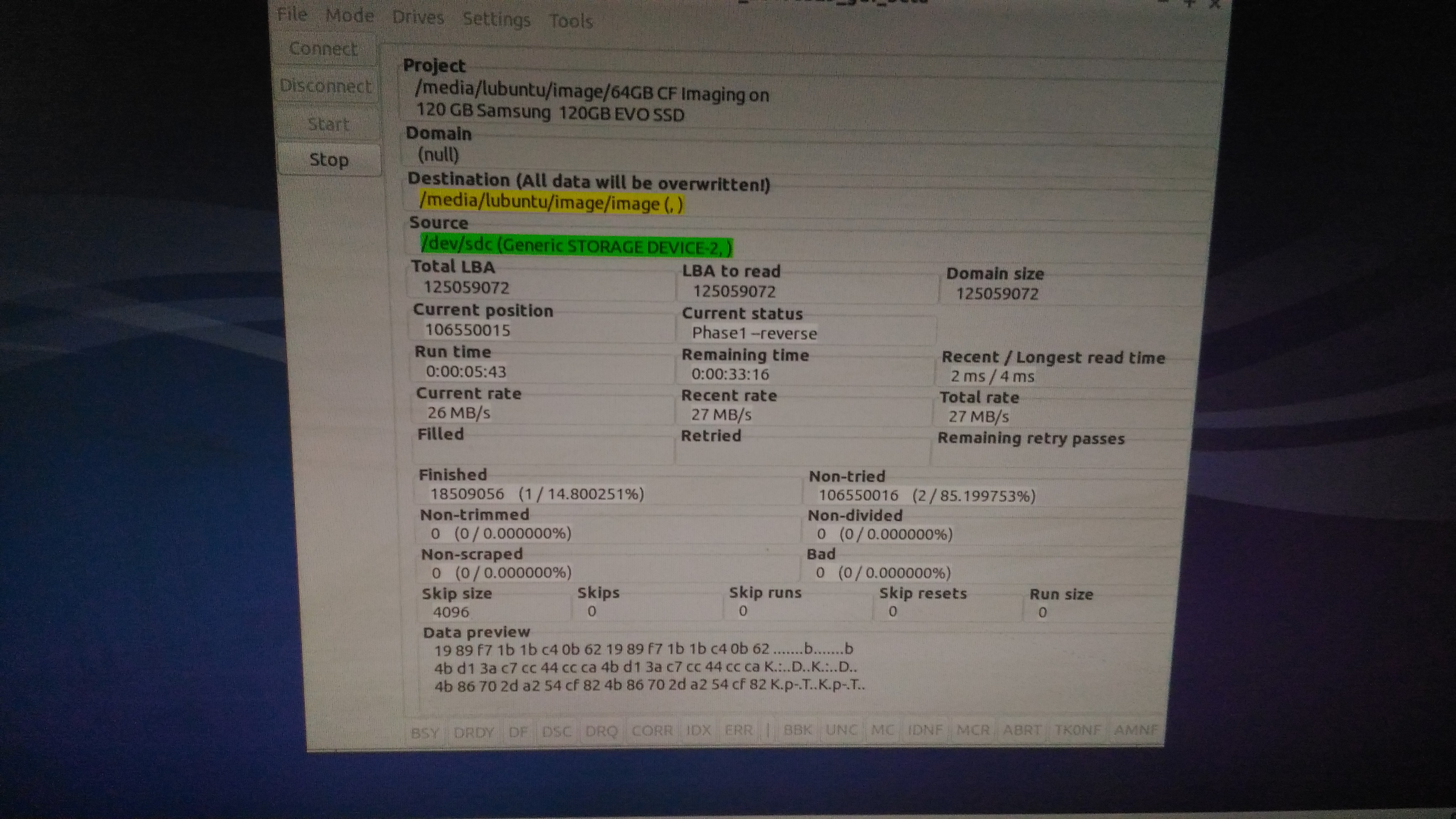

Initially while cloning I have used Transcend USB 2.0 Card reader on USB 2.0 Port. But while imaging I have used Transcend USB 3.0 card reader on USB 3.0 port.
I think it has something to do with abrupt error.
I have now created a NTFS partition on SSD & created card Image in reverse. I have been successfully and only After 99.18% read errors stated apprearing.
So now we have captured card in most efficient manner. Attached is log file of the process ,which may give you some hint whether imaging was right.
Download File- https://drive.google.com/file/d/0B8JKI5 ... sp=sharing

The recovery looks the same as the previous recovery. There is something additional you can try, it should recover 127 more sectors.
Open the project file again in hddsuperclone.
Select the same source and destination.
In the tools menu, select "Reset Log".
In the clone settings, uncheck Phase1, Phase2, and Phase3.
In the clone settings, make sure Reverse is checked.
In the clone settings, change the Clustersize to a value of 1.
Connect and start.
You should see the finished value jump from 124010368 to about 124010495.

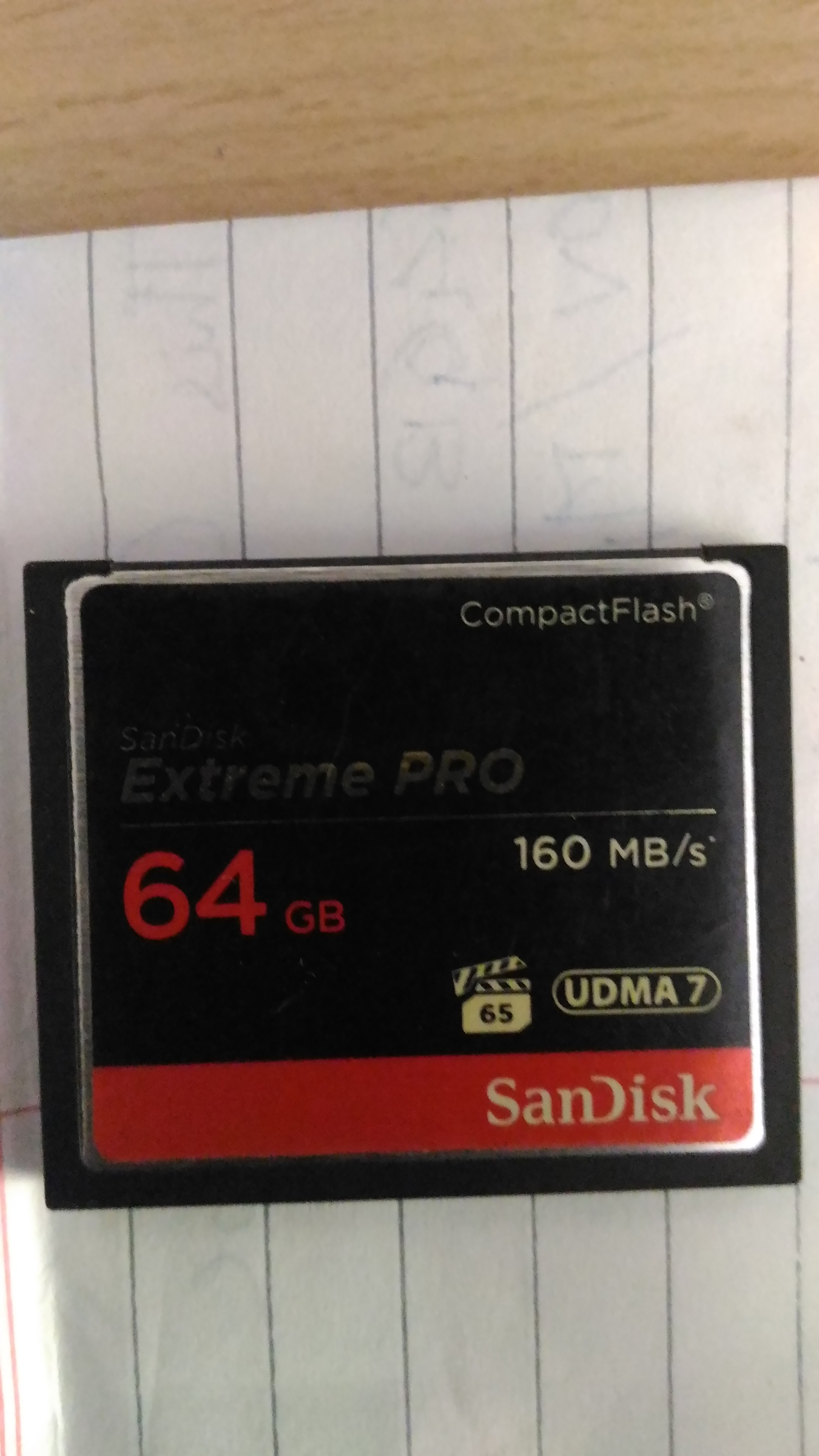

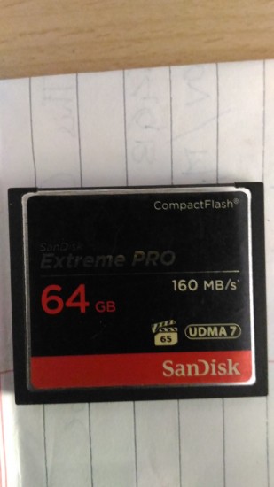

Why, in 4 pages of forum posts, was a model, make of card.. or even a photo not provided? Depending on the card, the lack of proper image means that chip off is only way. Just because the card somewhat works does not mean it is imageable. a cards firmware in some cases can be thought of as part of its hardware. meaning blocks of code are part of the running of the controller essential to properly reading/writing what is stored on the NAND.
Please before you return it, could you photo the card and put it up here for a bit more completeness to this thread?
It will add more context to people reading it in the future.
If you can convince customer, maybe try chip-off.
I am not just beating the chip-off drum, but know this is the next step after imaging fails.
PostPosted: June 4th, 2017, 0:56
Joined: March 9th, 2017, 6:16
Posts: 127
Location: trinidad
Hi HaQue
I have attached snap of card , I have already given description of card in first post itself , besides in hddsuperclone snaps it is mentioned source as sandisk 64GB CF card and target 120 GB SAMSUNG EVO SSD
I disagree with you. Card may not have firmware issue as it can be imaged upto 99% , if some issue is there with MCU or any other code generally card shows less size and does not give access to sectors at all. Here we can check any sector in hex.
Only sectors where nand has defects cannot be read (first 600MB)

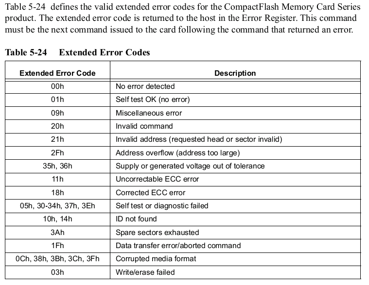

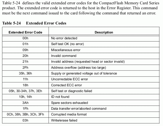

I would retrieve the card's Identify Device information sector. Look for stuck data bits.
There is a table of Extended Error Codes on page 5-19 of the following manual:
SanDisk CompactFlash Memory Card OEM Product Manual:
http://pdfstream.manualsonline.com/2/23ba20e9-6aaf-4f79-a7d9-f78379489686.pdf
The above codes are accessed via the Request Sense (03h) ATA command.
The Execute Drive Diagnostic (90h) command (page 5-3) may or may not return some useful information.

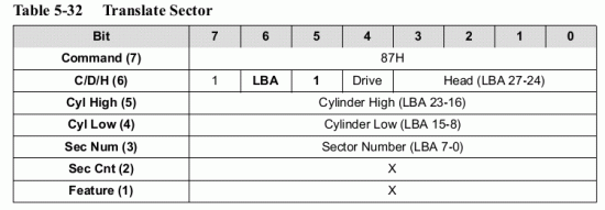

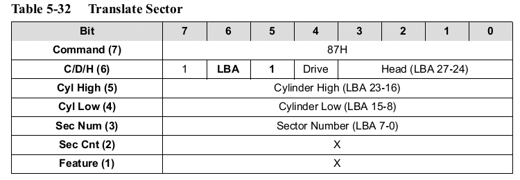

There is also a Translate Sector (87h) command (page 5-23) which looks very interesting:
When this command is issued, the controller responds with a 512-byte buffer of information on the desired cylinder, head and sector with the actual Logical Address.
Table 5-33 represents the information in the buffer. This command is unique to SanDisk CompactFlash Memory cards.
