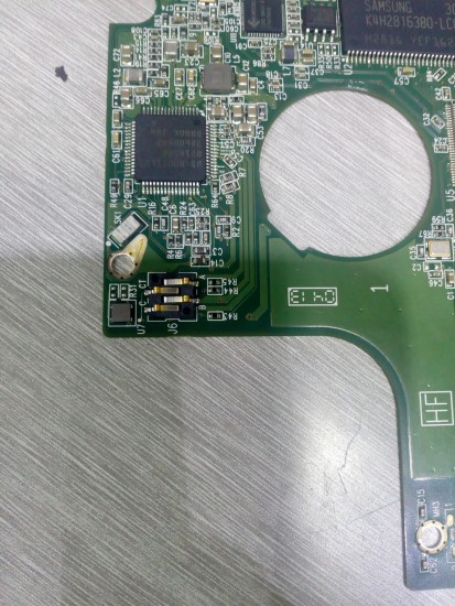

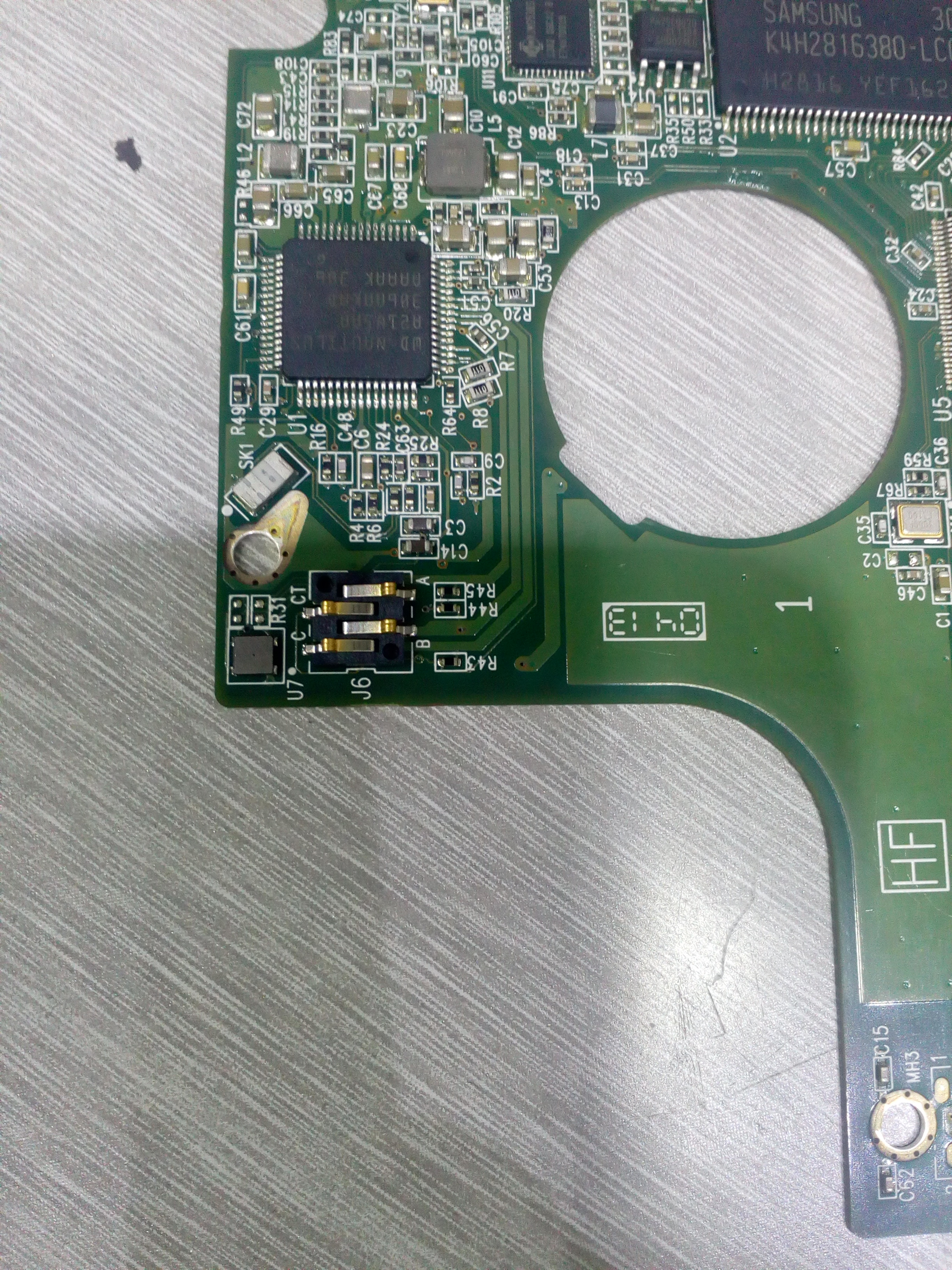

U7 exist

This PCB (from a Hubble_LT) has the same MCU and motor controller. FWIW, U7 is unpopulated. The adaptive section is similar to that of the WD1001X06X-00SJVT0. Perhaps there is a clue here?
    88i446-NDB2
    Nautilus
    WD5000LPVX-22V0TT0
    HUBBLELT
    2060-771959
    unpopulated U7
    1 shock sensor
    2 heads
    SATA
http://ep.yimg.com/ay/yhst-14437584971410/2060-771959-000-14.gif
module 4F
00000190                    00 00 90 AA 00 00 00 00 70 0C
000001A0  00 00 28 0C 00 00 00 00 00 00 00 00 00 00 18 00
000001B0  00 00 F8 FF 00 00 00 00 00 00 00 00 00 00 00 00
000001C0  00 00 00 00 00 00 00 00 00 00 00 00
head 0   head 1
0000700C 0000280C 00000000 00000000
00001800 0000F8FF 00000000 00000000

I'm reasonably certain that U7 is a barometric pressure sensor. It appears to consist of a Wheatstone bridge with 4 piezoresistive elements.
http://www.hddoracle.com/viewtopic.php?f=100&t=2483&p=18107&hilit=barometric+pressure+sensor#p18107
