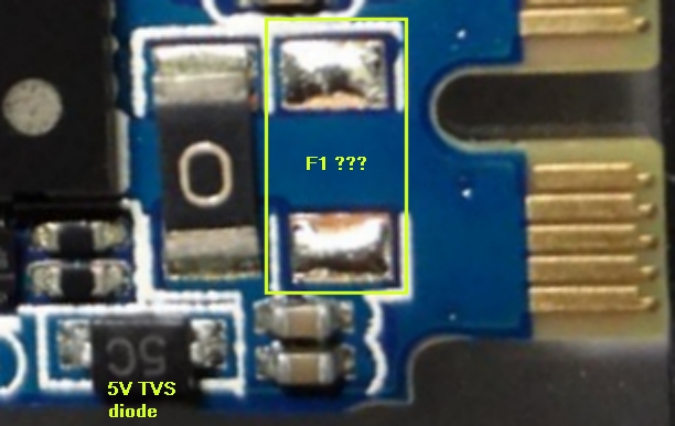

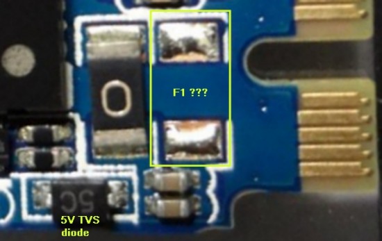

I wonder what this location connects to:
In similar designs I have seen it labelled as "F1" which suggests that it is intended for a fuse. Could one side be connected to +3.3V (pin #74) and the other to the Vcc pins of the regulators?

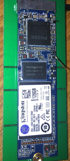

Pin #38 would be directly connected to power pin P3 (+3.3V) of your SATA cable. If you short this pin to ground, without doing anything else, then you will be shorting your SATA power source. Instead I would flow a blob of solder between pins 2 & 3 of C35.
I'll post a diagram of this area of the circuit shortly.
Thanks allot! It did power on as you said!
Now Im facing a whole different issue, it present itself as 2MB.
Managed to start a clone, but I got only 2MB... :(

Did you check the outputs of each regulator? Could a missing supply voltage for the NANDs be responsible for the 2MB fault?
The attachment F1.jpg is no longer available
Correct again! :)

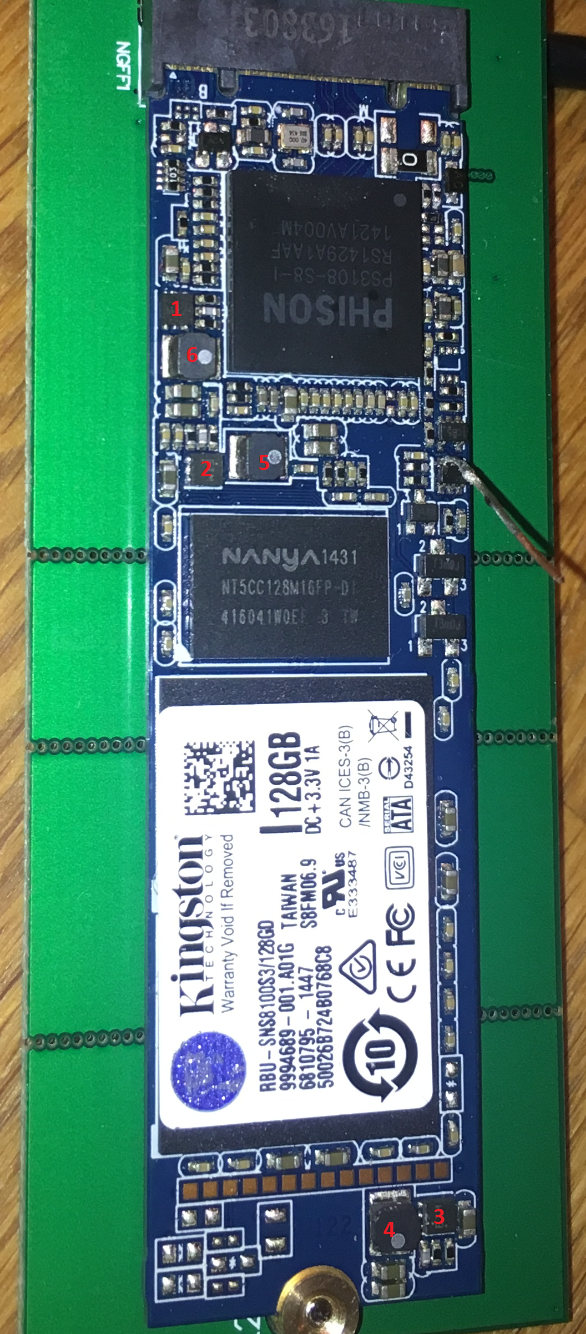

I checked them all, but the outputs of the regulators are the same. The inductors are showing different voltages tough.
1
pin1 - 0V
pin2 - 3.3V
pin3 - 2.3V
pin4 - 1.3V
pin5 - GND
pin6 - 0.59V
2
pin1 - 0V
pin2 - 3.3V
pin3 - 3.3V
pin4 - 1.5V
pin5 - GND
pin6 - 0.6V
3
pin1 - 0V
pin2 - 3.3V
pin3 - 3.3V
pin4 - 1.84V
pin5 - GND
pin6 - 0.6V
4
1,84V both sides
5
1.5V both sides
6
1.26V both sides

It appears that Vcore = 1.26V (flash controller), Vio = 1.5V (for SDRAM), and 1.8V is the NAND supply. Therefore, ISTM there is a firmware problem. :-(
NT5CC128M16FP-D1, Nanya, DDR3 SDRAM, 2Gbit 128Mx16, 1.35V, 96-Pin TFBGA:

In retrospect it would have been easier to run a bridge between the pads of "F1". That would have bypassed the DEVSLP circuit.
