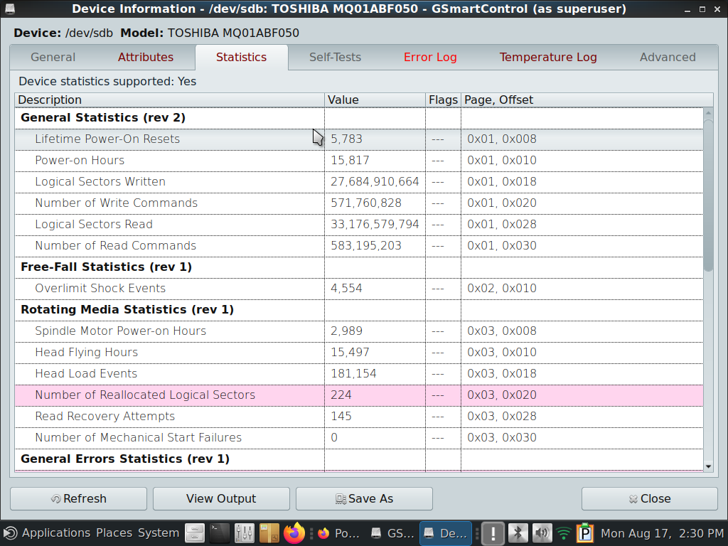

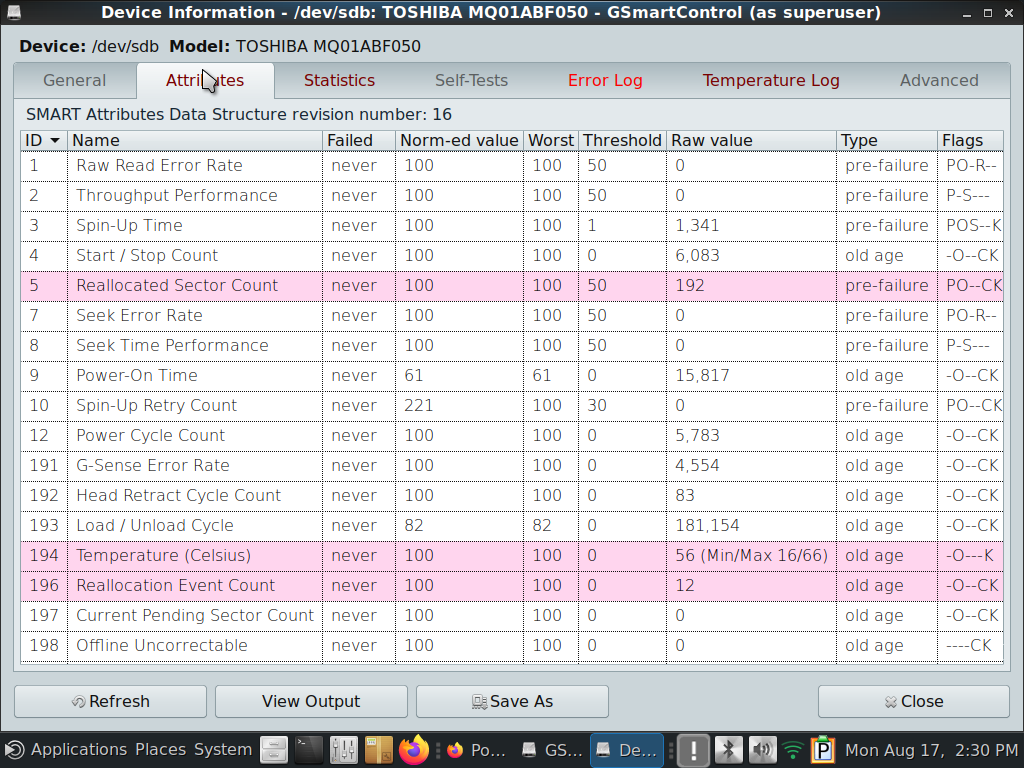

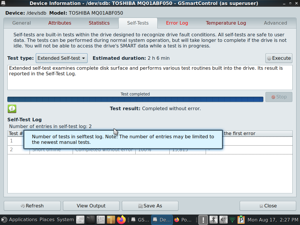

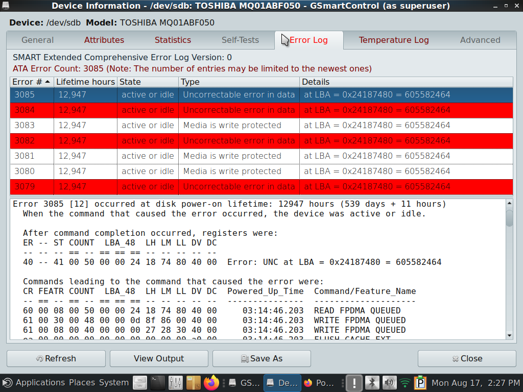

Got the same drive. According to gsmartcontrol it passes. But it have many ATA errors (more than 3000). Is it about to die? I posted pictures.
