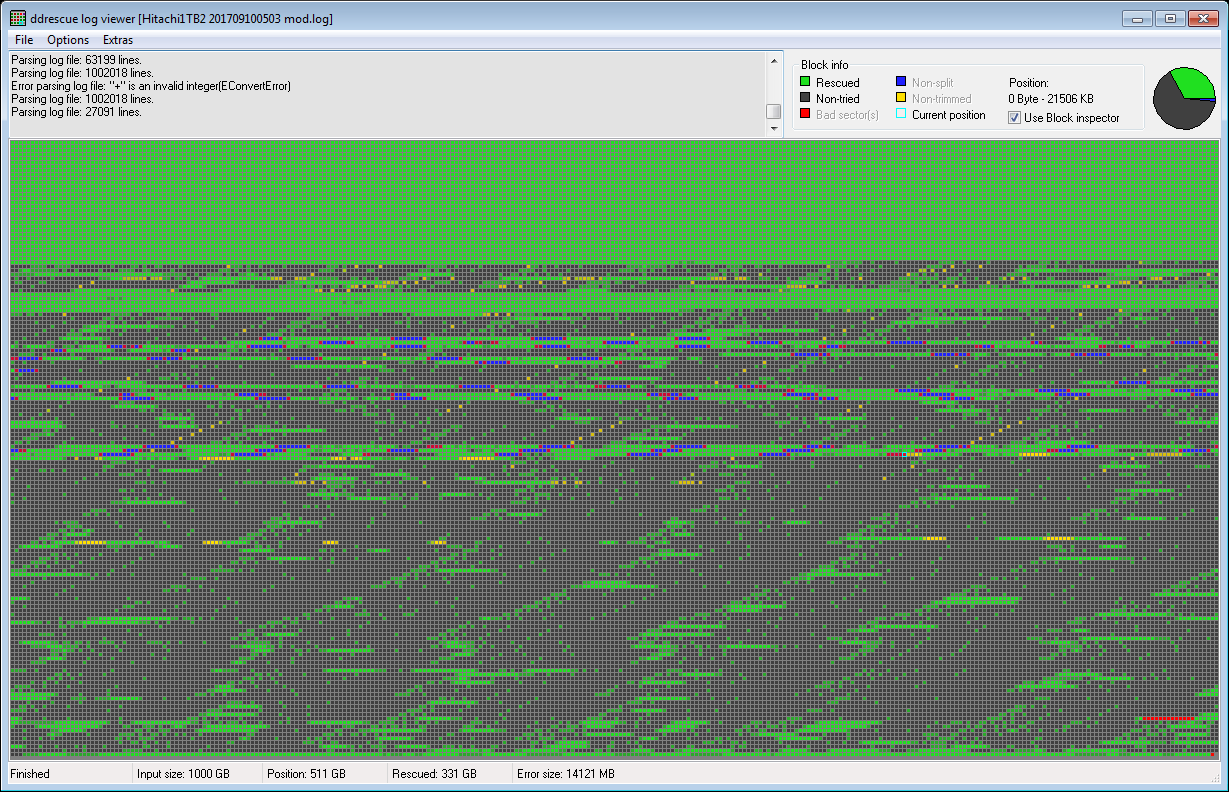

If you saw the SuperUser thread, I went the painstaking way of :
– getting and saving the list of sectors for each of these files (using three methods : with HD Sentinel, Recuva, nfi.exe) ; some of those files were highly fragmented, probably because they were downloaded simultaneously (8000-12000 fragments) (at this point I had no idea that this would prove very useful later on, I was merely trying to gather as much information as possible before proceeding with an actual recovery attempt, and more specifically to determine the interval of sectors I would have to extract if proceeding with ddrescue to encompass all six files in their entirety) ;
– making a partial clone with ddrescue, large enough to include all six files (based on the information gathered in the first step), plus, IIRC, 10GB at the begining (I could have done a full clone right from the begining, but judging retrospectively from the way the drive deteriorated once I tried to access those bad areas insistently, I think that I had the right intuition and did the right thing, since those bad areas were around the 2TB mark on a 3TB drive, and a significant chunk of the MFT was located right at the end, the overall recovery success might have been vastly inferior and I might have had way more than just 6 corrupted files, so from that experience I would say that cloning is not always the best option when dealing with a failing drive, especially for a home user with no access to advanced hardware-assisted software tools) ;
– since the 10GB chunk at the begining didn't contain the whole MFT I was kinda SOL with the regular methods of extraction, hence why I created that thread, got no relevant input, but managed to use ddrescue itself, and edit the list of sectors (using Calc from LibreOffice) to create custom command files, so as to re-generate the whole files, fragment by fragment, but in an automated way... (And that wasn't just luck, it took some thinking and effort to fix my fuck-up !)
At that point the drive had become too unstable, and without the complete MFT, neither R-Studio (even – IIRC – with a .scn scan information file made prior to the drive's severe deterioration) nor WinHex (with – for sure – a volume snapshot made before when the whole drive was still accessible) could extract those files. So I had to improvise...

The way you fixed the 1 TB HGST makes me think that you are a very lucky guy ! Your procedure is full of problems ... If you are cloning with ddrescue or hddsupertool or whatever and you do your homework you wouldn't be letting your OS to access the drive (mount) and because of that it shouldn't matter what partition the drive does have as you are working at LBA level only. You should NEVER write to a drive that you are attempting to recover from.
How do you figure from what I wrote that I tried mounting it before the cloning part was over ? ddrescue does have a preview option, which shows the bytes being copied at any moment, if that's what you're alluding to, that's where I saw at some point that only 00s were copied – I just didn't know yet that this was normal since a large portion was actually empty, and it was a mistake to stop it ; but the strange thing is that, whereas there were many slowdowns and skipped areas at the first attempt, it copied flawlessly and at a constantly high rate (around 50MB/s) the second time around, although it became unstable earlier. I still made mistakes and was still kinda lucky, but not for the reasons you seem to think.
What I should have done right from the begining (I learned about it halfway through) is using ddru_ntfsbitmap from ddr_utilities to 1) first get the whole MFT ; 2) generate a mapfile to restrict the cloning process to actually allocated areas (less than 25% as it turned out — I couldn't know it at that point unless the owner had told me, but he was probably too clueless to even know about that) ; 3) run the cloning process with ddrescue and that mapfile loaded with the “-m” switch ; 4) optionally, run a pass without the mapfile, to try to get the unallocated data which may still contain useful remnant of files.
As a matter of fact, when doing the repair procedure at the end, there was one set of instances of the same video file for which one was partially corrupted, and the other was totally empty/blank : I figured that the empty one was probably on the unallocated space, because it had been deleted, and skipped by ddrescue because at that point I was using ddru_ntfsbitmap's mapfile. So, using the first sector LBA information found in R-Studio and making some calculations, I figured out where exactly on the image file that second instance was located, and made a custom ddrescue command to extract just the end of the file which was corrupted on the first instance, a mere 20MB... and it worked perfectly on the first attempt : the copy was quick and flawless as this happened to be a good area of the drive (or an area read by a good head ?), and the patch matched perfectly (I purposefully extracted a few extra sectors to make sure that they were duly identical), the file could be repaired completely and was playable to the end. I'm rarely proud of myself, but in that moment I was ! :)
Oh, and I created an image file with ddrescue, I didn't make a direct clone, that's why the destination partition was relevant. At first I wrote that image – on a Knoppix live system – to a NTFS partition, so as to be able to access it easily on Windows in order to do the extraction with R-Studio. Then I read on this french guide that writing an image file with ddrescue to a NTFS partition had been reported to cause significant slowdowns. Translated quote :
“Avoid using a NTFS partition to store a disk image of important size (more than a few GB). Several persons have reported that the recovery slows down progressively, to such an extent that it's impossible to finish the recovery.”
Then, since the copying rate had gone down to about 600KB/s, I asked on SuperUser if at this point it was worth the trouble to stop the process, create an Ext4 partition, transfer the image and resume the process. At someone's suggestion I created another thread dealing more specifically with the possible impact on performance of writing sparse files to a NTFS volume on a Linux system. The replies I got in both threads were inconclusive, but I still went through with it, with the results described above.
(Sorry, many words again, but apparently I was misunderstood, despite my best efforts to be clear and thorough and write in as good english as possible ! :) Still, I think that this is an interesting issue, which may deserve its own thread...)
(I shall add that this seems to be a general problem on this forum : even when some issue or method is exposed clearly, especially by non-professionals, whose knowledge and skills are naturally disparate, inhomogeneous, the first few replies – and they can be the only ones if the OP doesn't insist and/or doesn't understand that he or she was misunderstood – are often based on assumptions or prejudices, which may be related with very common mistakes or misconceptions that professionals encounter regularly, but it doesn't mean that each and every rookie will repeat them cluelessly. Sometimes I read a first post which explains an issue or asks a question quite clearly, I can understand what that person did or means, even though I may not be confident enough to provide a perfectly accurate reply, yet the first member who replies does it based on what the “average dude” would have said or done in a similar context, not on what was actually stated.)

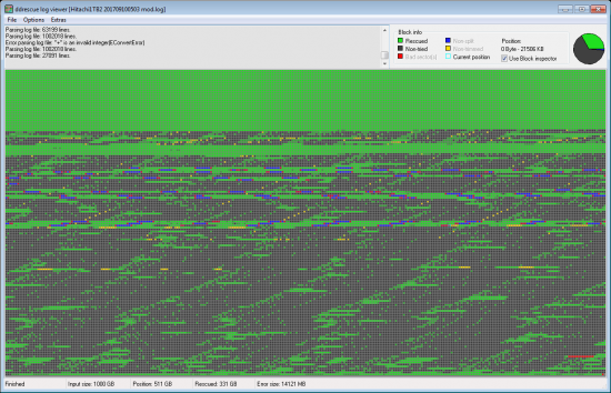

Just to illustrate, the final recovery image looked like this in ddrescueview (is it consistent with one failing head ? model was HDS721010CLA332) :
