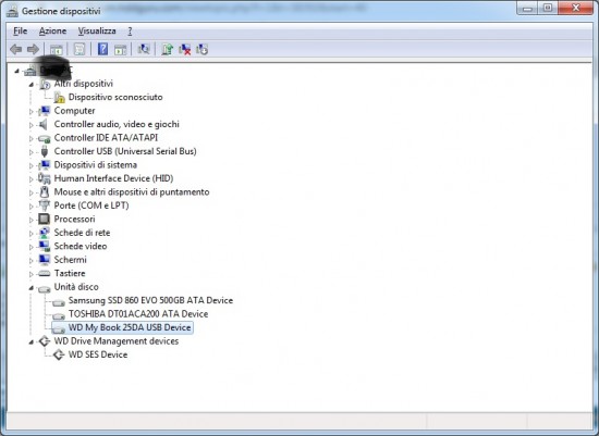

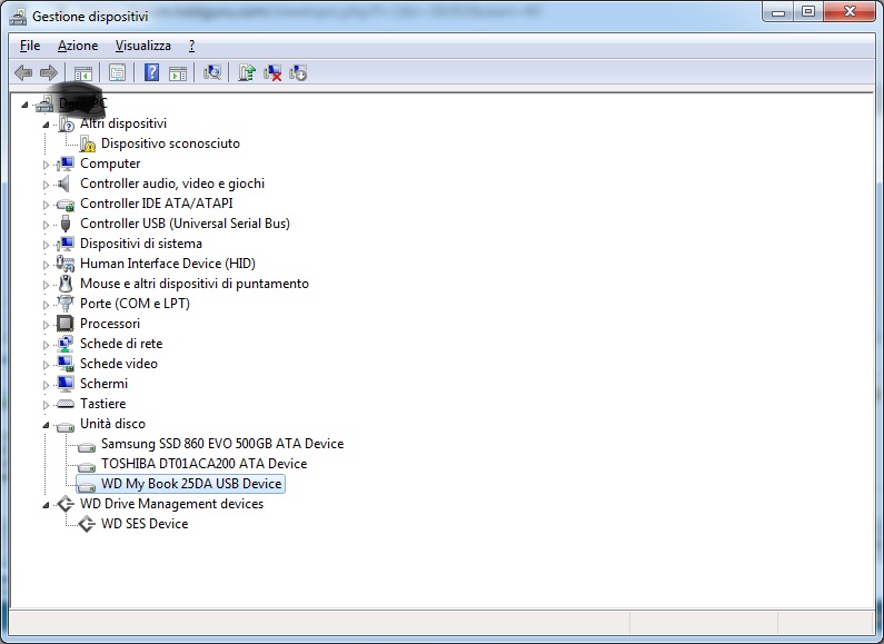

I've attached a 500 GB hard drive (WD5000AAKS-22V1A0) to the MyBook usb controller of this 8TB helium drive.
I'm using the original MyBook power supply, once i attach the usb data cable to PC usb port the hard drive spins and is detect in device management as with name (WD My Book 25DAUSB Device).
Device management also loads WD SES drivers.
I can't access to user area on normal hdd attached to this controller as we expected before, this due to the particular behaving of this type of controller.
I attached this 500 GB WD drive just for testing if the usb controller could work without damaging the hdd pcb, now that i'm sure it doesn't kill the pcb, i can attach the original WD80EZZX-11CSGA0 hard drive.
Unfortunately, original drive is detect exactly in the same way and i still don't have access to user area. :(
When i open R-Studio with WD80EZZX-11CSGA0 drive attached to this controller, it detects it as the same 500 GB hdd that i used for testing previously (with its identical serial number).
I'm thinking the eprom of this usb controller records informations of wrong attacked hard drive and somehow locks permission of identifying the original drive. :?
Do i have to remove eprom from usb controller in this scenario?
Any other suggestions for access again to user data?

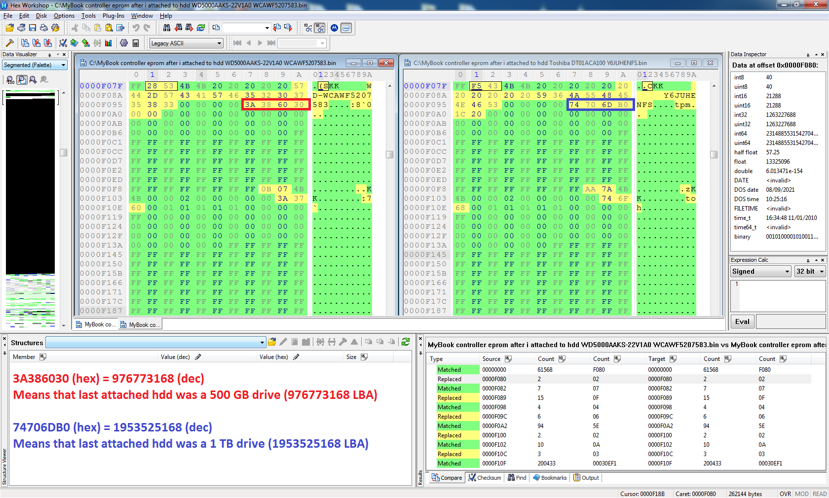

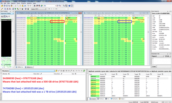

I did backup the flash rom of the controller after i attached the 500 GB WD drive for test purpose, then i did the same after i connected another drive (1 TB Toshiba) and i compared them into Hex Workshop.
See pic:
Here i've uploaded both dumped files:
USB controller 4061-705210-A00 eprom comparing.rar [221.26 KiB]
Downloaded 1528 times
I don't think anything has been written at the end of UA, i checked with WinHex on the Toshiba drive that was zero filled previously by searching bytes 57 44 first, then byte 01 only.
I will do further test later, thank you.

There are two dwords that look like LBAs, namely 0x3A376000 (500GB) and 0x746F6800 (1TB). These are near the ends of the drives. I would start dumping from those sectors up to the end of the user area. Perhaps there is a key in this area?
