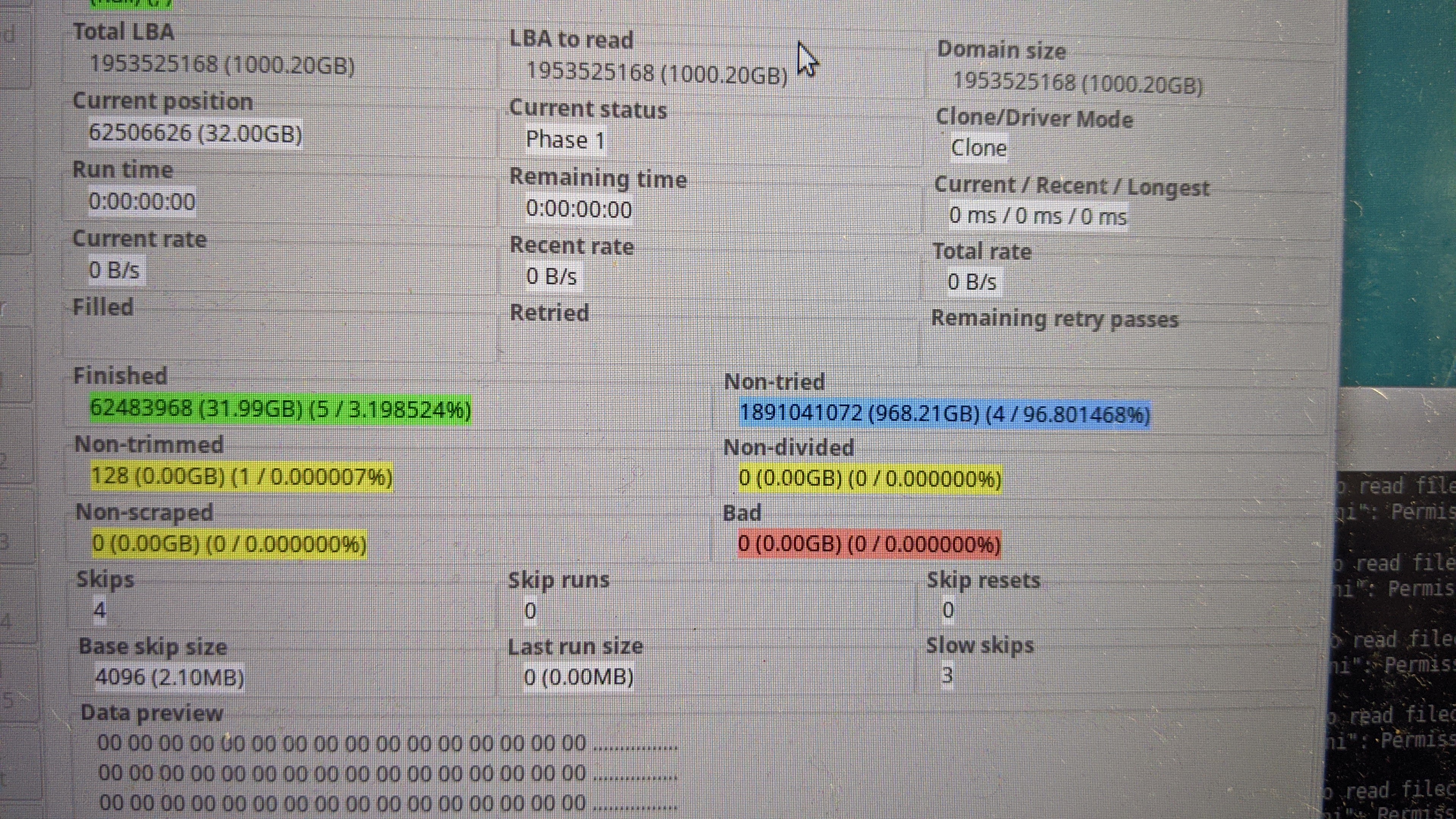

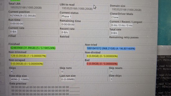

Re: sudden death ?
January 20th, 2021, 8:40
i will continue to give some updates just for the sake of anyone whos intrested .
there is some draw backs , BUT i must say HDDSuperClone is really really good and i am glad to know its existent .
after i explained above the situation i remember that when booting the live cd it does not hanged the system, so this is what i did , i rebooted the system to resume/continue where it stoped thanks to the "project" i created , so it continue where i left off after picking up a drive source and a destination file (i selected the one that was already there the 32gb~ file)
and it continued after couple of minutes (some time seconds) and stopped again with the same errors.
https://imgur.com/a/TkRfMpX
right after this error, the HDD hangs for a long period of time, then it "calms down" , get out of the timeout (it stops hanging) and u can read from it again by pressing "connect" and "start" , this is what i am doing for the last 2 days . :D
the draw back are
1, it does not resume by it self with out me pressing connect and start.
2, some time the HDD disconnect and reconnect itself , when this happen, it get a new source lets say from /dev/sda to /dev/sdf , when this happen (and it did happen multiple times) HDDSuperClone cant find the "source" drive because its not in the same path ofc, because ubuntu assign it elsewhere .
this is what i accomplish so far :) after non stop connect and start i am pretty happy .
http://prntscr.com/xabt3m
i was able to clone this much info because the error did not show for straight up 5:40h~ .

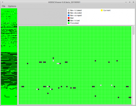

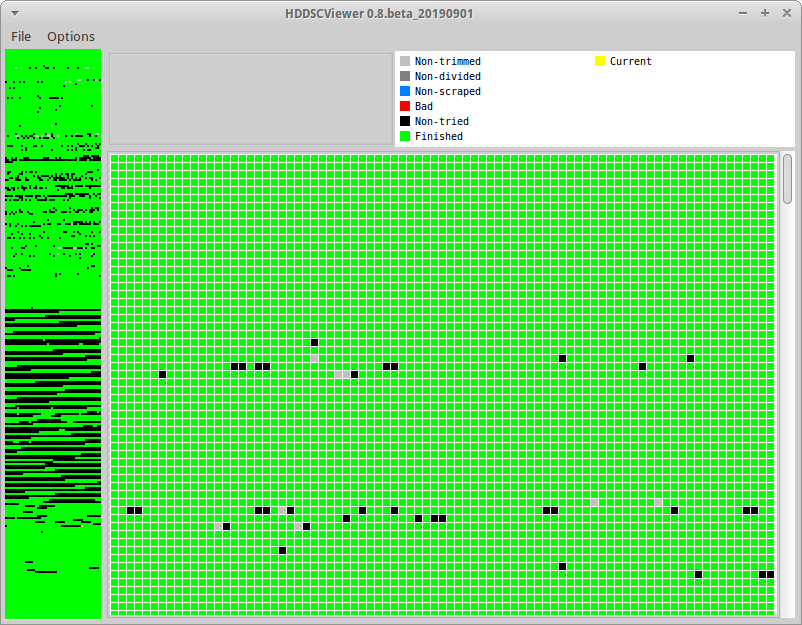

still not over , phase 3 , i was wondering .
is that possible to know how much data have been mist because of skips ?
https://imgur.com/CaccBOo
for example in my case 3181 skips , how can i convert that to actual data lost
Re: sudden death ?
January 21st, 2021, 19:14
The data that has not been read is the non-tried data. After phase 1-2 that is what was skipped. After phase 3 it will also be what was skipped.
Here is a screenshot from hddscviewer showing the pattern in the left column, from the 81% phase 2 log. It is much more than a bad spot, more like a dying head, maybe dirty or damaged, possibly from a spot of media damage, and also possibly causing more media damage. The only good news is that most of that skipped data might still be readable, at least as long as the drive survives. Most of the skips have been for slow reads. The bad news is that at some point in time you will likely reach a point where progress will slow down to a crawl. But it is unclear at this time how much data will be successfully read at that time. Maybe it will be good, maybe not.
